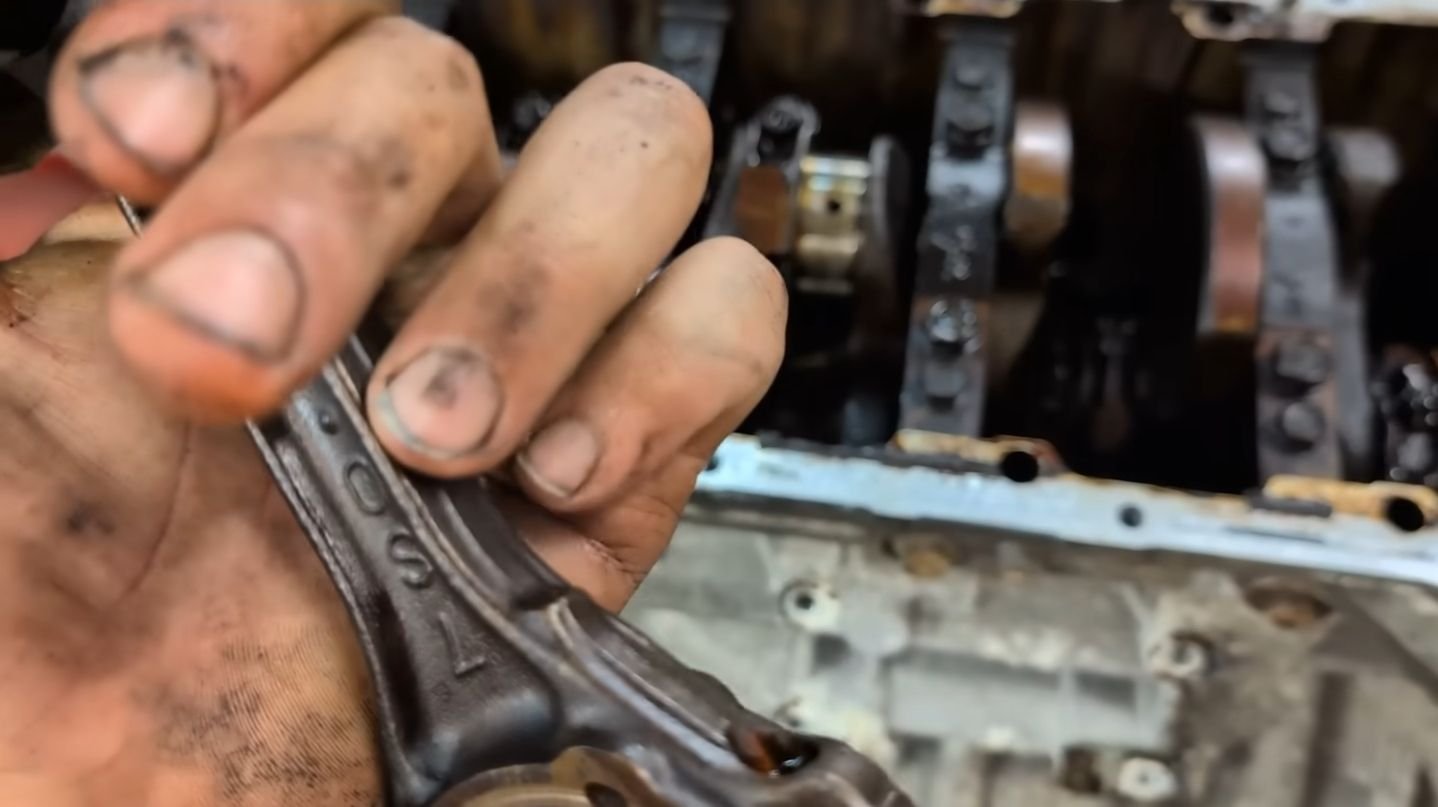

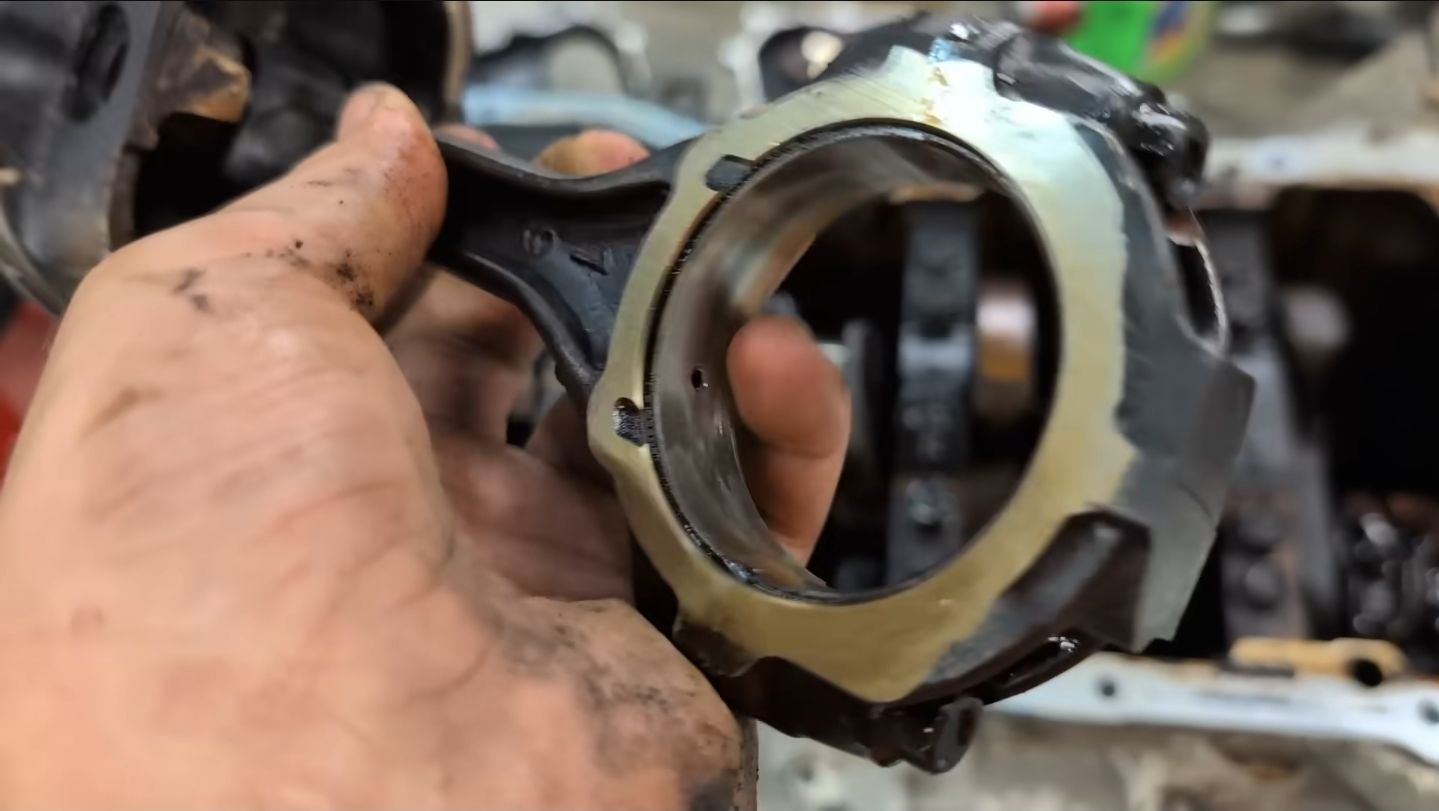

Originally Posted by Full Power
Do you have pictures- diagrams- bleed hole sizes in common use ?
Any OE using this tech ?
Nissan and the VK56. Pics courtesy of the Nivlac57 video about these engines. Look at the hole inside the rod. Then look at the boss by his pinky, that's where the oil comes out.
