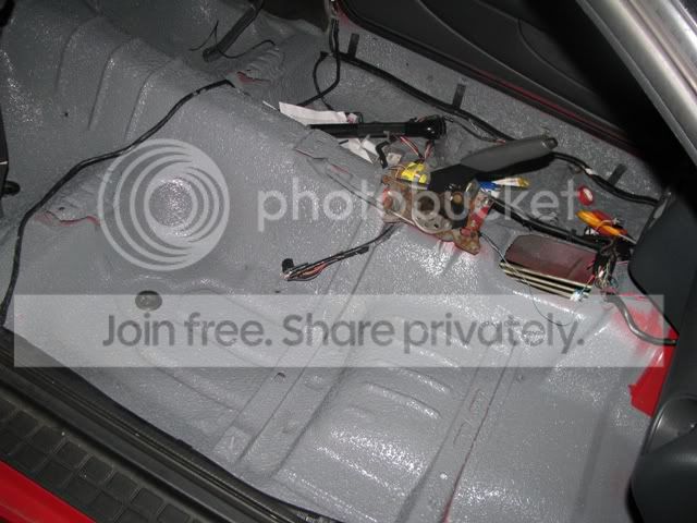

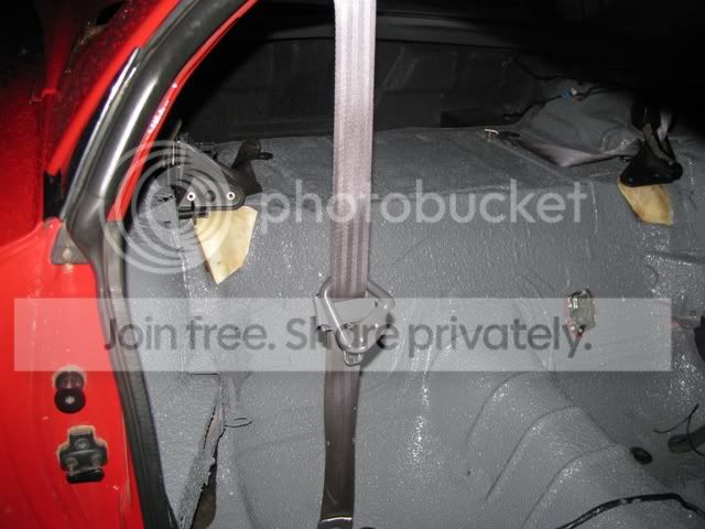

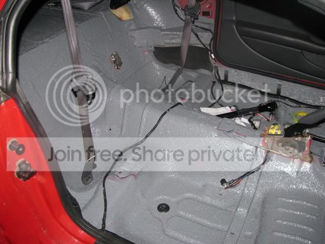

Hidden under my carpet! I sprayed some Al's Sound Deadener in the car. I was hoping to quiet down my interior a little bit so my son doesn't go deaf like I am.
Car was 83db at idle and a shade over 100db at WOT. We'll see what it is when I get it all back together.
I had a broken drivers seat and was swapping in a T56 anyway, so I figured I'd just yank the rest and spray this stuff in.
Unfortunately my window tint got torn in the process, but that just gives me an excuse to go darker.

I used about 2 gallons, probably about 13-14 lbs at most.

It wasn't hard at all. The main part was taking out the interior. Taping and masking was a little time consuming, but it was really easy. I got a bit of overspray, but it cleaned right off with some denatured alcohol.
I'll try and do a write-up tomorrow.

I sprayed it. I have some Second Skin matting in my shop I might use too, but I wanted to see how well this worked as is.
I have owned so many cars that had rusted floorboards from wet carpet that I wasn't about to put ANY matting down until I sprayed a rust-proofing liner in it. Especially an f-body that will eventually leak, no matter how well you take care of it!
One thing, when you reinstall the carpet, make sure you have help. I did it alone last night and the roughness of the deadener made it really tough to slide in the carpet.
