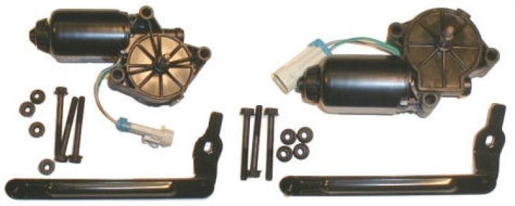

the headlight door shaft (thing that lifts up the headlight door when the motor turns) nut might be too tight. i overtightened mine once and this is exactly what it did. the headlight would work fine and then later it would do nothing. no grinding or anything, and if i turned the **** slightly it would work fine after that for a few cycles and then wouldn't work again. try loosening the nut slightly. for an LT1 headlight motor it's the nut in the very middle that attaches to the silver piece in the center with the odd shaped key hole that the shaft goes through. not sure on the LS1 style.
In this pic you can see the nut i'm referring to, its the one that goes on the center silver colored bolt that is attached to the motor itself, not one of the 3 nut/bolt combos that are on the outside.
