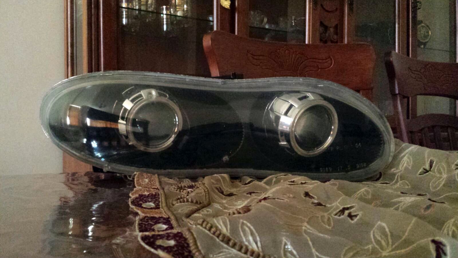

So i have had a pair of morimoto minis inside my housing and i love it but now i want more lol I have another set sitting around and i thought of slapping them in there. I modified my housing to accept both of them in the high/low housing. I am also going to wire a demon eye switch for when i want to go "ricey" lol....I have few questions, do I wire all of them on the low beams and wire the Bi-xenon feature with the high beam? or should i make them function independently? will I ever need high beams with quads anyway?
The housing is going to be all black with chrome shrouds, its gonna look like 4 eye ***** sitting in my headlights and red LEDs with a manual switch for the demon eyes.
still undecided on bulb color. am thinking 4 6k OR 2 6k and 2 yellow 3k? *see BMW photo below*
I started with a set of used headlights that looked like crap, it was sprayed with VHT.
opinions are welcomed what do you guys think?
i'leave you with the pics
Attached Thumbnails Quad projectors retrofit project-1.jpg   Quad projectors retrofit project-2.jpg   Quad projectors retrofit project-3.jpg   Quad projectors retrofit project-3zezo.jpg   Quad projectors retrofit project-4.jpg
Quad projectors retrofit project-5.jpg   Quad projectors retrofit project-6.jpg

yep, thats what i thought at first but again more light in the same spot i have now would be awesome!
problem with having 2 sets aimed differently is that it will give off 2 parallel cut off lines not to mention how PITA it is to have 2 different projectors level in the high/low beam housing :/

and finally done with painting the housing and polishing the lenses just waiting for the halos to arrive. I actually LOVE the way they look! very aggressive. cant wait to put them on the car
