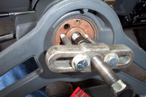

I have the same adapter on my car. I actually pulled it and reinstalled it twice last night to change the lock cylinder. (First time I installed cylinder backwards) you need a steering wheel puller specifically though. Has various bolts to thread into the two threaded holes next to the center stud then a large bolt with a holder for the two bolts threaded into the adapter.
Like this.
If you can get the adapter off then you may be able to save the column by running a die around the center stud and fixing it.

I used a 3 jawed puller and a club foot puller (same thing as what you pictured but with 2 more ears to mount stuff too) the problem I ran into with it was all the bolts that fit needed washers to make them usefual and the washers just kept pulling through the puller. I didnt have anything with a big enough head on it with the right thread pitch to work.....so I was using some stainless allen head screws with 2-3 stacks of washers. sheared the washers everytime!
course now its mangled to the point I cant use that puller unless I pound the mangled section down get it to set flat. That said though the upper shaft mount is mangled to the point I dont know if I could mount it back on once its removed
I found an old thread about dissassembling the steering column but its all done from the top down (everything under the adapter) so I really dont have an option but to swap out the column. What kind of issues would I run into swapping in a different steering column and key?

went and got a puller like the one posted above last night and tried it.......sheered the bolts the first time, and then pulled the thread out of the adpater the second time.

Well sucks. Something definitely went wrong upon install then. It's just a press fit into the splined shaft. Shouldn't be destroying bolts upon removal. Lol
Unfortunately you definitely are gonna have to change the column. As long as vats is taken care of you shouldn't have any other issues changing it. Other than it biting a pita to do. Good luck.
