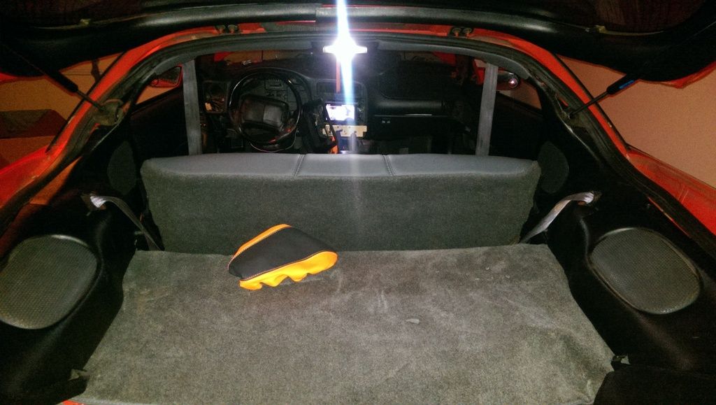

Okay so more progress, and ideas for the carpet issue.
The interior has mostly taken shape with the exception of the dashboard components, upper dash and I haven't installed the front seats (purposely to reserve the amount of room I have to work with.) I installed the LED's in the dome light and the courtesy lights in the rear view mirror. I like them MUCH better than stock. So much brighter yet also more refined. I will need to note..for those looking to do this, it wasn't a direct fit. The LED's from superbrightled's.com 's connectors were smaller than the stock bulb so I had to improvise. I ended up soldering larger metal caps onto the connector ends of the bulbs to make them fit properly. So far it seems to be doing fine. Hope it remains that way. Installed the replacement headliner, only to find it too has the same issue where it sags slightly in the front, although not as bad as the previous headliner. I'm not going to worry about it. Nothing is perfect.

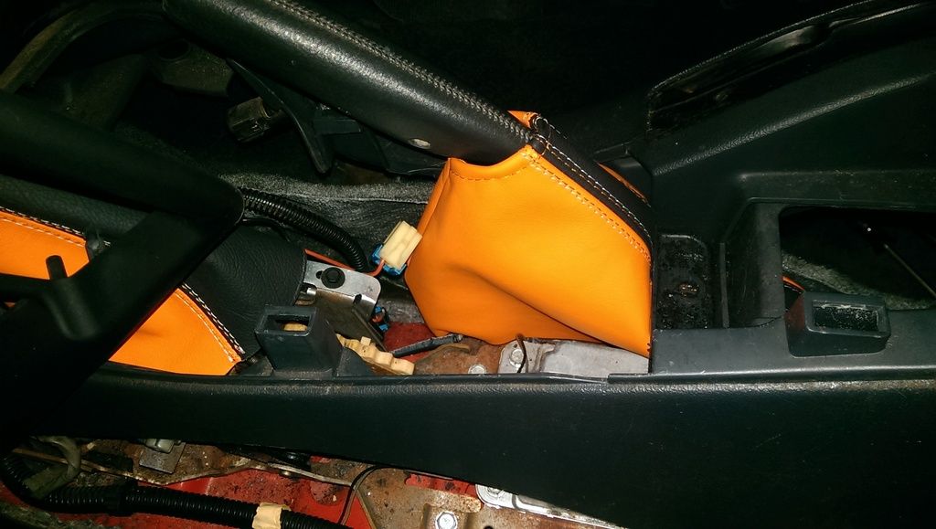

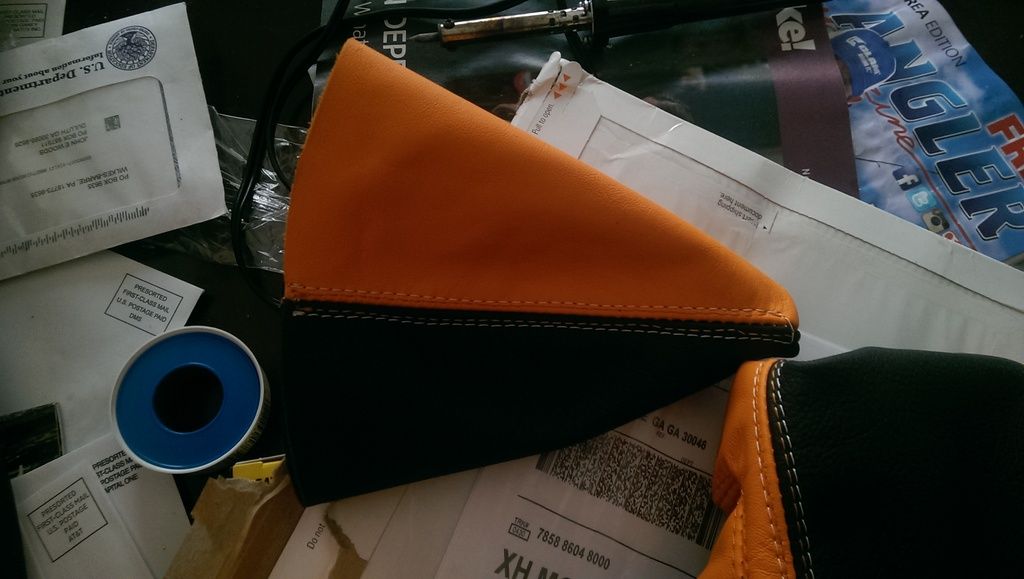

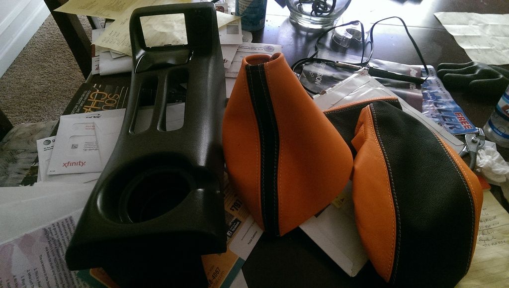

-- Received my leather material for the center console door, the parking brake and the shifter.

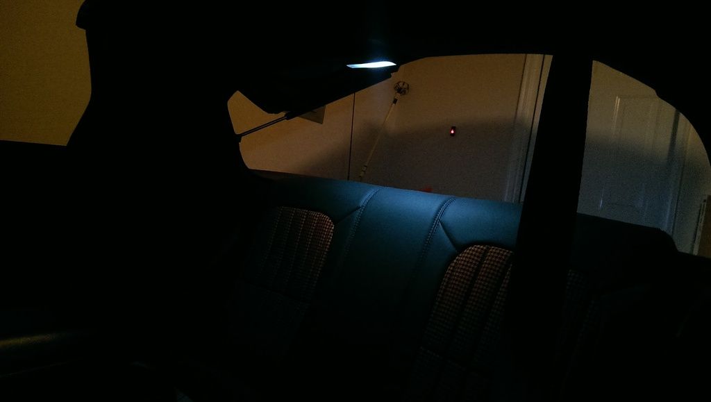

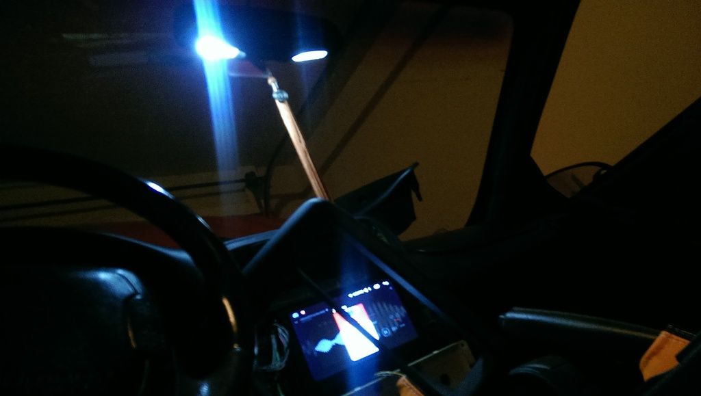

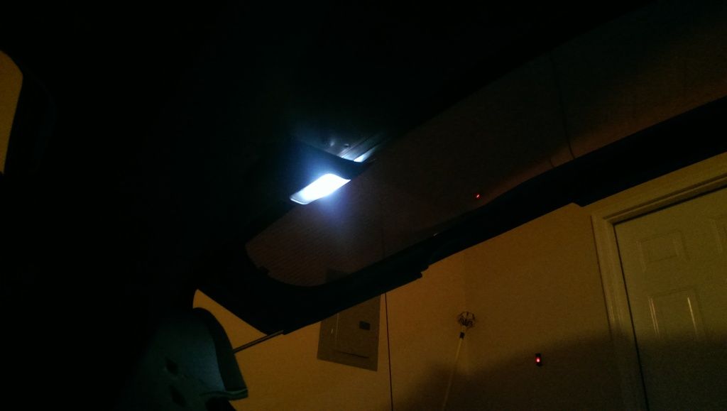

-- Installed LED's in the courtesy lights of the rear view mirror
-- Installed replacement headliner
-- All trim except the A-Arms and center console has been re-installed.
-- Installed my USB Power outlet / Cigarette lighter replacement.

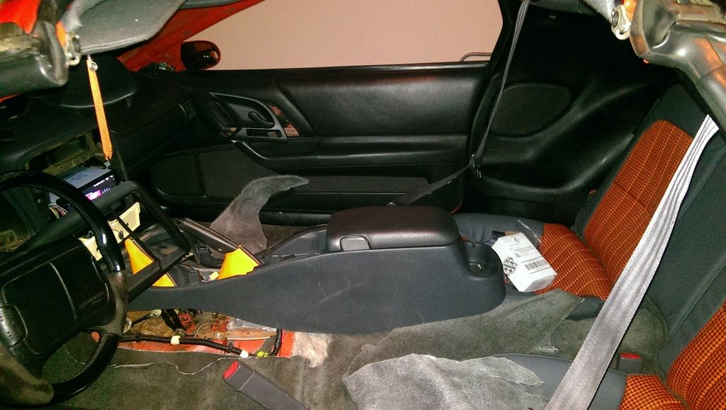

Issue #1 - The carpet error.
I've been thinking long and hard as to how I'm going to correct this and wanted to get some final opinions (and instructions) before I begin. I cut the carpet near the transmission tunnel / center console too short so the body of the car will be exposed. I have several options to fix this...
#1 Leather wrap the center console and a excess layer "skirt" down the driver and passenger sides so it will cover the body and meet the carpet using a binded and orange stitches, use large black tacs to attach the leather and carpet together
#2 Black Quilted leather sheet with a orange stitched binded edge at the carpet, sewed or stapled to the carpet and tucked UNDER the center console (taking the same route as the carpet would have)
#3 Re-use my excess carpet, staple down both ends of carpet to extend it, have a <black-orange-black> leather strip with a beveled orange/white stitching ontop of the bind between the two carpet strips either tac'd with back tacs or sewed together.
#4 Replace the carpet, have a professional do it, eat the cost, get charcoal grey color.. atleast it will all be done right.

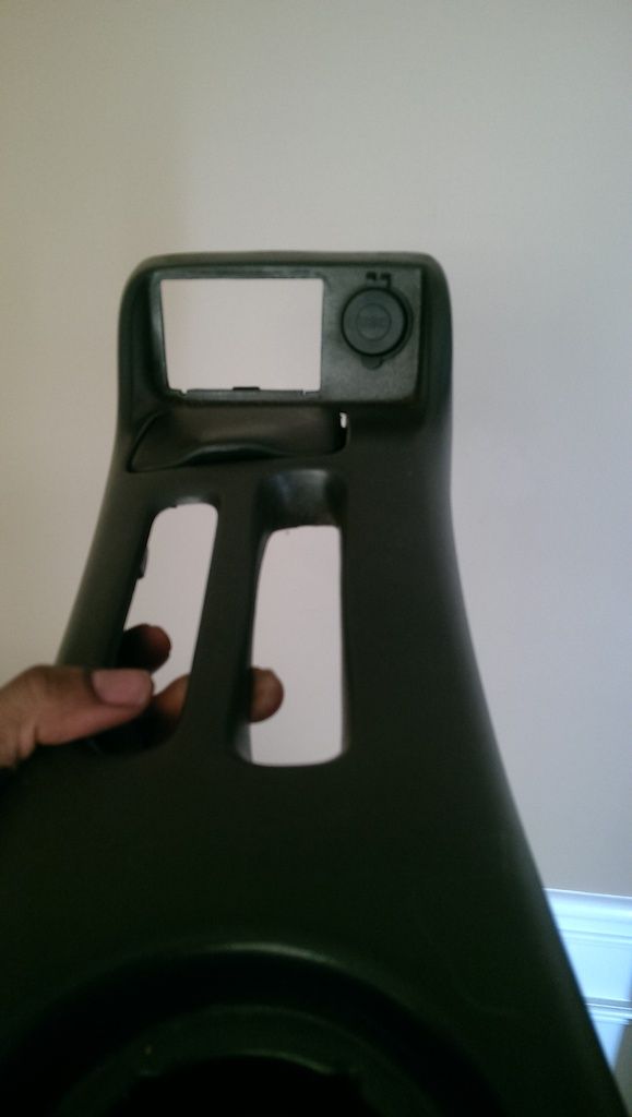

Sent my center console off to have a USB Hub installed in it (so I can connect peripherals to my HU)... I'm preparing to purchase parts for the steering wheel upgrade. Some things are on my mind about this though. It is possible to get the radio controls to work on the C6 wheel but since my car didn't come with radio controls, it's going to take additional wiring.

So I received my new lower center console today and its a much better sight than my stock one, no issues with the cup holder. I am "trying" to install my leather parking brake boot. I removed the old one but I had to brake the plastic tabs on the left side to remove it. I just want to be precise about the installation of the new one. I'm "thinking" of using just alittle bit of glue.

Oh, I'd also been meaning to post this as well. Not an LS, but just a preview of how the USB ports look, in this case on a PT Cruiser:
