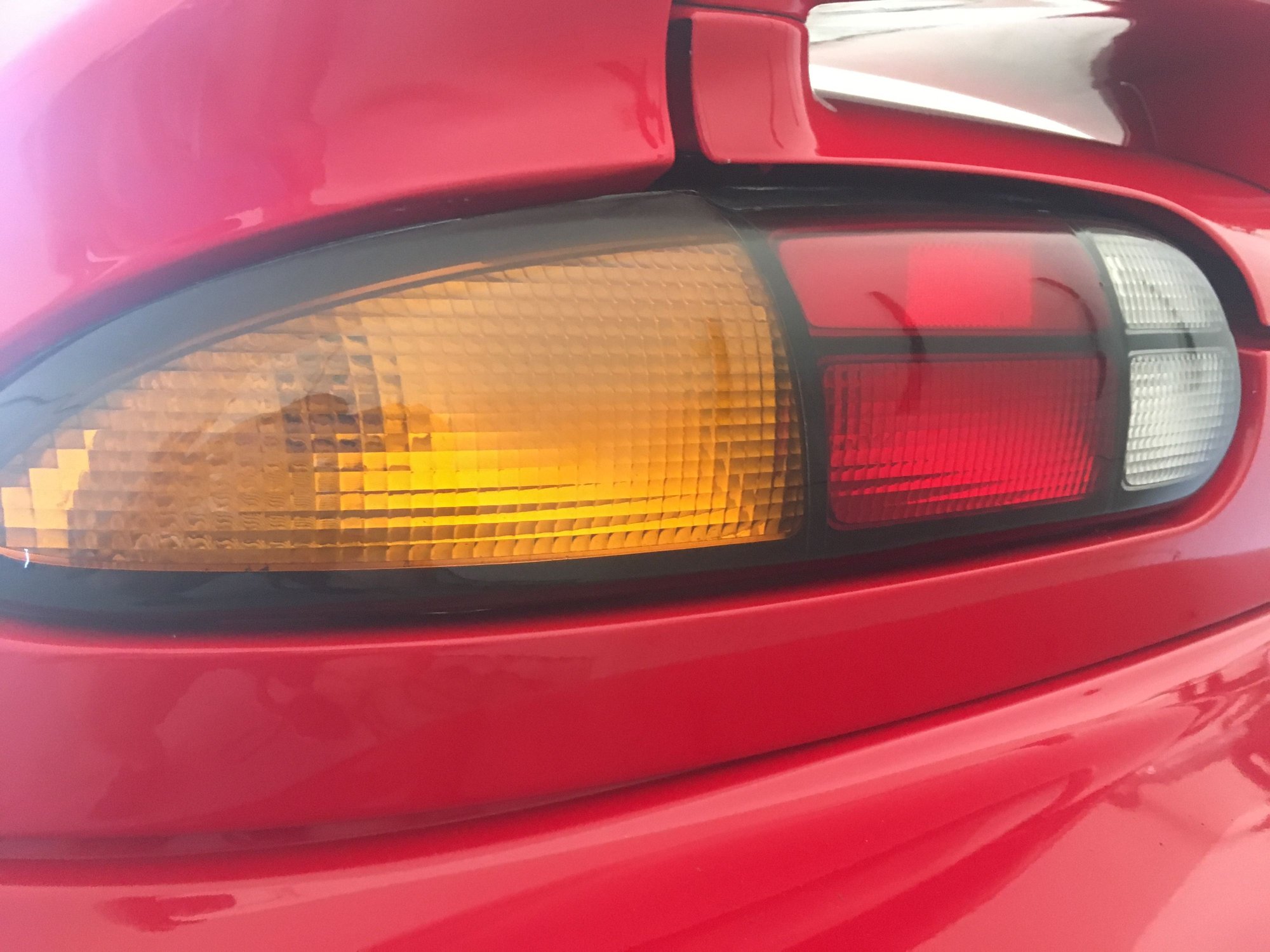

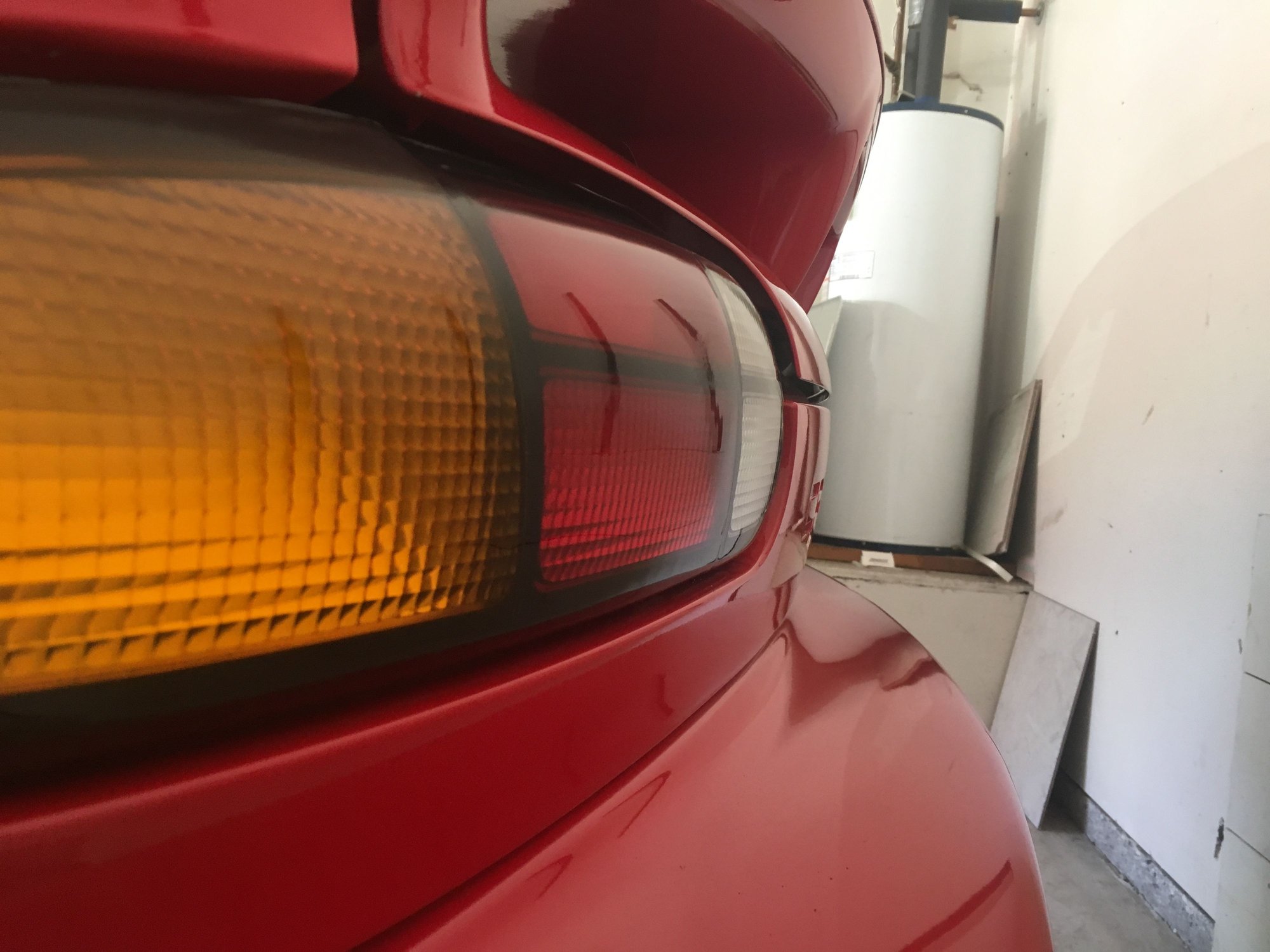

Here's how mine turned out. Sorry for the bad angle, car wasn't running and backed into the garage.
Here's how one looked with letters compared to the one without.

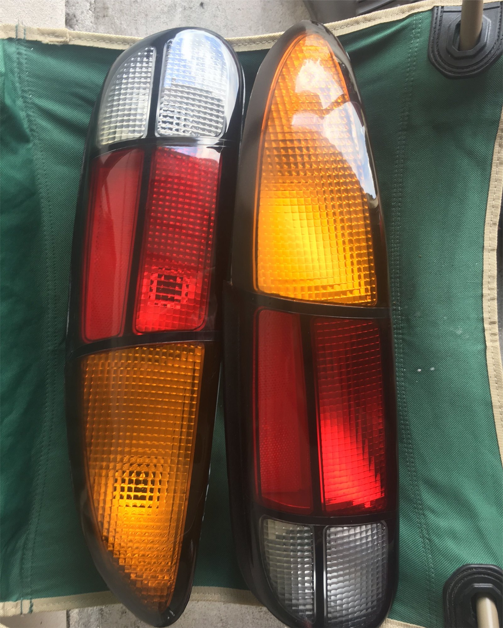

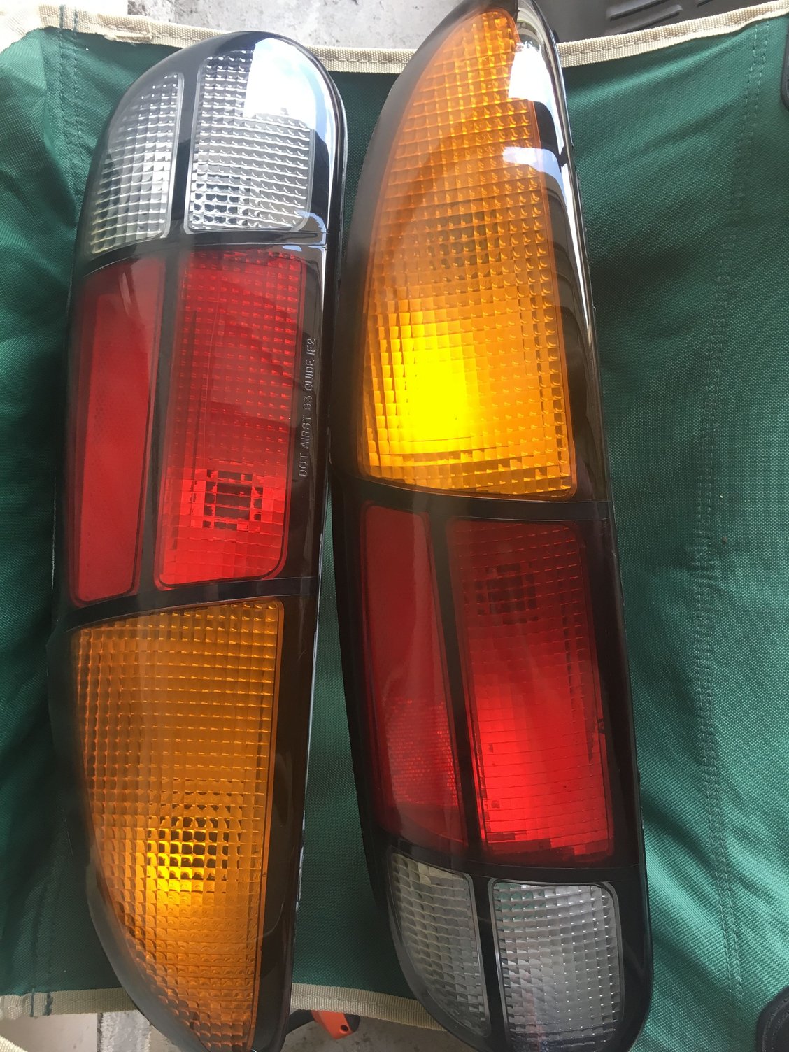

Thanks for the pics! Looks much better with no letters. My buddy sanded my letters off for me at work. I ended up sanded the whole light down to get rid of some imperfections. You can see this weird texture in the second picture. I removed about 98% of it and looks much better now
