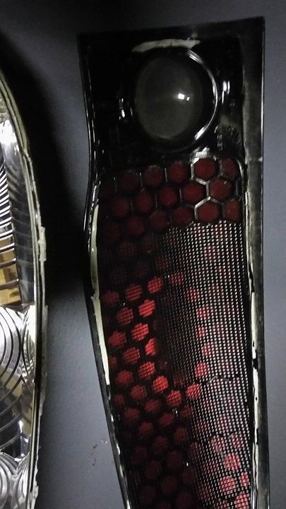

1- difference between the sealant used on the grids vs the honeycomb, grids was a black sealant, and the honeycomb was a silver kind, note, silver was much harder to remove than the black.

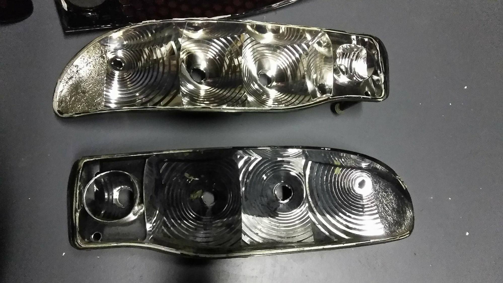

2- Ive always seen more than a few honeycomb tails that were darker than the other, due to moisture getting in and ruining the chrome, heres a good one(top) vs not so good(bottom).

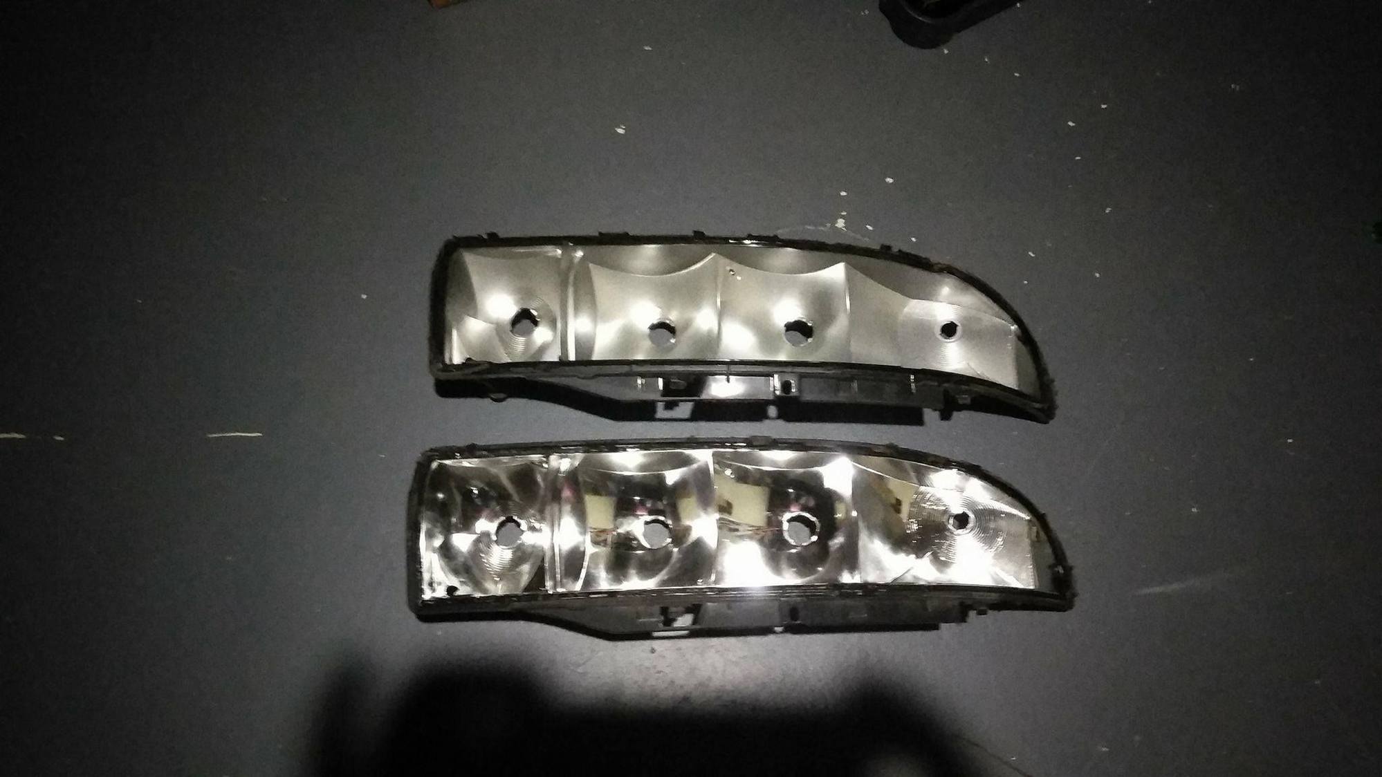

3- There are some grid tails where the inside of the tails is bright silver(top) and some are chrome(bottom), don't know why they would be different.
