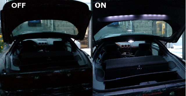

Got the light out of a convertible 98+ Camaro. There’s already a spot in the trunk behind the carpet to mount it just need to cut the carpet in that area. Ran the wires behind the carpet on the driver side and tapped into the wires that come from the roof light and run down near the speaker behind the driver seat.

Cool. Can you take pic further back so we can see where that is? That close-up makes it hard to tell.
Here is my attempt at trunk lighting a while back.
https://ls1tech.com/forums/appearanc...round-2-a.html

Awesome, thanks. I'm thinking of adding one there too.

Looking at the parts manual, it appears to list the following parts for this lamp. Did you buy all of this or did you just buy the lamp and improvise?
Shield - 10237021 x 1
Lamp - 19253755 x 2 or 3523031 x 1
Connector - 12125650 x 2
Retainer - 10121502 x 2
Old Nov 26, 2017 | 01:36 PM
98MNBZ28's Avatar
iTrader: (21)
Joined: Feb 2007
Posts: 848
From: Gainesville,FL/Riverdale, GA
I got it out of a convertible in a junk yard.
