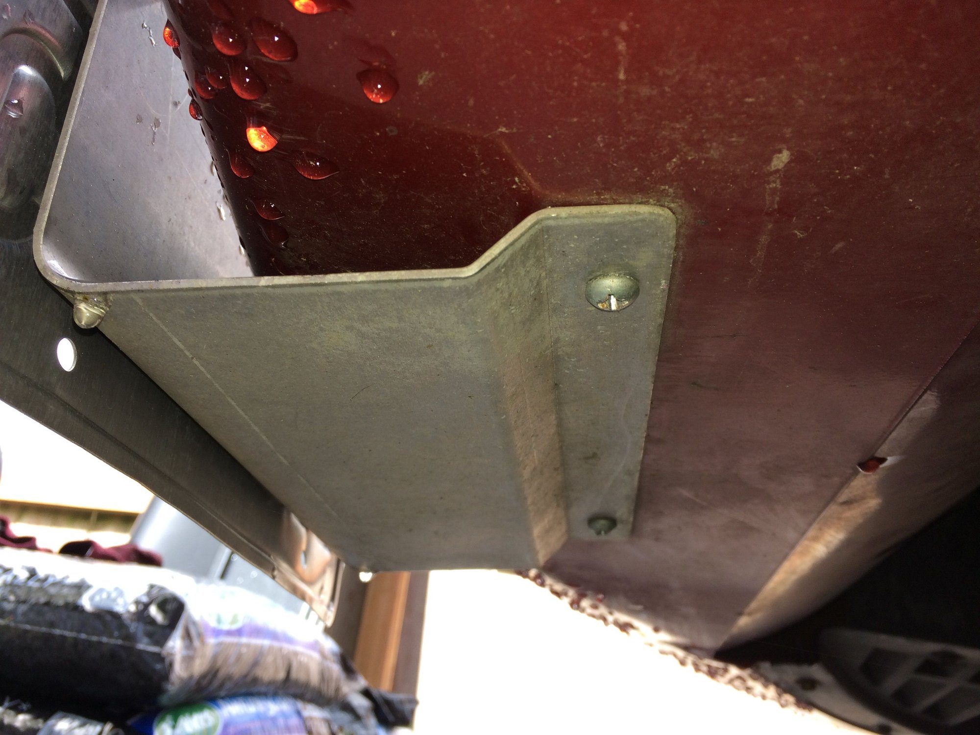

Under front bumper
The bracket actually attaches to the underside of the bumper not the grill. Here’s some pictures.

just un bolt it and be done. nothing rare about it, you can still buy them from SLP. I put one on my car cause I would rather drill under the bumper where you cant see than the front.

Well I tried to unscrew the 2 on the bottom of the bumper they won’t budge. Do I need to remove the grill to remove it?

there are nuts on the other sides of the screw holding them on...you need to undo the bottom of your bumper so you can get to them. It's real easy takes like 20 mins
