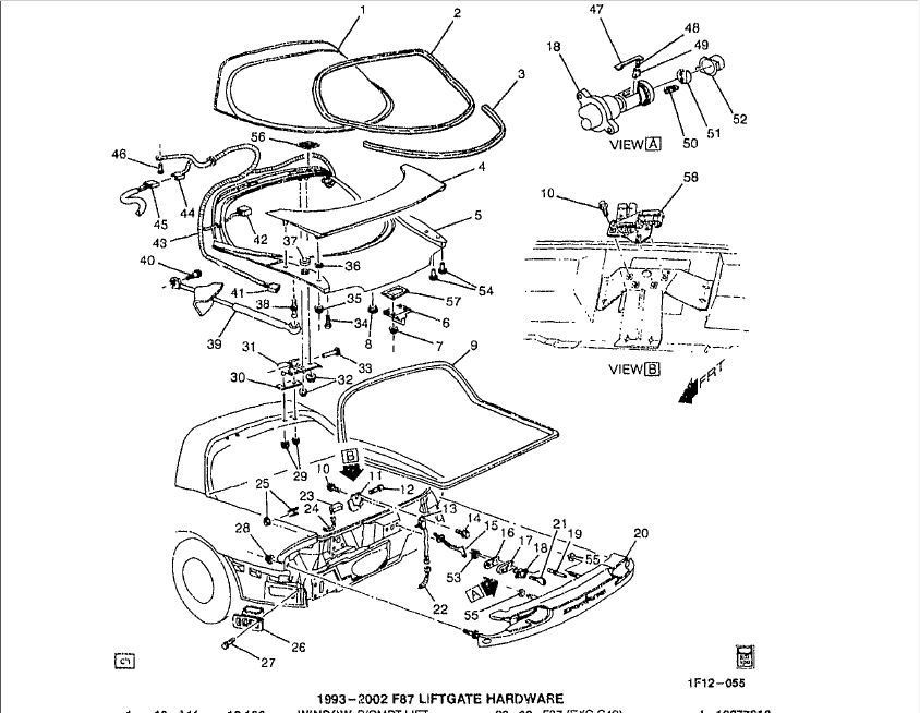

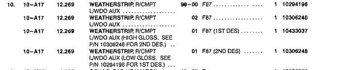

I did notice in the parts catalog the differentiation between the model years. I believe this is the correct diagram; what throws me off is the description of 'weatherstrip'.
But I also found the following; I'm not sure which part(s) I'm attempting to replace. I presume 9 is under the liftgate, and 2 is the part I want, but I don't recognize 3. What's the different between 10 above and the similar parts below?

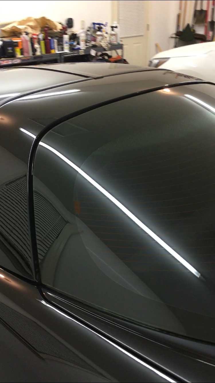

I just took mine off all the way around when it started peeling and oozing. I cleaned the glass and left it off, I think it looks better without it.

Any chance you can post some pictures of how it looks without the molding? Any problems with water dripping inside the carpeted rear hatch area when there's pooled water on the hatch and you lift it up?

My car is a garage queen and doesn’t get wet, but I think the only functional purpose of that trim is to protect the glass edge.
Thanks for the photos, that sets my mind at ease. Still trying to setup the job; I'm being told R&R'ing the urethane will destroy the molding. $200 labor, $16 for the urethane, I don't consider that cost to be excessive. If I ever come across another new rear molding, I'll still buy it and re-evaluate options for getting it installed.
