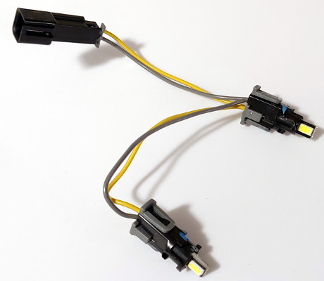

I'm not sure about the rest, but for the HVAC on my Firebird, I used these side-only 74 / T5 LEDs. I got the kind with LEDs only on the side since any front ones would face black plastic and would be a waste or possibly make a strange glow spot. Removing the original small glass bulbs was difficult. They wouldn't pull out. I had to break them and pull out the pieces with pliers.
Amazon Amazon
https://www.fadingarrow.com/images/F...LED%20Bulb.jpg
The HVAC bulbs are on their own mini-harness.
https://www.fadingarrow.com/images/F...%20Harness.jpg
These LED bulbs are polarity sensitive. So if they don't work in one direction, flip them.

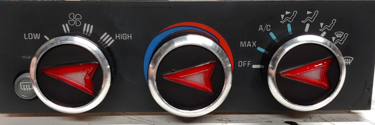

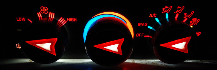

I have custom ***** so it isn't a fair test.
https://ls1tech.com/forums/appearanc...vac-*****.html
(These pics are on my bench and not installed on the car.)
https://www.fadingarrow.com/images/F...ed%20Knobs.jpg
https://www.fadingarrow.com/images/F...%20-%20Lit.jpg

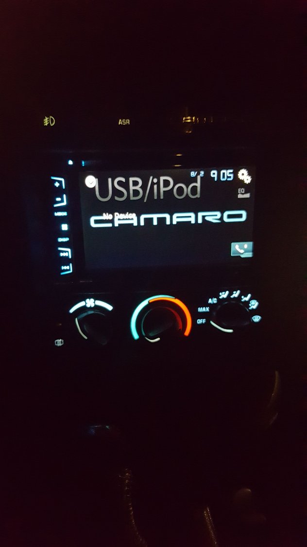

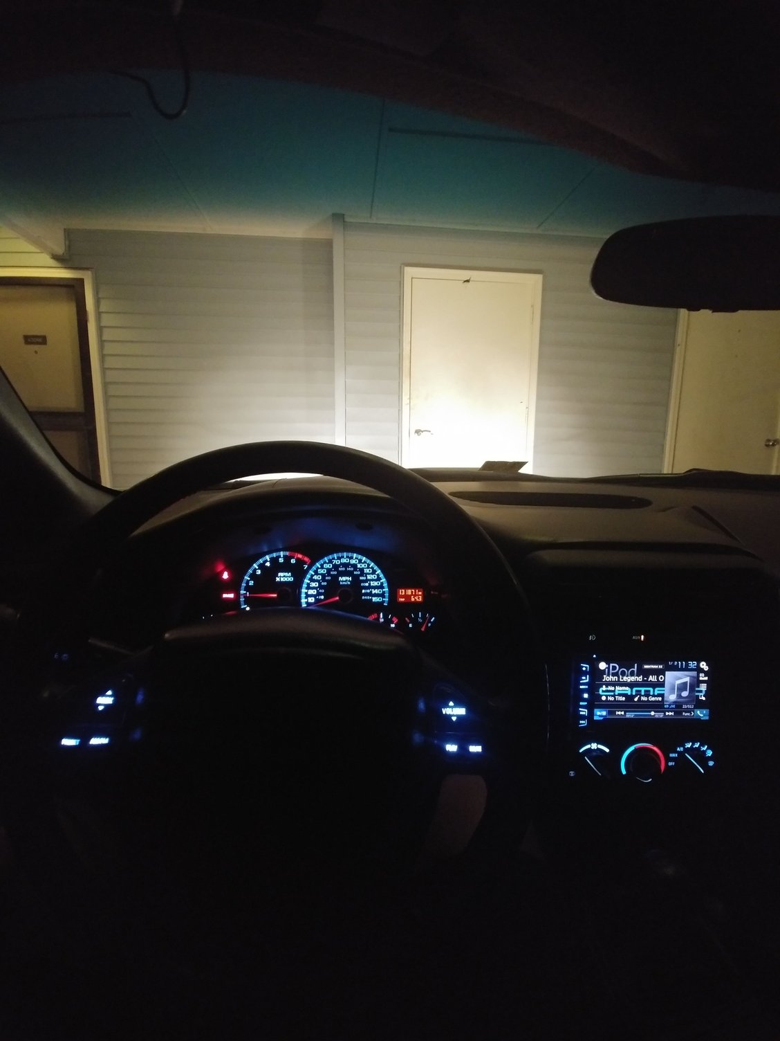

Did mine years ago and got them from superbrightleds. By the way i ended up putting the stock bulbs back in the door panel because once i put the door panels back on one side was a lot brighter then the other for some reason even though outside the panel they were both really bright. I don't have a pic with the headlight switch in it but it's the same color as everything else.
