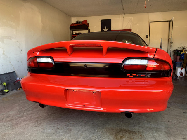

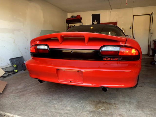

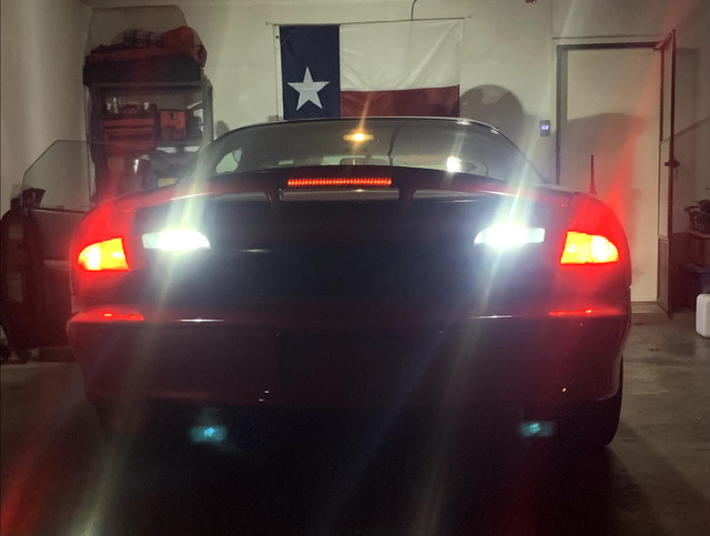

Pics and vid.
Night shots later tonight.
Red Ambers (still need some clear)
Reverse lights
Night pics:
