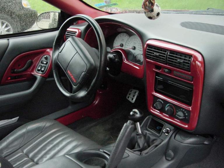

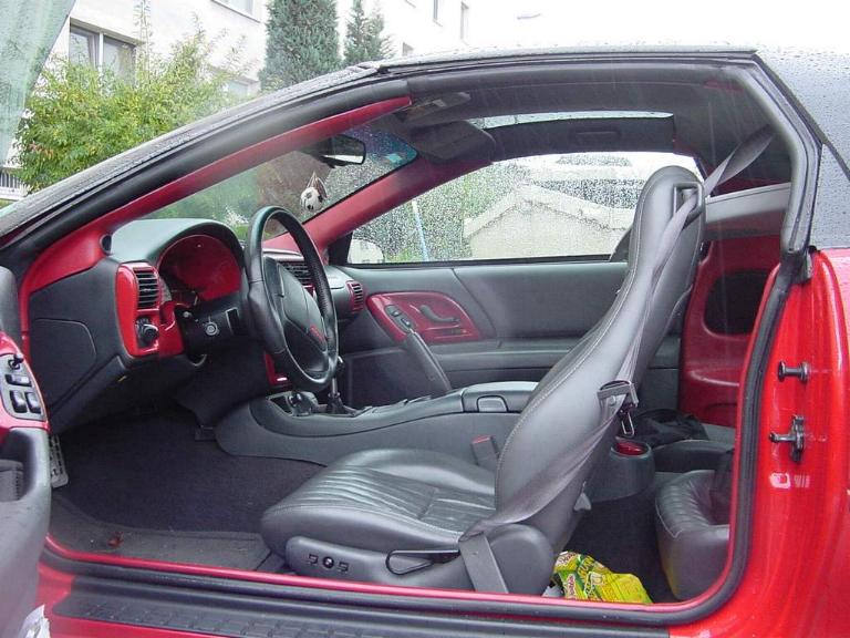

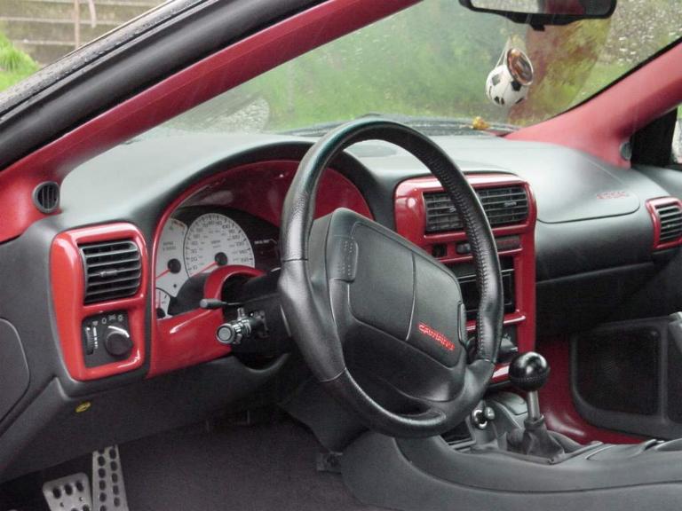

I did mine, but seriously regretted it soon thereafter. If you can get a cheap replacement set, to experiment, go for it. Otherwise, don't mess with it. Here are a few pics of mine. It turned out great, but I got very sick of it after a couple days.

I recently sent those same pieces off to get coated in real red carbon fiber. Now that should look badass. You should think about something like that.
