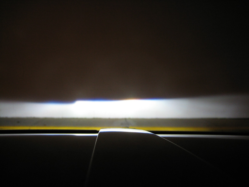

Here is what mine look like:
(Hella 90mm H9 projectors and H9 HID kit)
http://www.fadingarrow.com/images/headlightshroud02.jpg
http://www.fadingarrow.com/images/43...es-Preview.jpg
(The pic is a bit blurry, but you get the idea. Check out the Lighting FAQ for more pictures ---- notice how they compare to the stock high beam )
If I were to do it again, I'd take a second look at the FX and TSX projectors and possibly use one of them instead.
