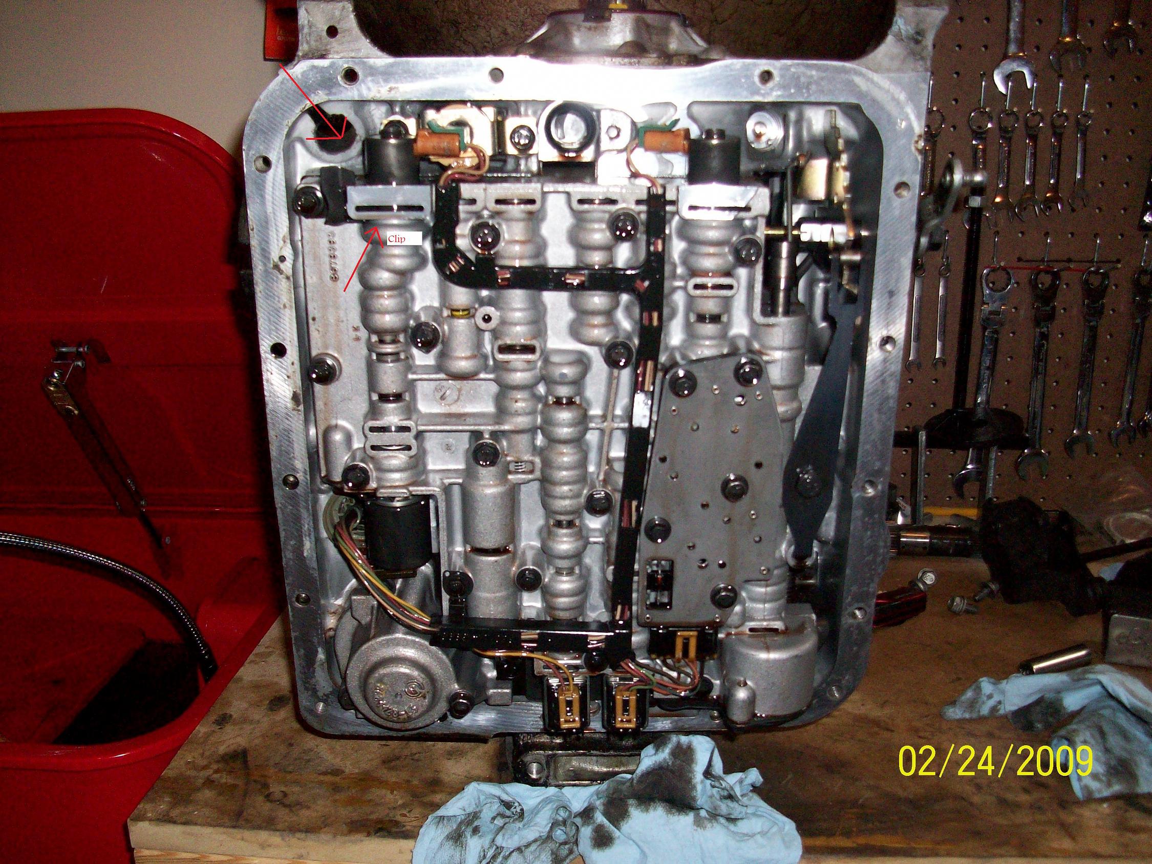

Is it the original trans? From what I understand PWM didn't start till late 95. But yes you can change it by dropping the pan. No special tools required, just a pick to pull the clip retaining it. I'm sure somebody on here will have a pic up by the time I dig one up.

Professionals feel free to correct me if I'm wrong.
Yes that is a PWM solenoid. You should not find one on a 94 car though.
I did however have a customer who swore and maybe there were some early pop ups that he had PWM in a 94 truck so I would guess anythings possible, But as a Rule 94 units do not have PWM.
