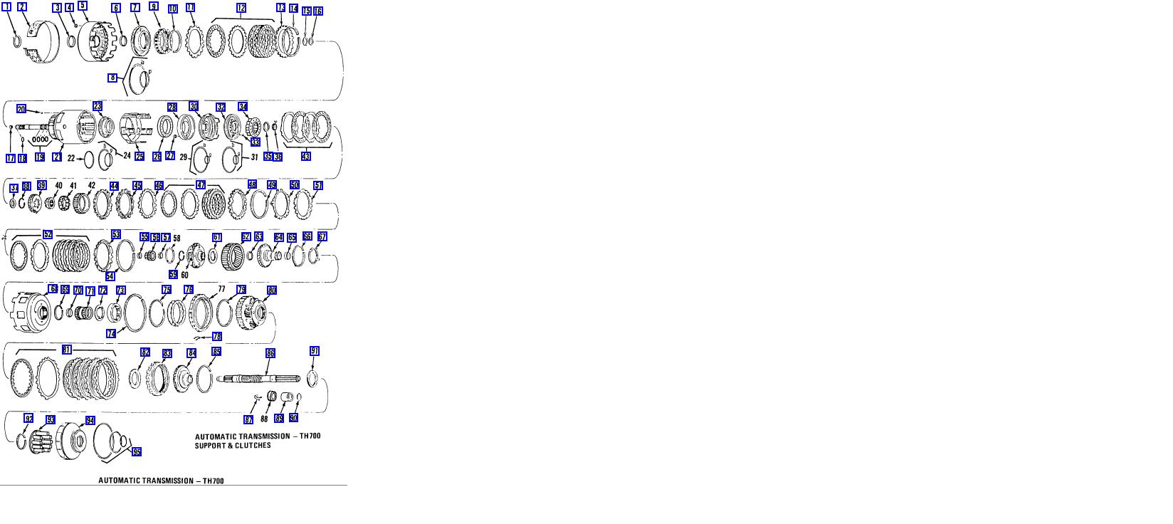

The problem is that sunshell without a doubt. I love GM and i work at a chevy dealer and i cant tell how many times i see them go out. The splines strip out. There a massive piece of ****. Any trans shop should have at least two in stock. There that big of a problem. Its number 68 in the picture.
