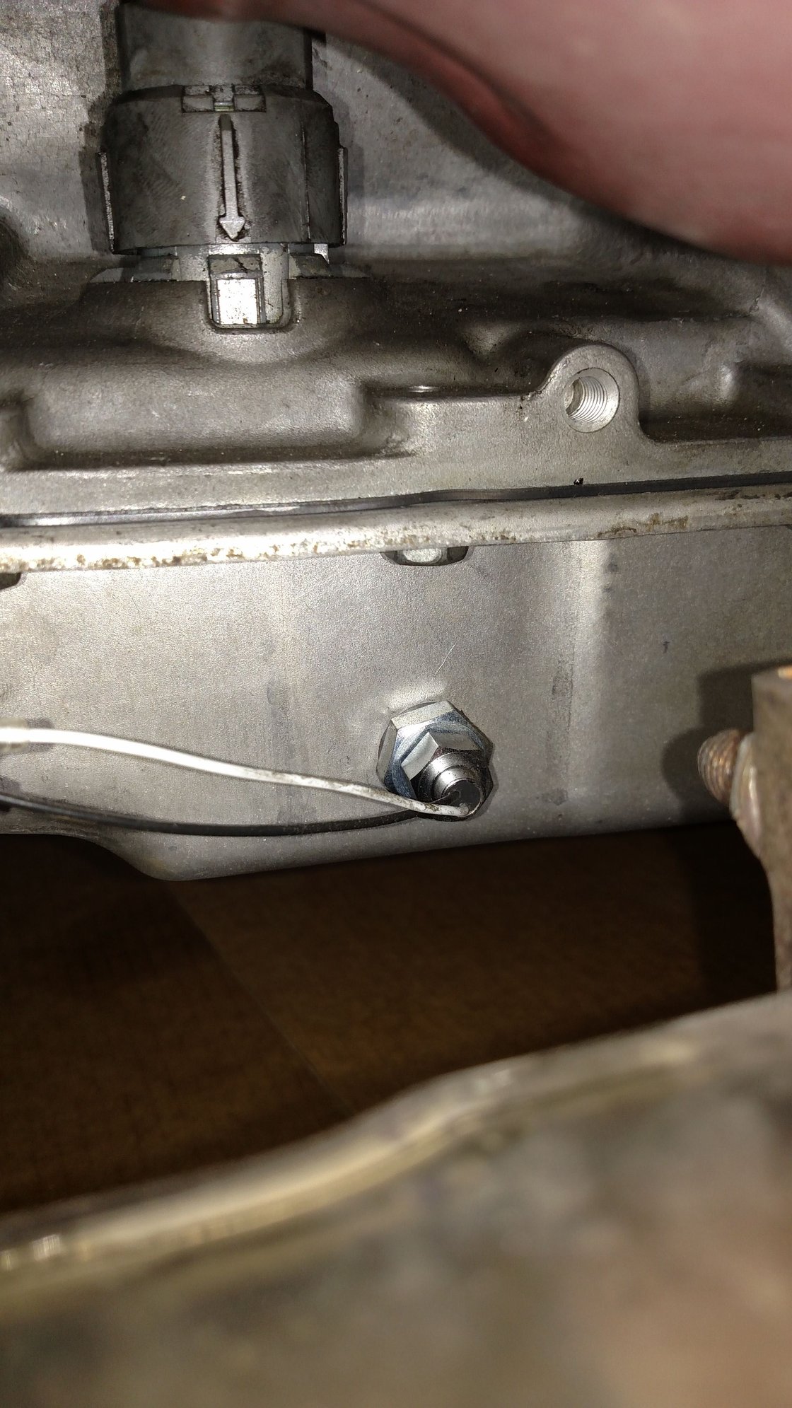

Where are you guys welding you trans pan bungs to plug in my gauge probe? I have a new truck pan and wanted to weld it in before i get my trans back from the shop

Hopefully this picture helps. Hard to get a picture when ya can't see where you're aiming lol

Cool! Thanks man, just trying to get a general idea

This is what I did..... If ya want pictures of something let me know.
Underneath where the rear passenger floor is there is a rubber grommet. I put my sending unit as seen in the pictures on the passenger side of the pan. Ran the wire up threw the grommet. Then underneath the passenger seat there is a slit in the carpet from the factory for lumbar where you can pull the wire out from. Then from there I ran it under the counsel and put my temp gauge kinda down by the gas pedal and got my 12v ignition power source from the gauge fuse using a fuse tap.

On ok, yeah i might try routing it similarly, except i have a dual A pillar gauge pod already so i would use that, i will be getting the AEM eugo kit, i have the wideband already mounted there and love it
