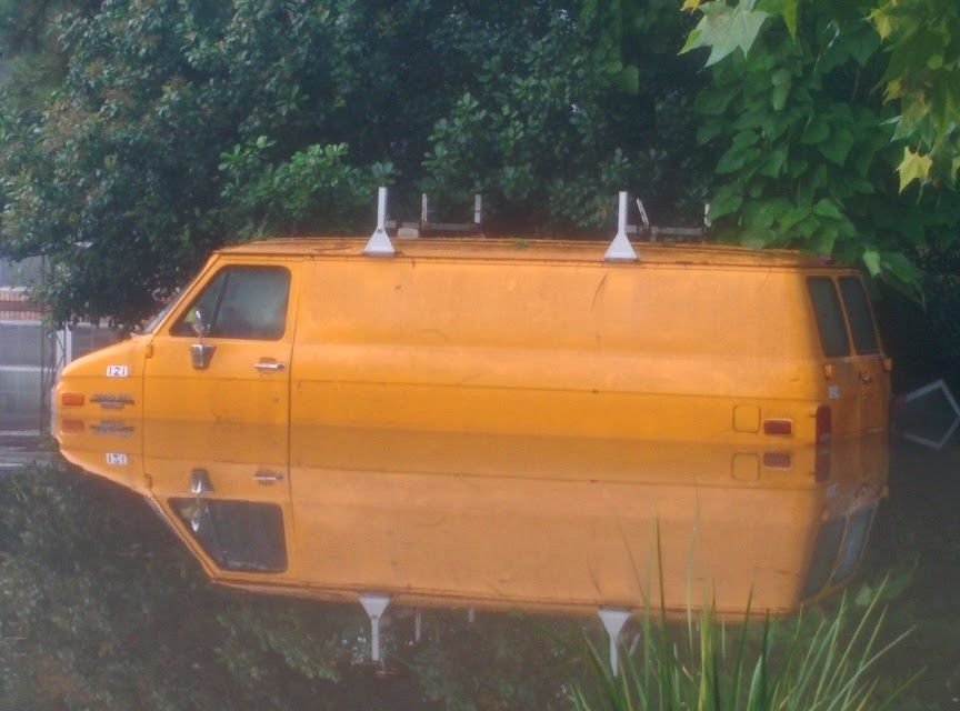

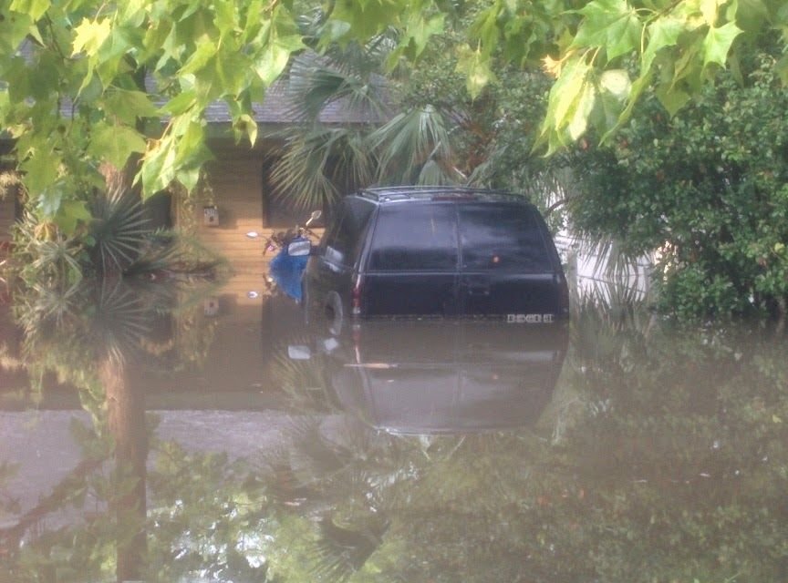

Maybe I should just have the '95 rebuilt? Again...
It was flooded in the recent floods here with a fairly fresh rebuild on it. My Tahoe had NO appreciation for the high water and it hardly got 1/2 the water. The transmission only lasted in it for ~2000 miles.
Since it's a piece of crap work van (G30), I don't want to spend much $'s on it, but it needs to go reliably.
By the time I have it pulled and obtain a decent replacement, I don't think I'll be too far off of a fresh rebuild, will I?
Thanks!
-Kyle

I heard you guys got it pretty bad down there..... I would have it rebuilt, Water Delaminates Frictions.

Yeah.
After the Tahoe Transmission only lasted ~2k miles, I didn't bother to start the van. I have a '99 transmission located from another member here, but now it seems like I should just have it rebuilt. The TCC Solenoid is $35 on RockAuto....
Plus, all the swapping stuff around doesn't get done for free. And I'm not doing it.
Thanks,
-Kyle
