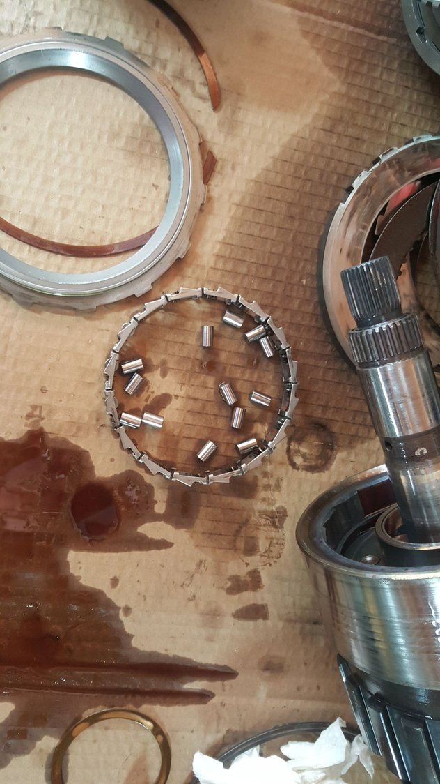

When you pull your transmission, see if your roller clutch looks like this.
Thats actually very common for the rollers to fall out like that on a 400 or 4L80E. You just take it out carefully as an assembly or put the rollers back in when they fall out like that.
I used to use original only early 60's 36 element sprags there with the matching center support and gear set when they could be found. Now the easy (only) option is aftermarket.
Nothing in that picture looks broken.

Posts: 3,012
Likes: 48
The clutch was trash. ALL of the rollers fell out as I removed it.... that shouldn't happen. All of the springs were flattened, could i have rigged it..... maybe. But for the $15 for a new one, that's what i elected to do.
That wasn't a major blow up, if it was you would have needed a center support and the gear set because the ramps would be all tore up. But thats besides the point. A 4L60E doesn't have exactly that in it.
