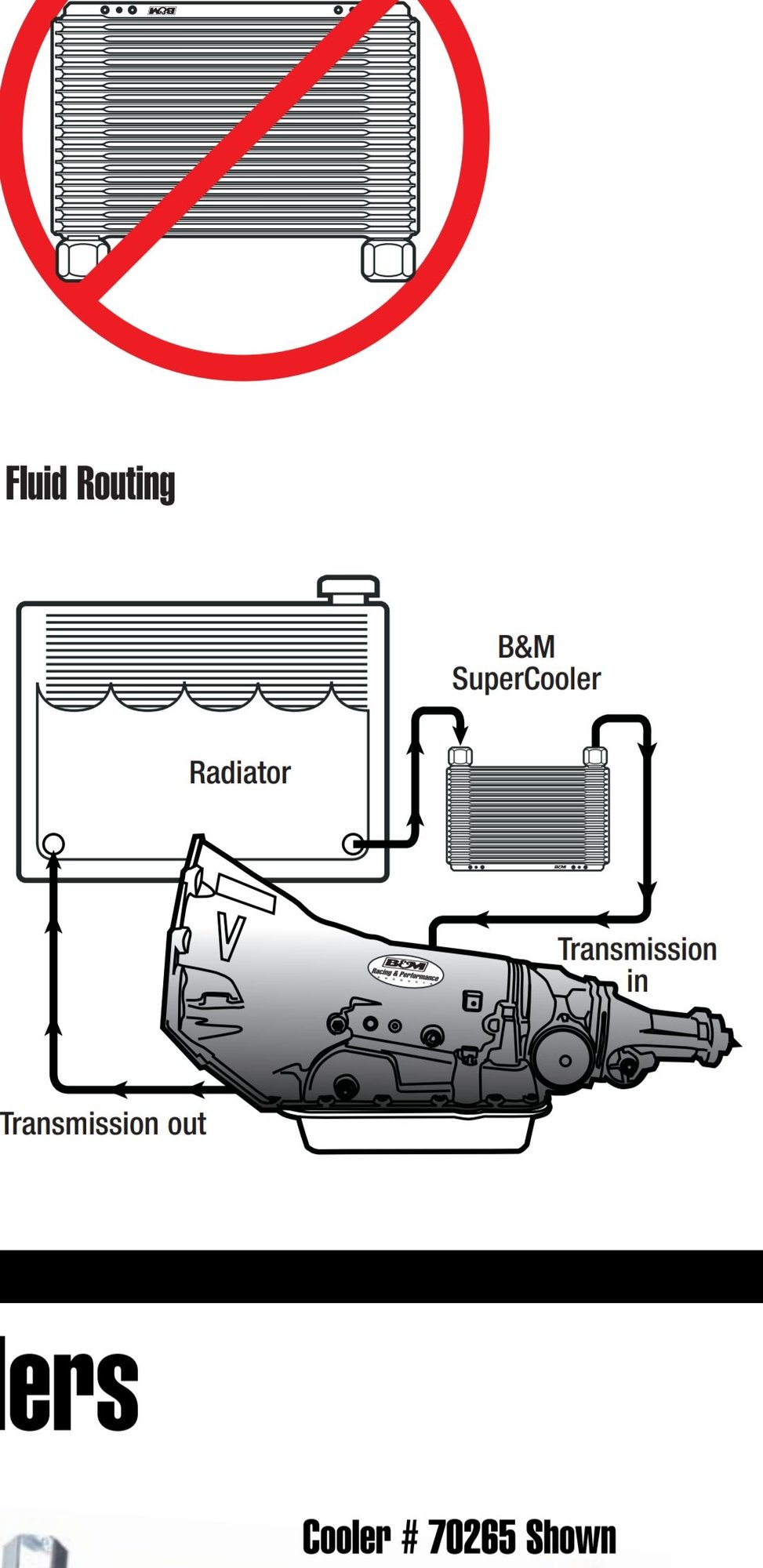

Is this how you have yours routed? Except on f bodys it would be top and bottom on the passenger side of the radiator.

I have the connections right but the cooler is sideways with the connections facing the right headlight
