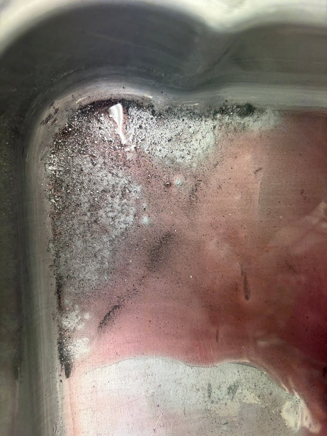

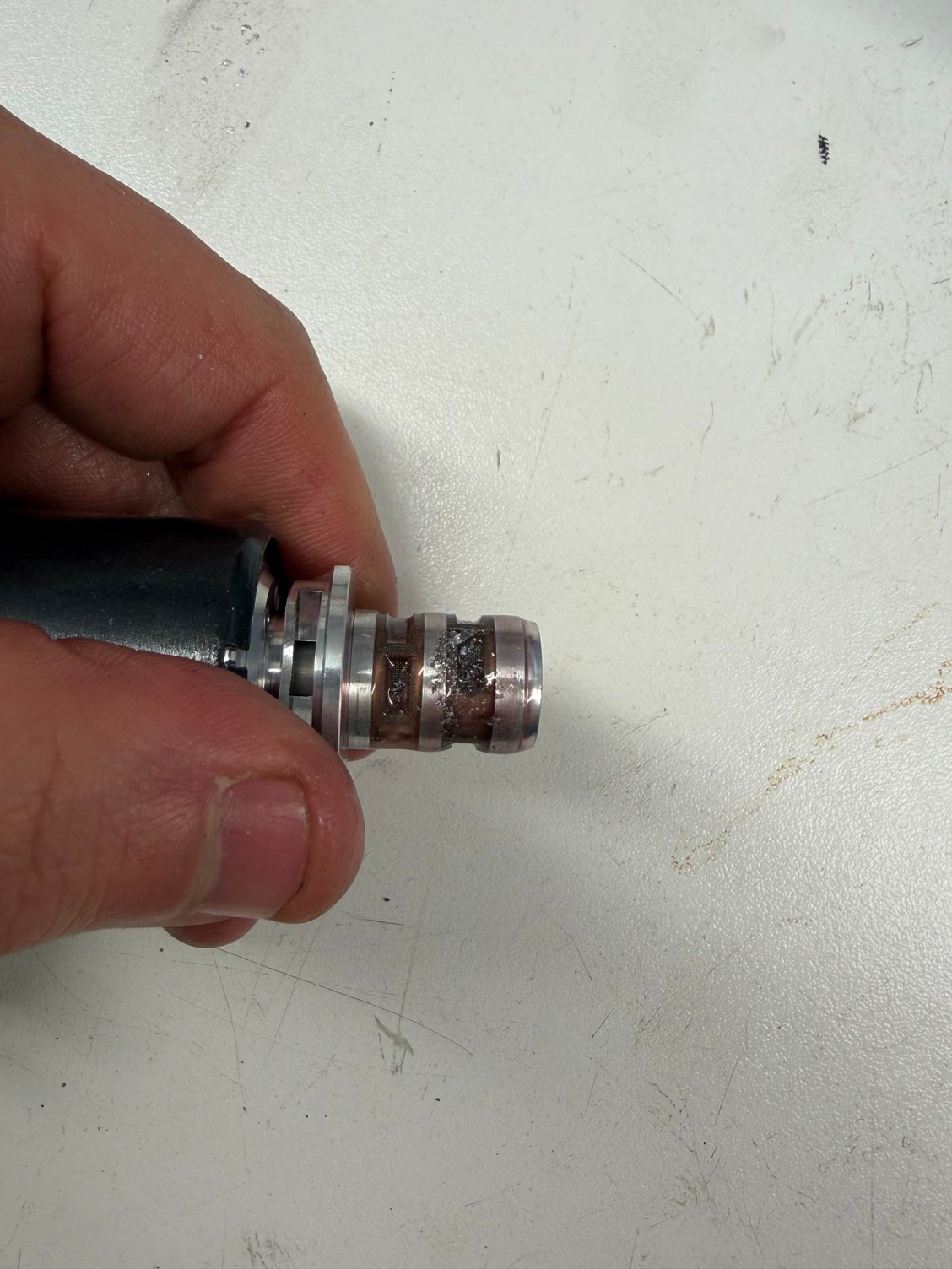

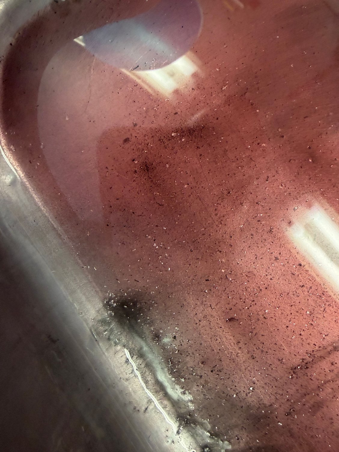

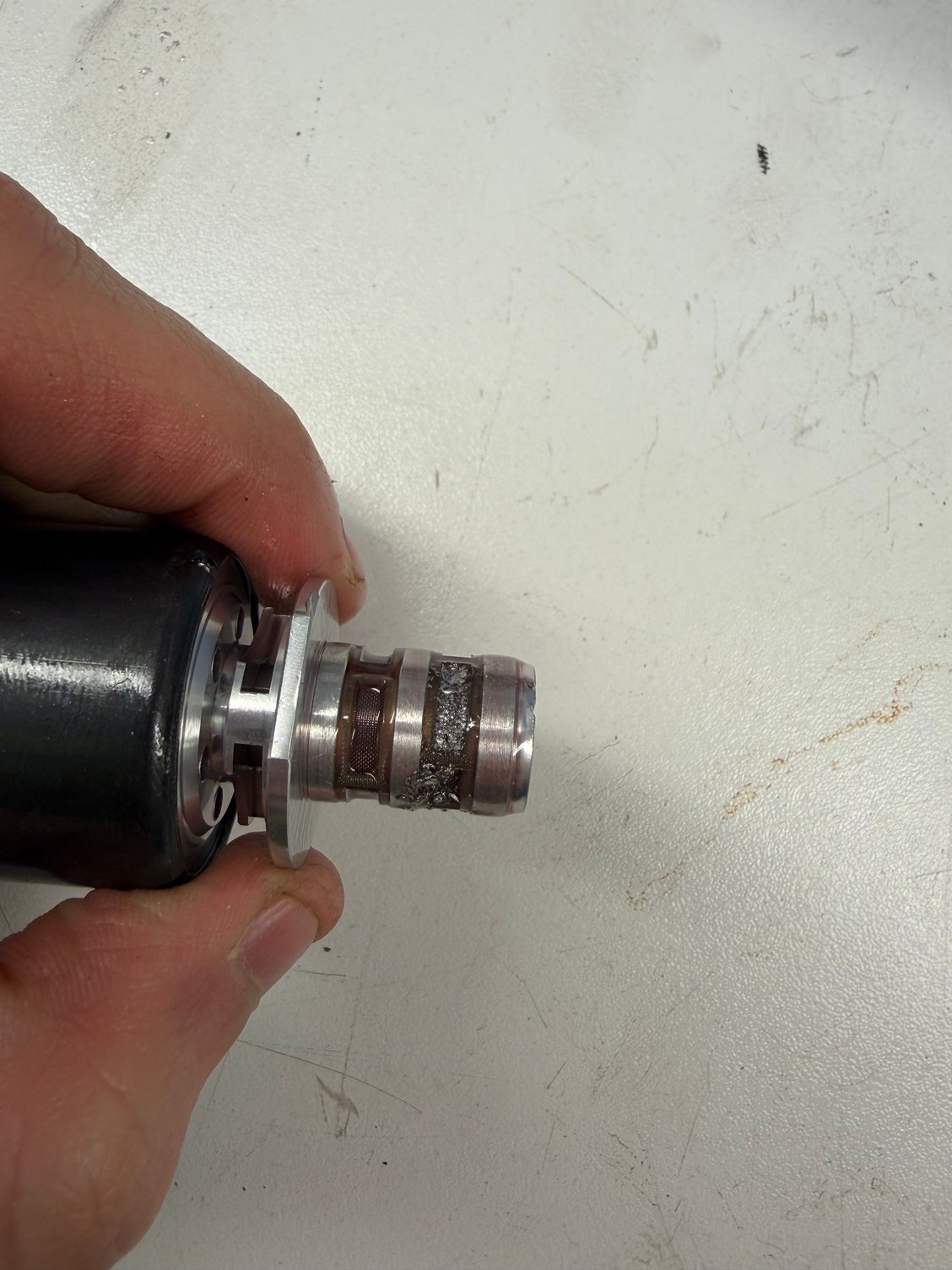

Found some metal today. Not a huge amount in the pan but quite some on the PCS sensor filters…
Enough to block the PCS from doing its job. Most likely the cause of low pressure but not the root cause..
Where would that metal come from? Mix of aluminium and something magnetic. Torque converter?
Worth to clean and continue running or pull the trans immediately?

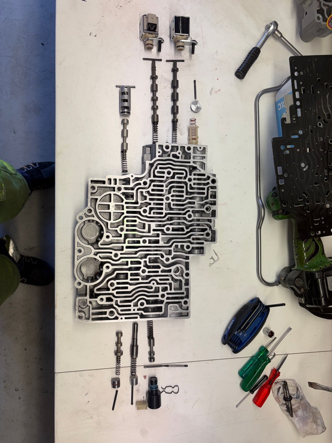

I will drop the valve body and look in the PCS filter and do some cleaning..

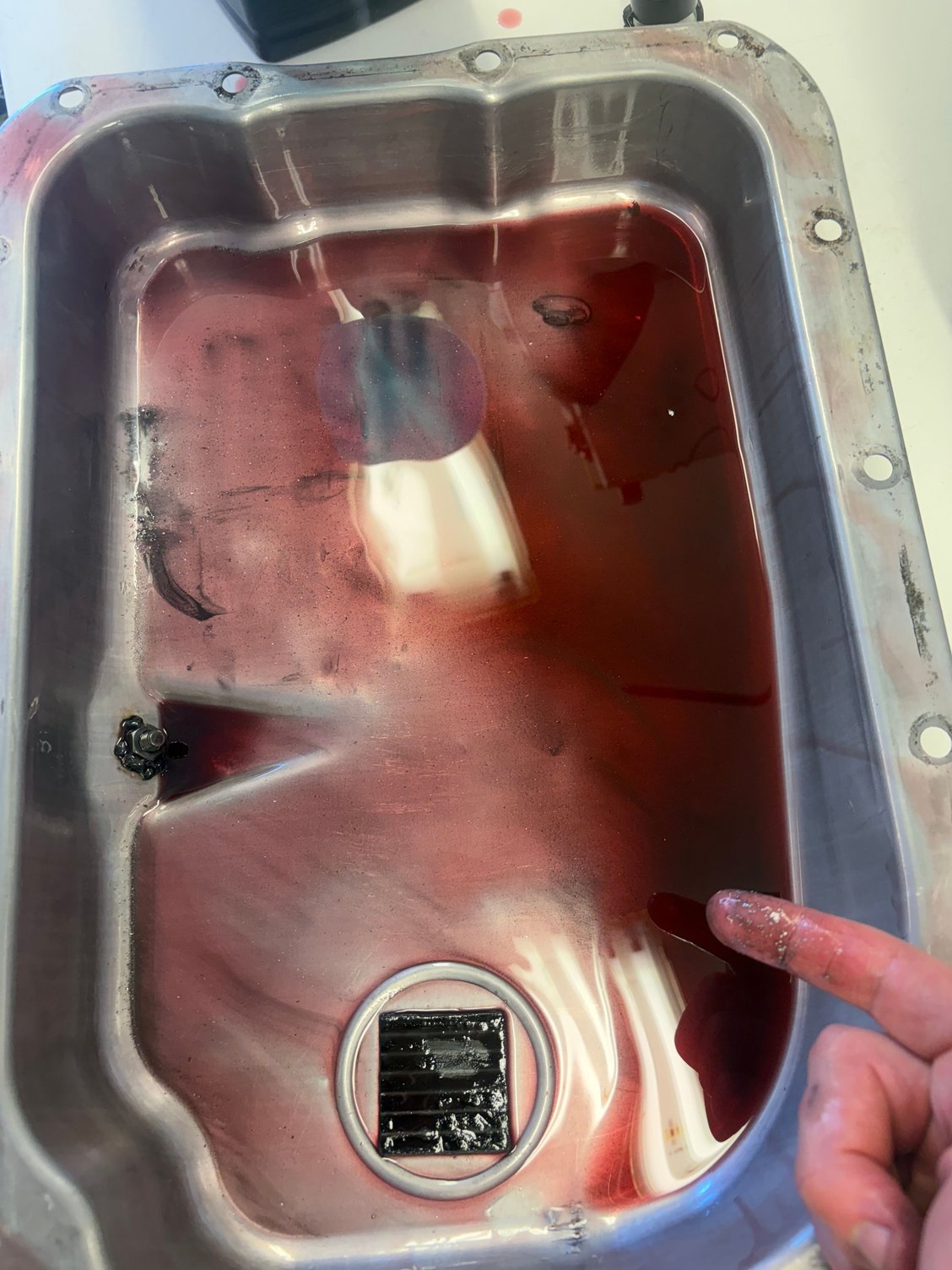

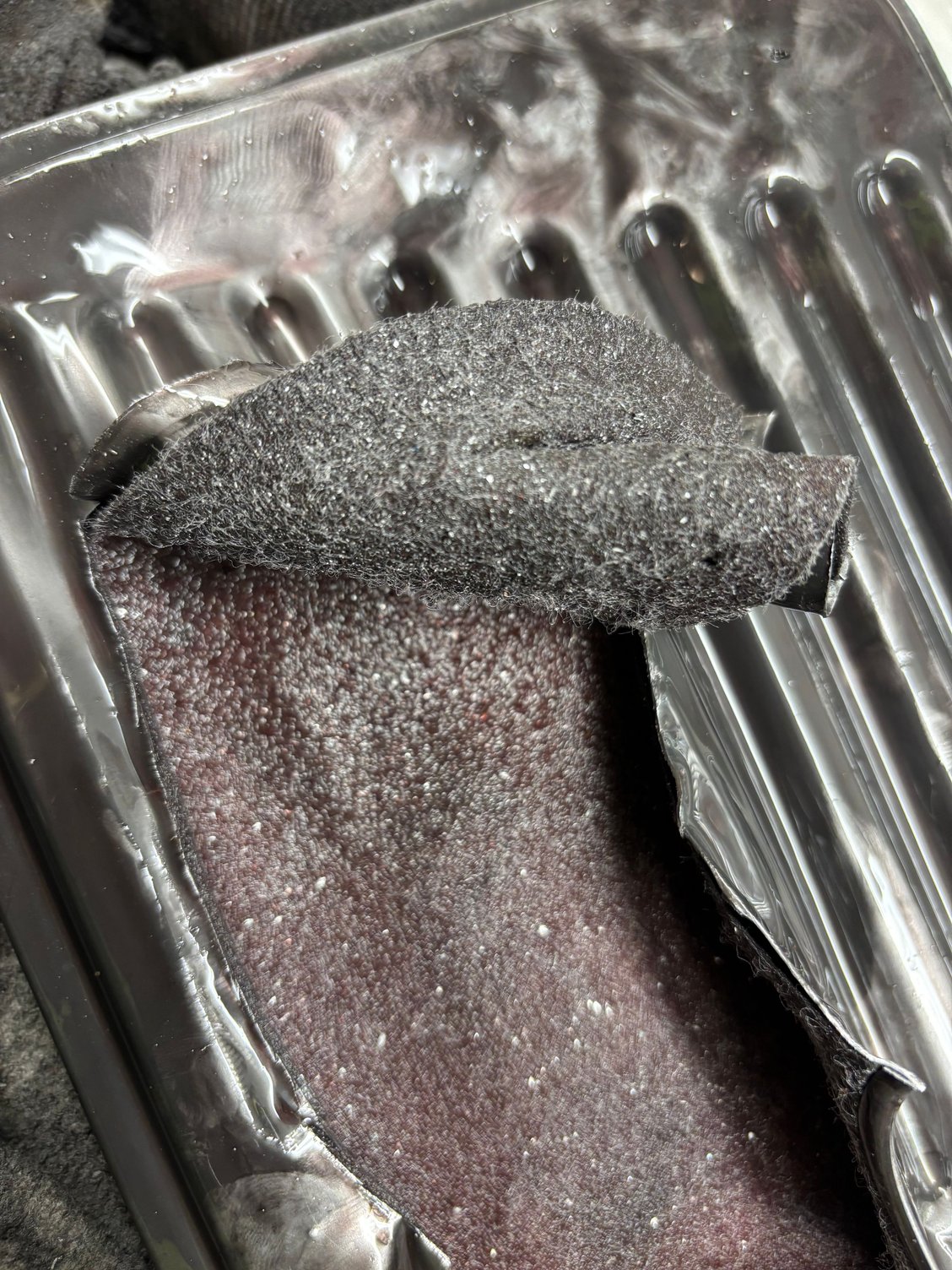

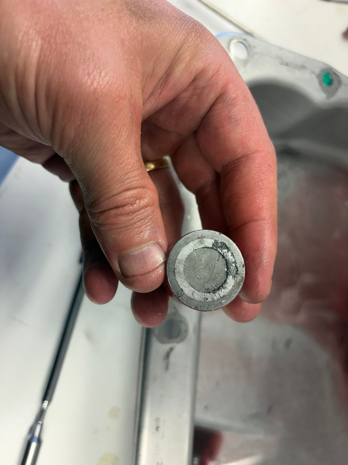

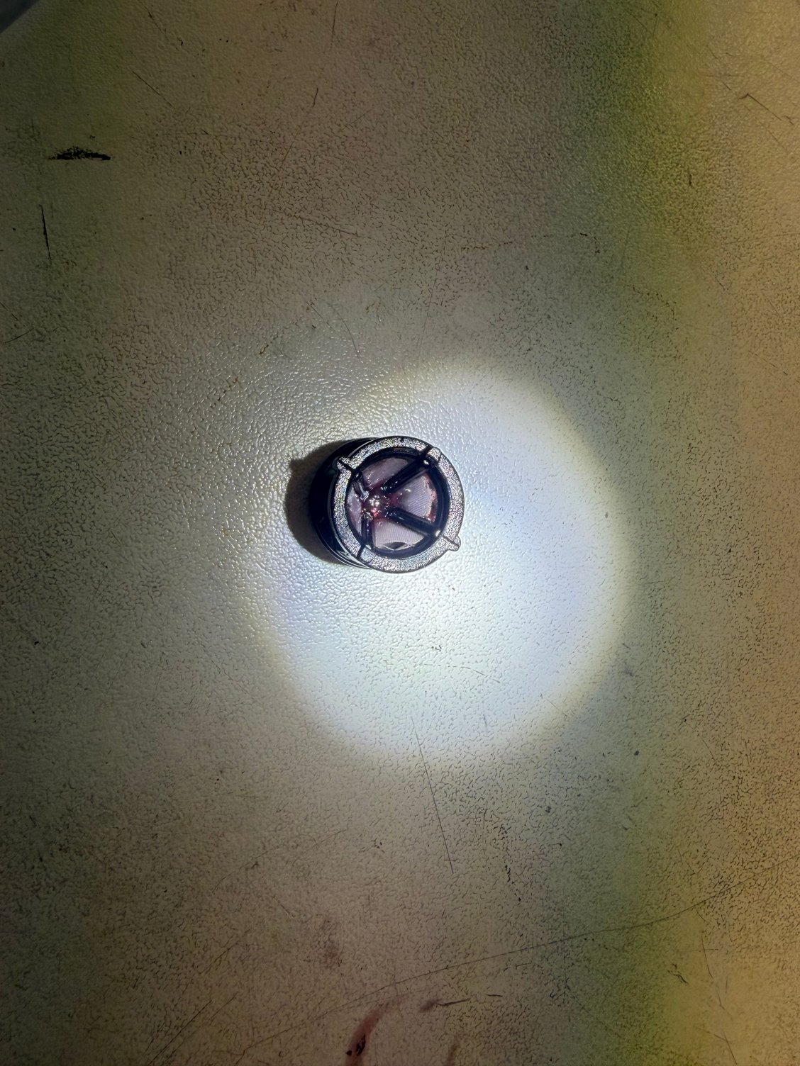

Sharing an overview of my past pan drops to give a better view of the amount of metal I have had in the pan. Have dropped the pan 3 times now.
1, Pan drops march 22, oil and filter change after 400 hours of operation. Some shavings. Size, very few that I could feel between my fingers.
2, pan drop 1st of May. Reason to low pressure and slipping in 3rd & 4th. Less then 5 hours driving.
Still few pieces large enough to feel.
PCS sensor filters full of this.
Did not replace filter or majority of oil.
3, pan drop 3rd of may. Due to pressure loss again. 1 hour of driving.
PCS full again. Dropped the valve body and found the PCS filter broken and almost clean.
This makes me less concerned as it is not strange that the sensor filter got clogged that quickly due to its size.
Very little in pan, some large enough to feel.
But as mentioned, did not clean properly last pan drop and did not change filter. What is in the magnet below is all that is magnetic.
Where does the shavings come from? Little enough to clean and keep going?

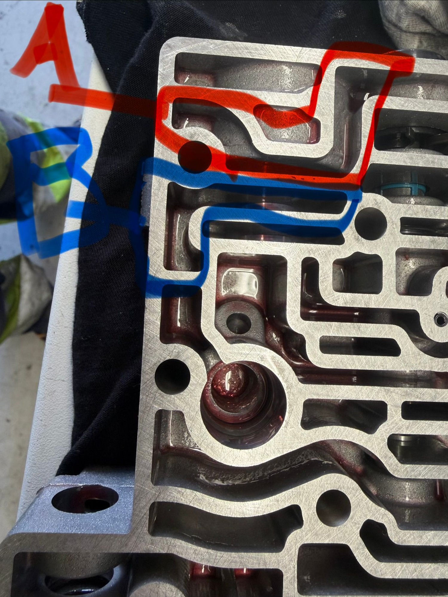

I also tried to test the PCS with vaccum but can’t figure out how it is supposed to work. Would like to avoid buying one if not needed, expensive here in Sweden and with the shavings blocking the solenoid filter I have no reason to believe it is damaged..
I measured vaccum on B section, image below, and powered on the solenoid. Unpowered it was 15 and powered 5..
My hypothesis would be that it is free flow between B and A unpowered and limited once it get power. Just hooked up 12 straight from the battery, did not control the amps.
Anyone that knows how it is supposed to work?
I cleaned and measured for vaccum on the valve body, have roughly same vaccum readings as after rebuild. Sorry for unstructured values. After rebuild is values in blue and today’s measurements are in grey below or to the right of the blue ones.

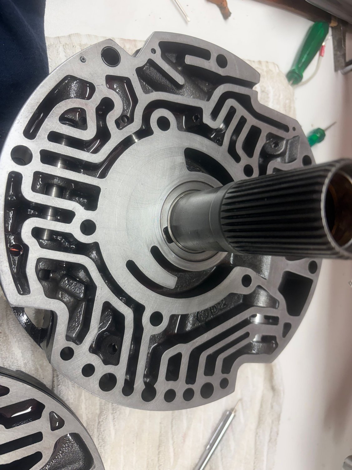

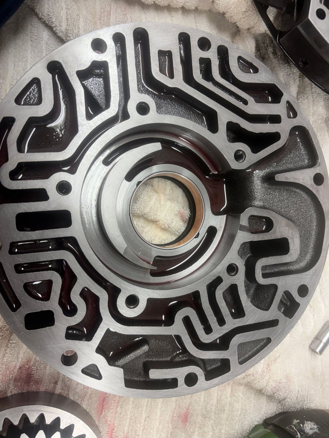

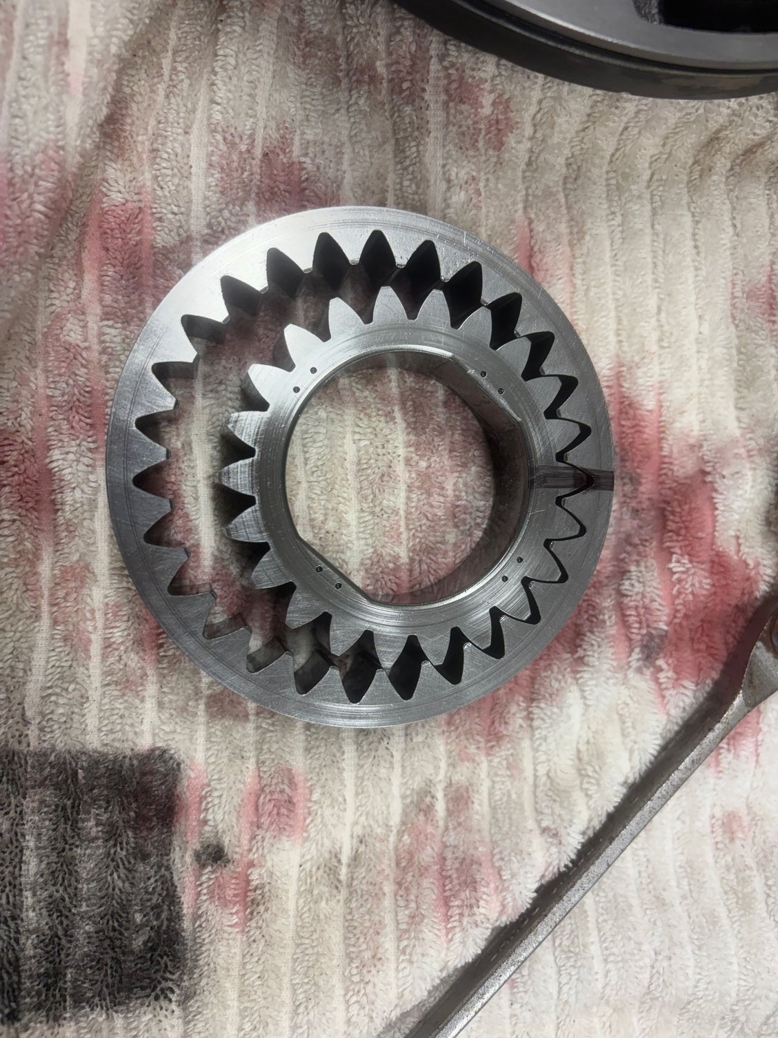

Sadly to end up in that little filter the source would have to be the pump itself IMO and would have had to have pushed through the PCS screen in VB or its missing, They I have noted on tear down of cores previously built by others omitted . But even in either case the pump or the converter would have to be the source sadly.
Thanks, @FranksCustomTrans !
PCS filter was there, but broken. I updated the former post with more pictures. 👆🏽
Do you think it will be ok to put together or will it keep getting worse once this has started?
How does a converter fail, mix of steel and aluminum residue?

I would not bother and if i am right its not converter but pump. Course I am just looking at pictures but certainly one or the other is failing, Common wiith converter is lockup clutch delaminating but generally you will get alot of black with that also . But no I would pull unit and inspect pump first , . Course if either fail they spell the demise of the other.

Agree with Frank on this one.
Most likely source is indeed the pump itself.

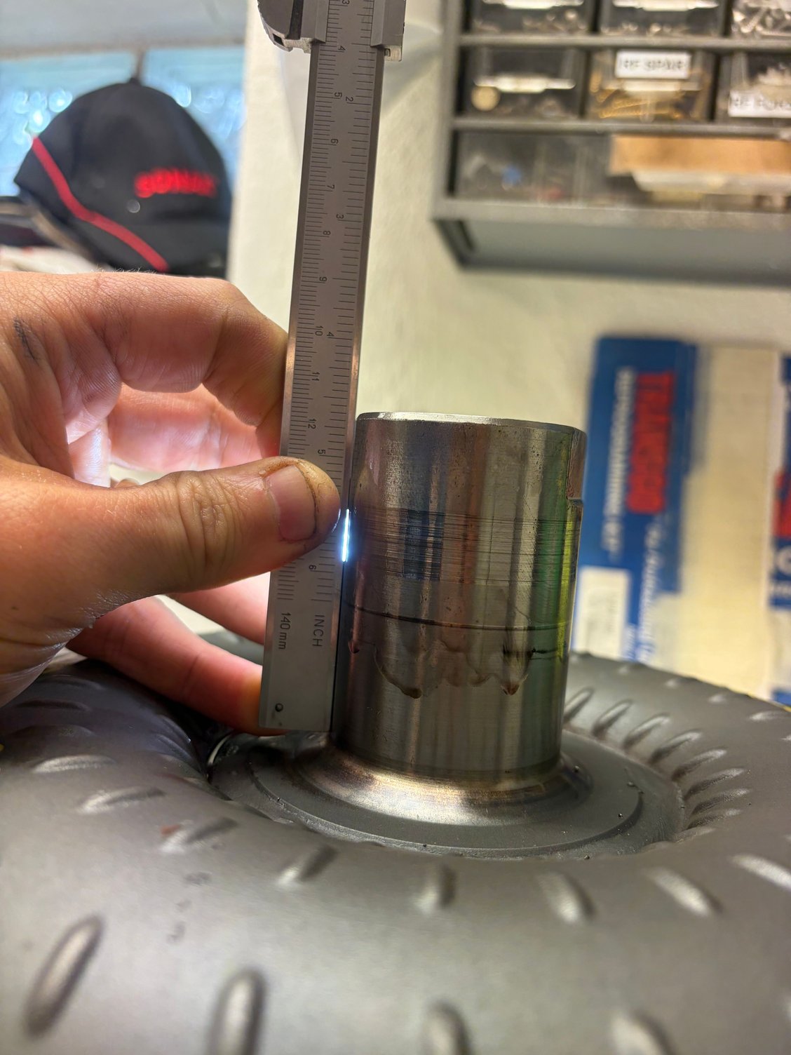

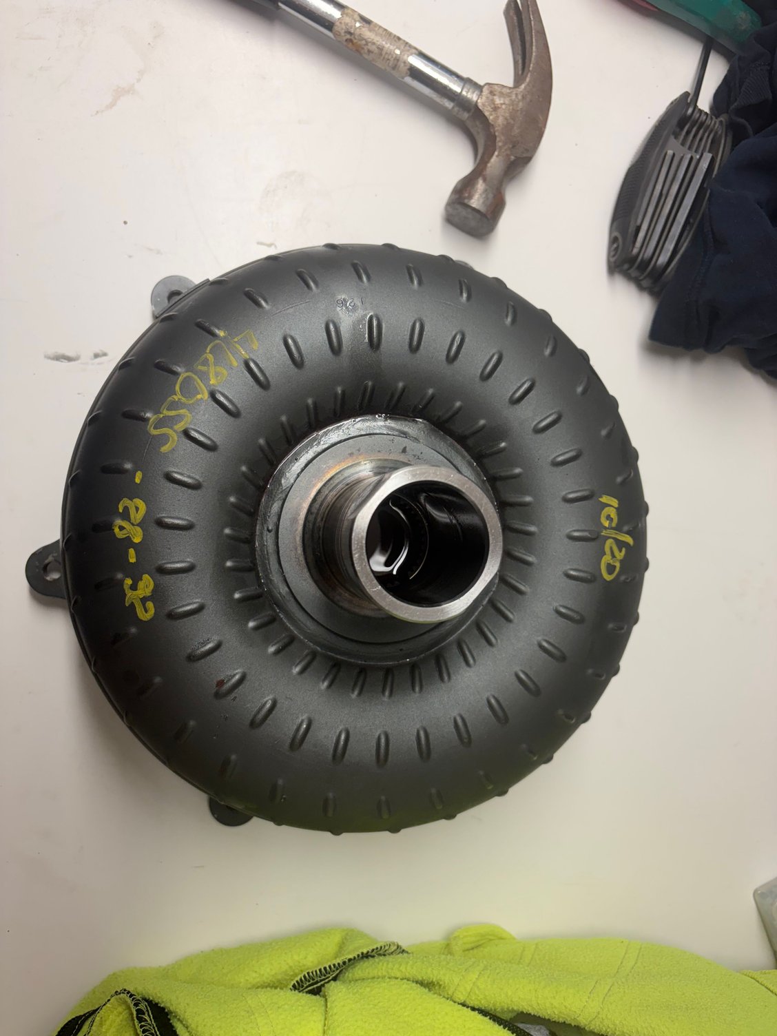

It was the converter, inside split in three and wear in the bearing surface. Is that common?
Pump is ok in my opinion.
Have bought a FTI converter to replace it and some new bearings.

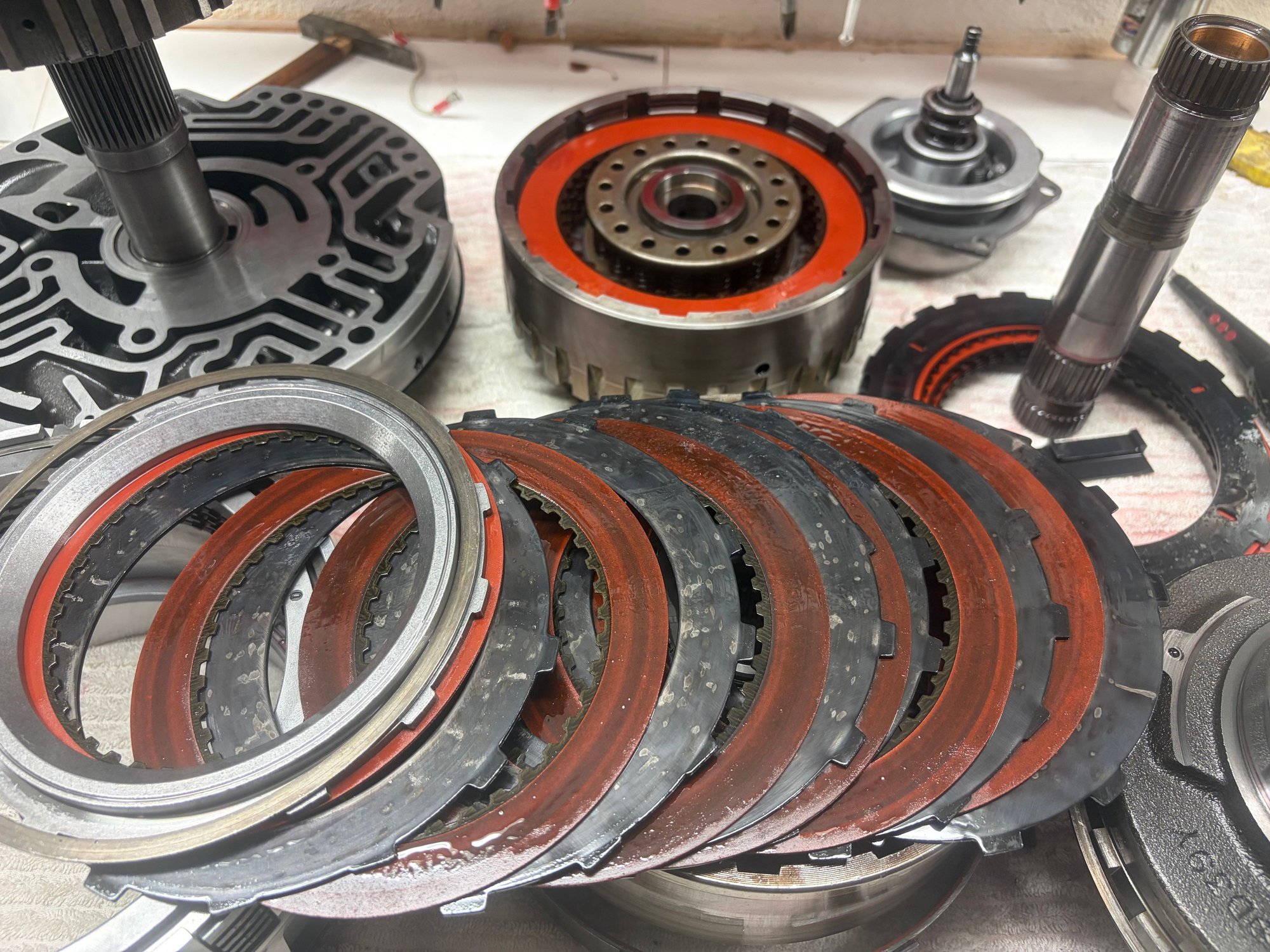

Found that the direct clutch has had some heat. Do I need to replace it? It is 600$ in Sweden… 🫣

Have FTI send you replacement clutches when they send you a converter. They should easily be able to provide what you need

They are hot spotted and have alot of the kolene black color transfer.
They need replaced
Do not replace with more kolene.
Its not necessary and just makes a mess
And 99% of people do not properly prep their kolene steels and they just install them as they receive them...which is no bueno...causes a bunch of that black material transfer.

This is the first time seeing a converter fail like that. Did you happen to notice any weird noises while driving? Did your transmission feel like it was slipping? I also have to drop my transmission and inspect it due to it acting up this past weekend. I will be doing a pressure test and transmission drop before I pull it out. I have a feeling my converter also failed.
