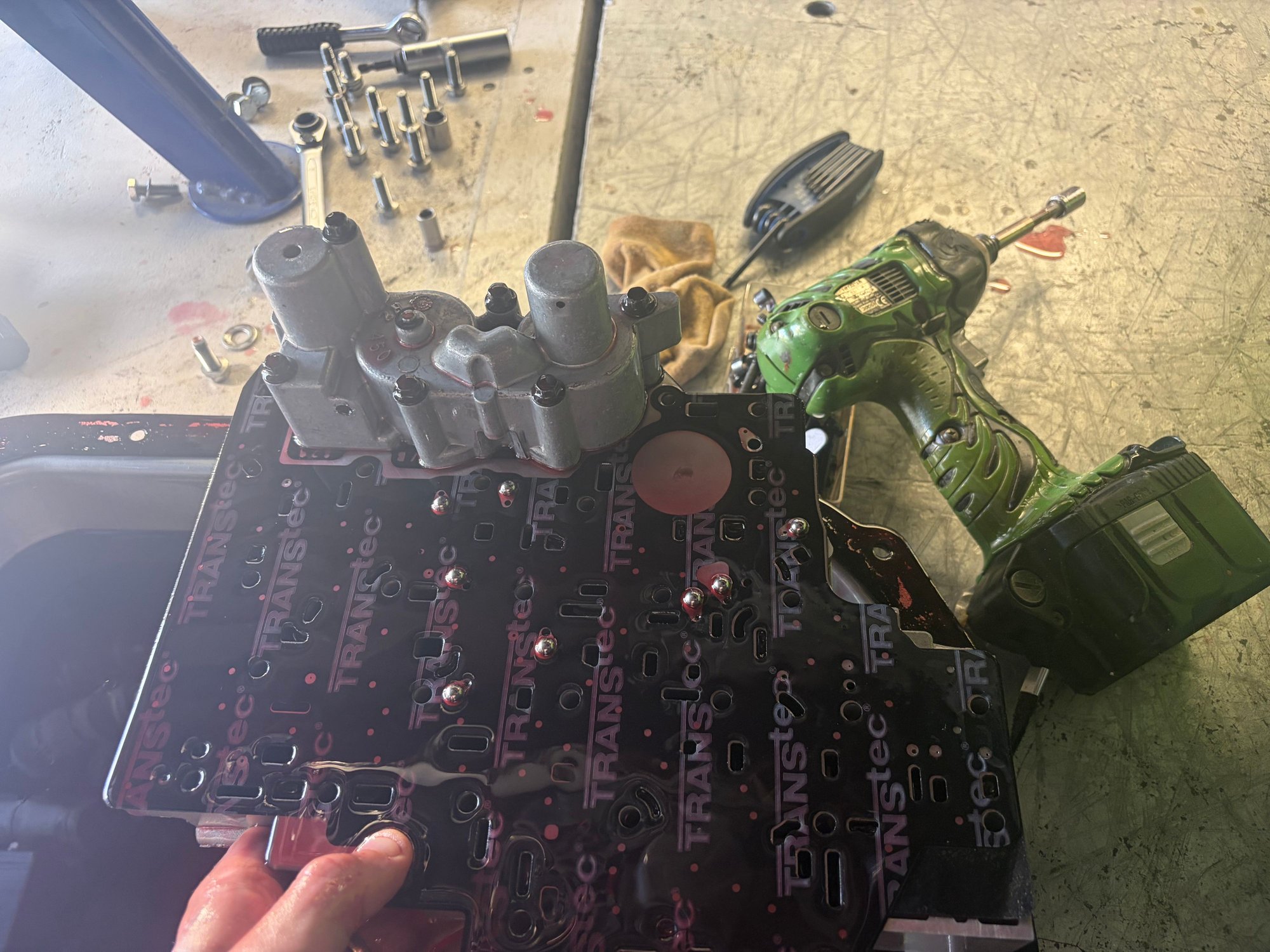

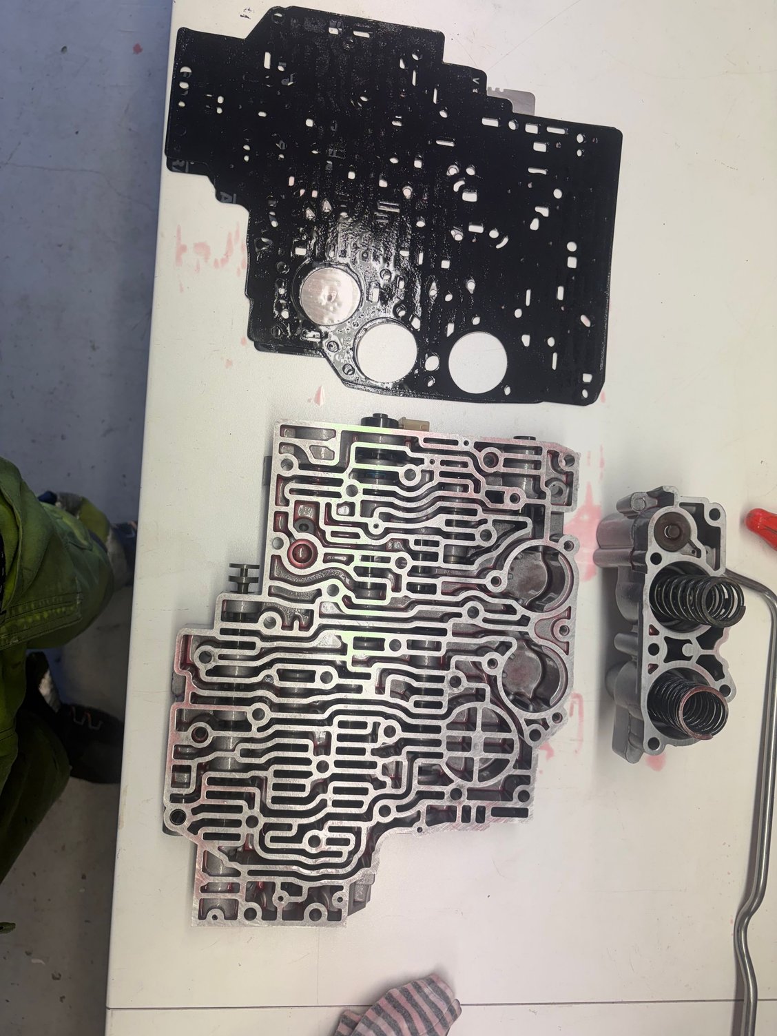

Removed the valve body again to verify checkballs and if any debris. Looks great even if I experienced some 30 km testdriving with some skipping starts.

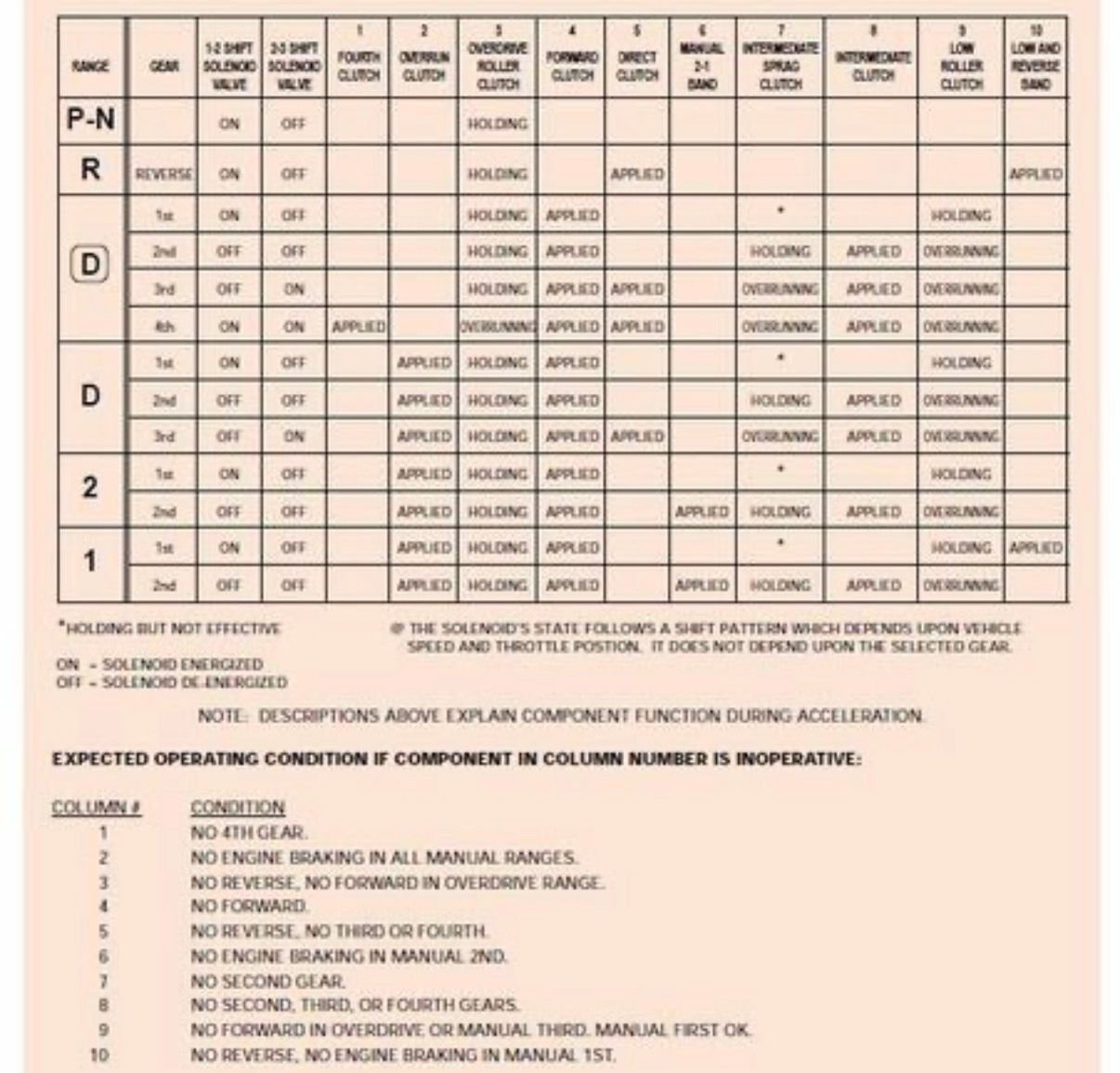

Condition 9 in above image could fit my case. But I have forward, just experiencing a slipping start.
The lower roller clutch, as pointed out for condition 9 must either work or not? Can’t be a slipping feeling? Did not do anything with that during the cleaning.

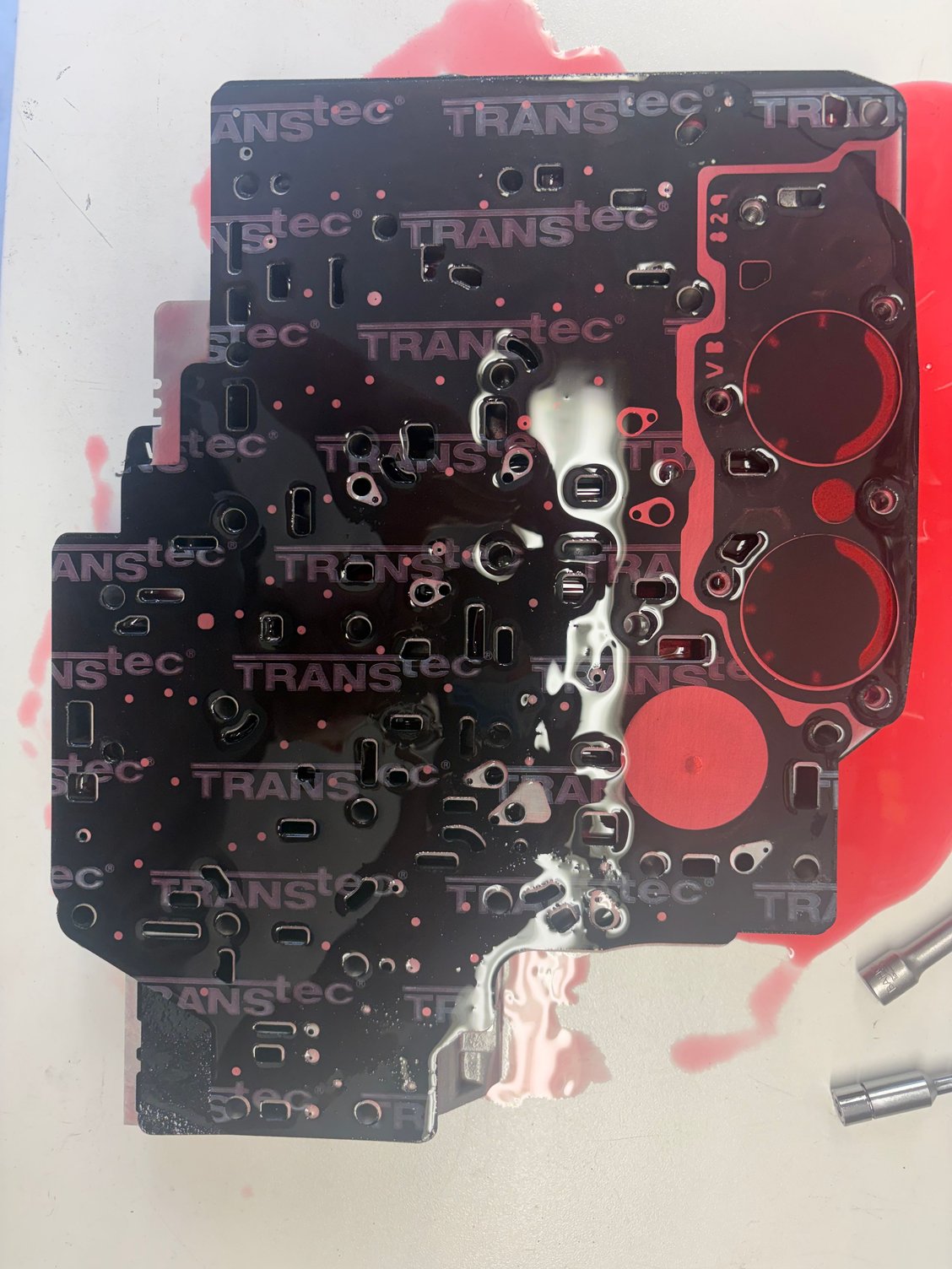

I vacuum tested the valvebody again and found that I had blocked several passages when testing the ”reverse checkball sleeve”. Vaccum was only 8hg. Same with Low/reverse checkball which was also low, around 10hg.

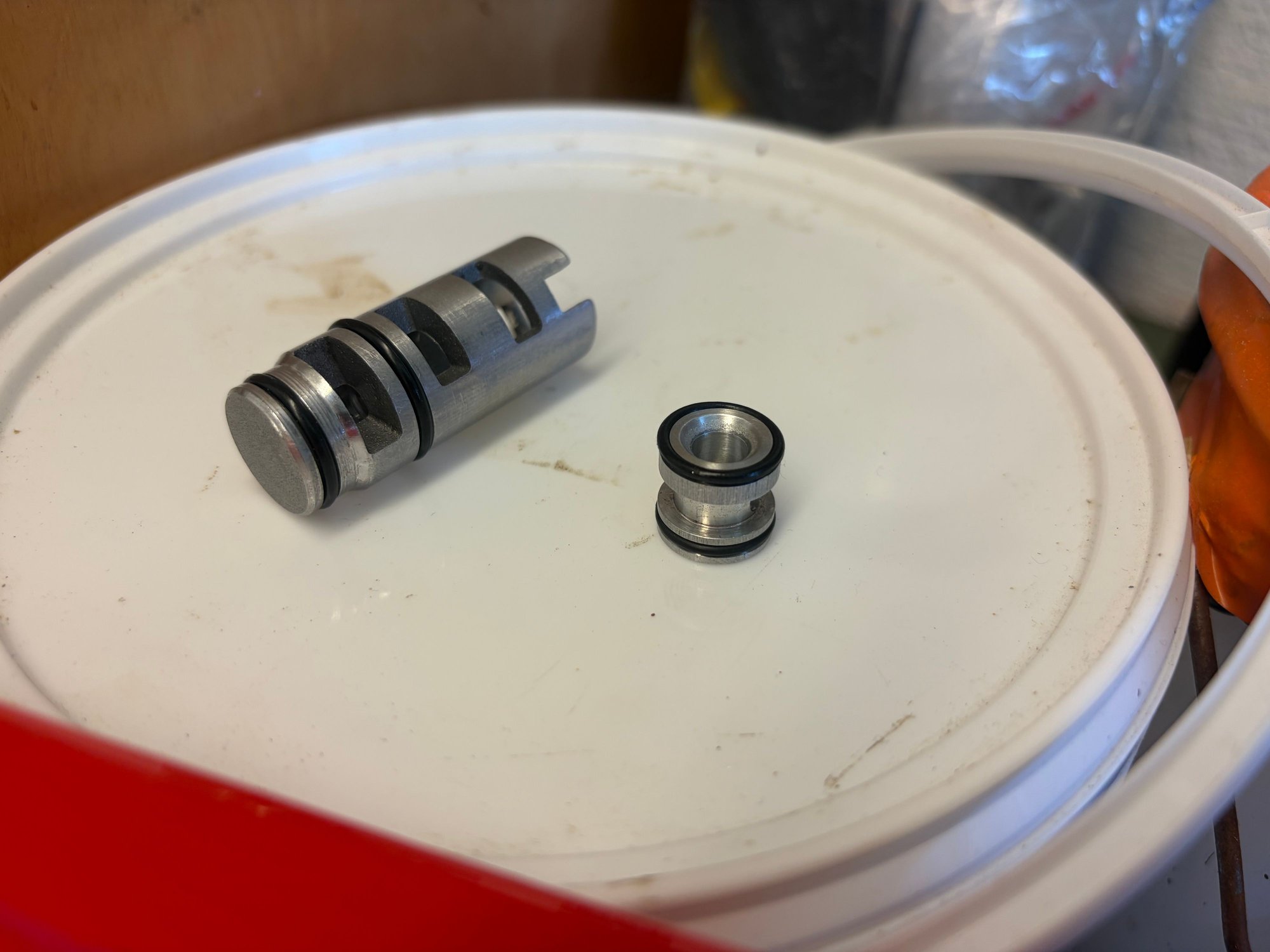

I did a DIY fix with removing both checkball seats and adding a o-ring in the valvebody before putting the seats back. Increased the vaccum to 17 and 15hg. Anyone tried that?
Assembled everything and it ran very well for about 40 minutes. Moving in idle, firm shifts, tires smoking in every gear. Working fine in all manual gears. Really perfect!
I did a victory burnout… Back to slipping start in 3rd and 4th and I lost first gear. Manual 1, starting in 2nd, same with other positions. Same behavior like before.
Feels like, at least in my head, that the checkballs are not finding its way when getting hot..
Temp was about 175 when it started to behave strange again, quickly increased to 200 when slipping started. Did not matter if I went increased line pressure in performance mode, still same slipping.
Are my vacuum readings ok? Should I replace the checkball seats with sonnax replacements? Anyone know if they fit pre 1992? Seems to be for later model 4l80e

I'd remove the o rings before they get beat apart and squeezed to the point they break down or get cut and start making debris

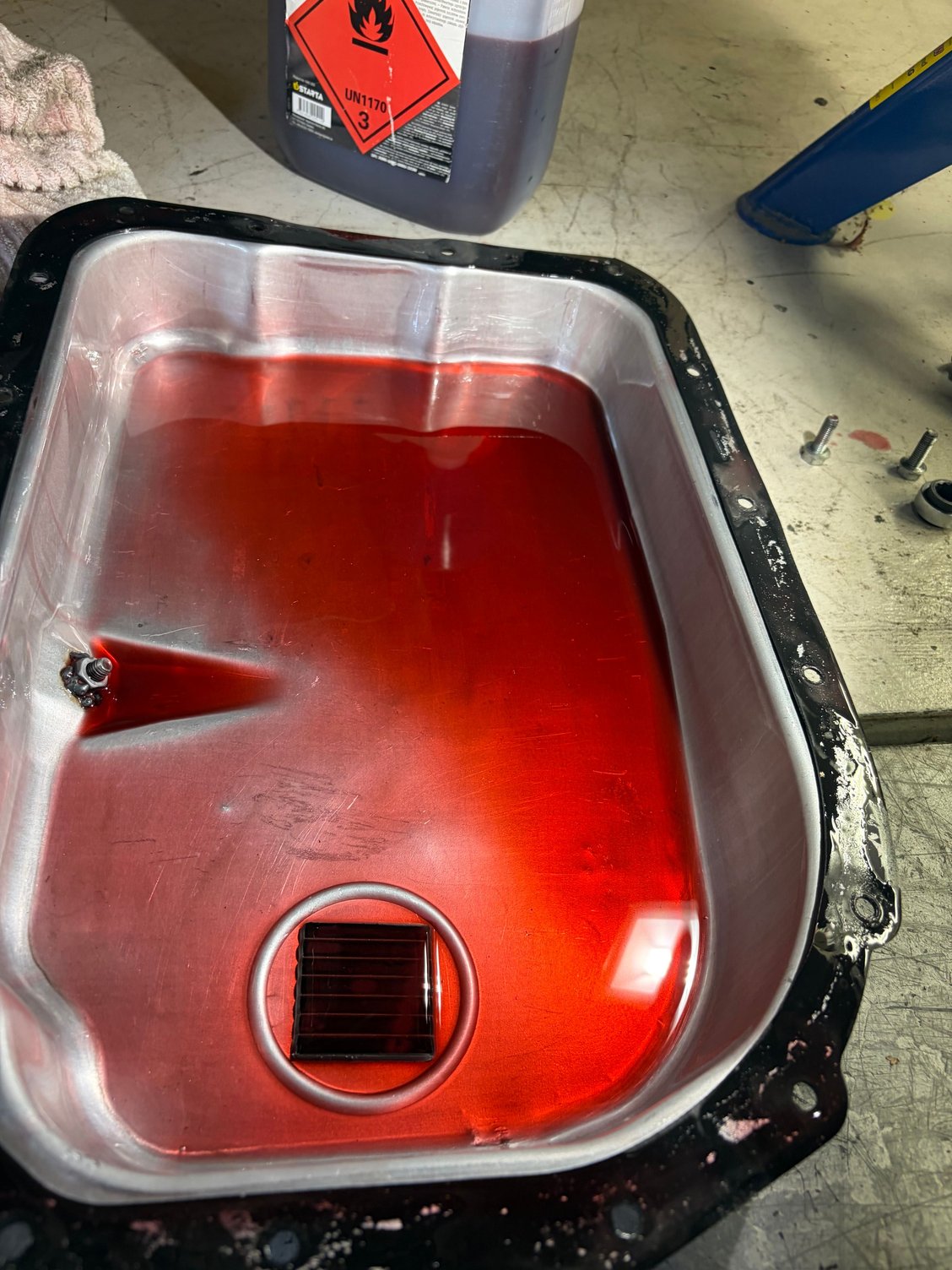

I replaced the filter after the converter failure but not since then. It is a standard filter I got from a local transmission builder. Not sure of the details other than it is the low level pan design.
Oil level is 5mm above pan flange.
Anything I can do there? What filter should I use?

I did according to the picture below,

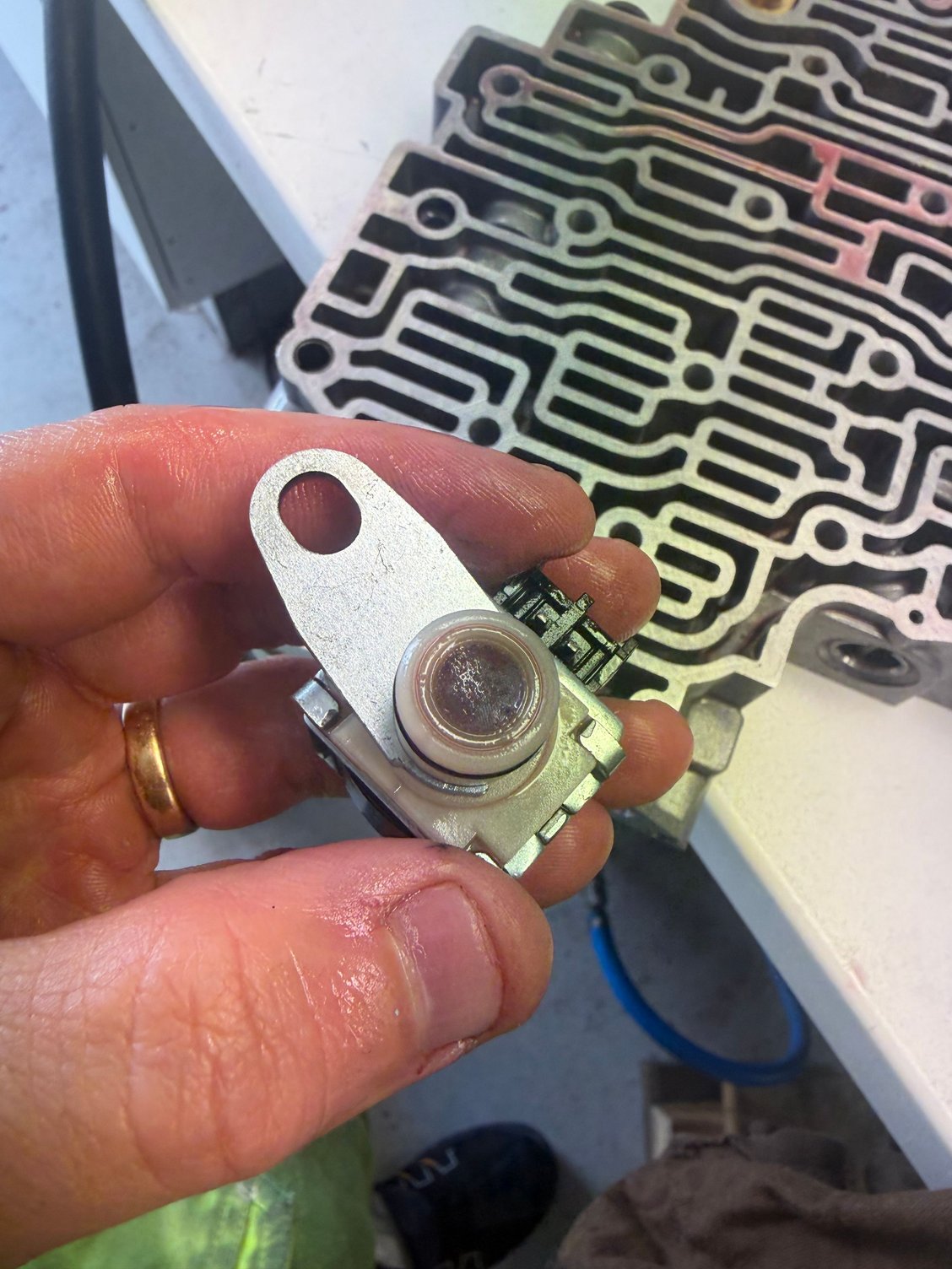

Shift solenoid was rather dirty. Could that be a factor? Seemed to be some fiber like material, maybe rag fibers from cleaning cloths..
Has been the same last times I dropped the VB. Blocking a filter matches pretty good with my symtom, workes for some time then it stops working. Have cleaned it every time.

Really hope it is not the case. Shift solenoid was really dirty again, see picture in above post. PCS works great, clean!
Did you clean out the solenoid's first time? that could ha s come from with VB filter broke and let stuff through. And yes those screens blocked can cause wrong gear starts and slow or no shifts .

2, Valveboby cleaning, air check, vaccum testing and temporary correction of checkball seats. Did notice a fibre like paste on the shift solenoid filter. Did not think much more about that at that point. Just cleaned it again thinking it is leftover debris from first rebuild and cleaning. Pictures for that drop,
3, Valvebody cleaning, permanent O-ring rebuild of the checkball seats. Vaccum testing.

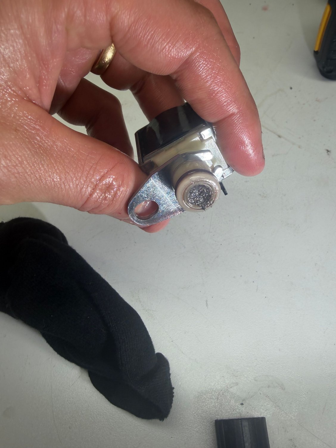

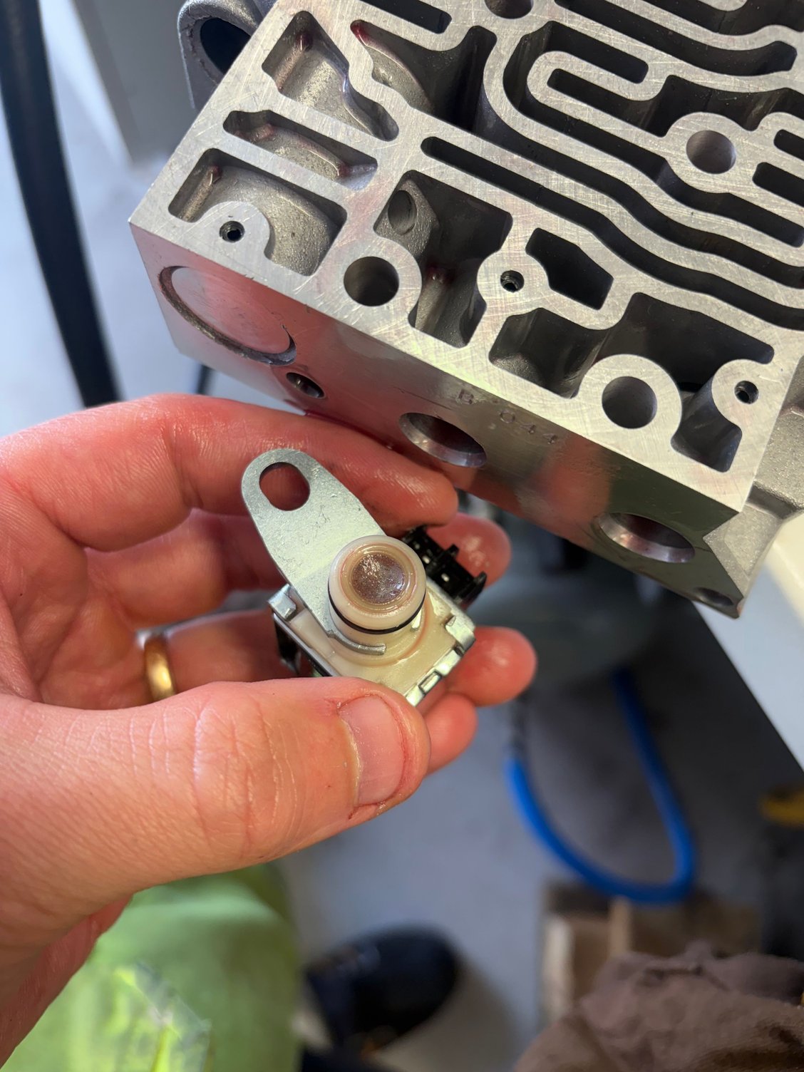

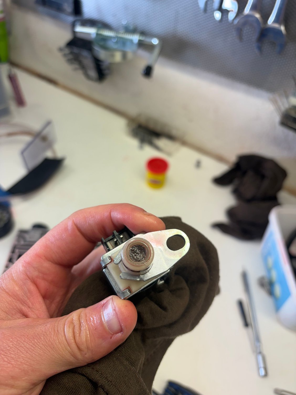

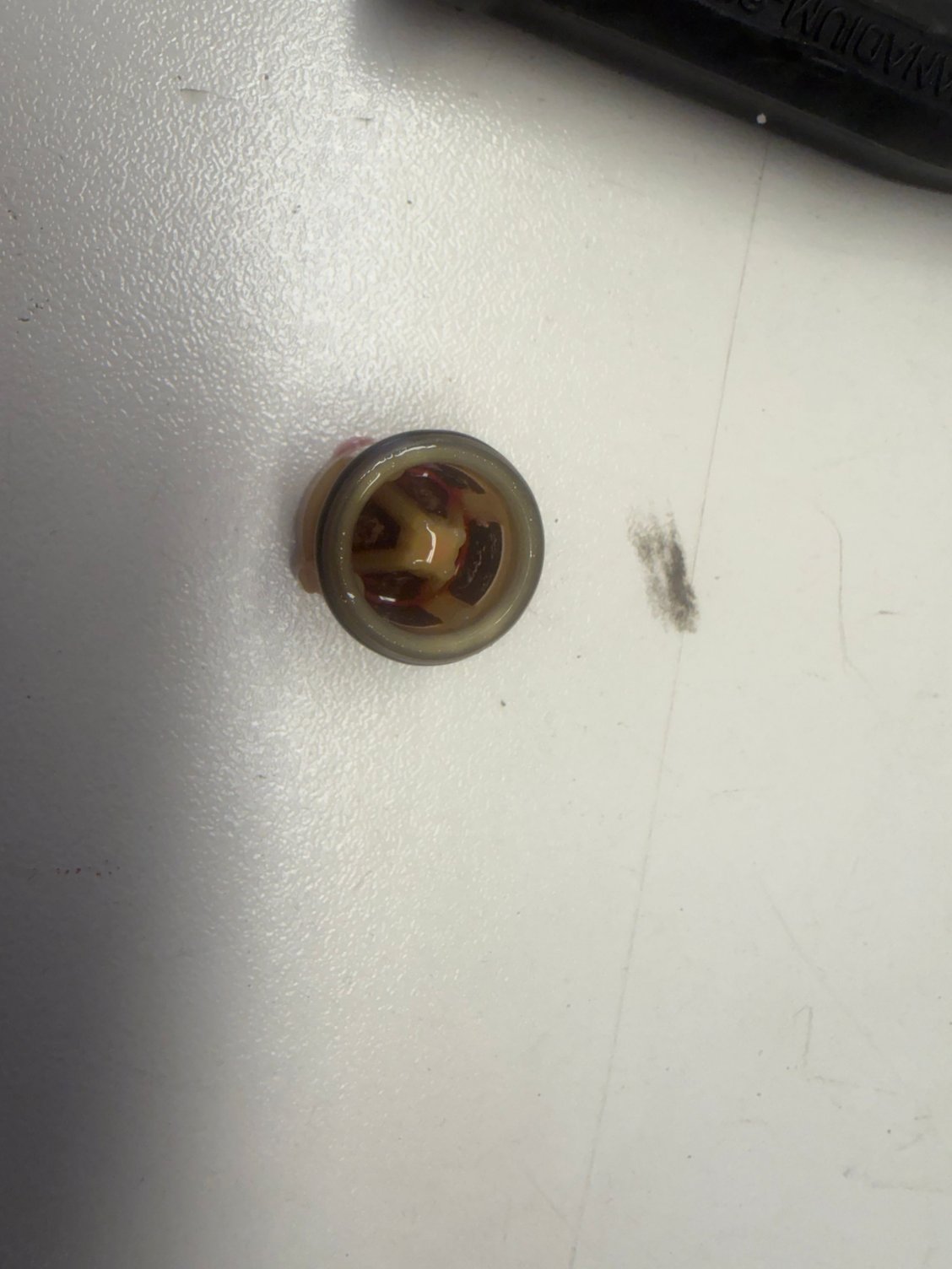

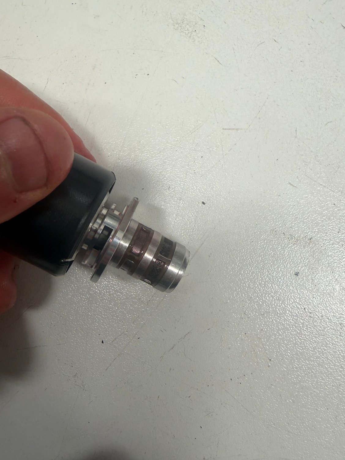

Did notice the same fibre like residue on the shift solenoid filter this time. If you rub it between your fingers it kind of sticks together, very fine, would that be from my alto clutches? Fibers from a cleaning rag?
More on the 2-3 shift valve solenoid. Also found some tiny bit in the AFL filter too. Totally a very tiny amount but enough to restrict flow slightly when blowing in the solenoid.
The PCS filter and PCS had less residue this time.
Plan to assemble it all again today and ”hope” it is the shift solenoid filter restriction causing this.

Could I remove the shift solenoid filters to get the very small debris to pass thru to the main filter instead?

Thanks! Problem is still there after it has been cooling down 24 hours.
As I mentioned above, what sits in the solenoid filter has been a fibre like paste, very fine and binding together.. very small amount, not magnetic and small enough not to feel it when rubbing between fingers.
It was not the TCC burning up, the inside split in three pieces. A lot of aluminium.
Will be in Australia this week but will inspect next weekend.
Any other thoughts?

Add an in-line spin-on filter to the cooler line.
In a typical application, I put the filter between the trans and the cooler on the "out" line from the trans
In your case, I might consider plumbing it on the return side between cooler and trans to catch whatever seems to be in there.
Cooler lines if FPM could be degrading. PTFE not as likely
Stuff in the cooler that gets broken loose with flow and temp
I've seen fiber washers like what's on the pump start to get worn and they make a hell of a mess that'll clog anything.
Etc Etc
There's debris somewhere...gotta find its source
Solenoid pattern for an 80e is
A/B
On/Off
Off/Off
Off/On
On/On
If B is getting the debris and holding it on...you'll basically be starting in 4th even when first is commanded. Honestly I'm surprised the car wants to move at all in that state. The oil temps make sense...that converter is FIGHTING

I have no idea where this comes from. My only hypothesis is that there is still some debris left in the cooler, thus trying to clean it.
Could also be something left in the torque converter. Bought if from a transmission rebuilder that told me it was involved in a transmission failure. He had sent it for cleaning.
I will take following actions,
-Inspect and clean solenoids again
-Replace inline filter and oil
-Mount a 3/4-16 spin on filter on the return line, between cooler and transmission.
Any recommendations on choice of filters? Limited availability in sweden but will make my best.
In-line filter, I bought a 8684221
Spin on, what to go for to limit restriction?
