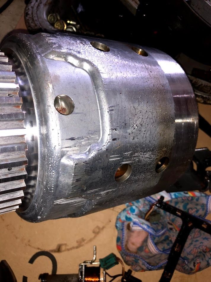

I have a question about rebuilding this trans. The input shaft has some good scraping on the outside and I'm not sure if it needs to be replaced or not. I feel like I've seen a few videos and photos of people putting them back together with marks in them. Should this be replaced?

Thats the normal surface finish. It's as cast where it's rough and machined down where it's smooth.
