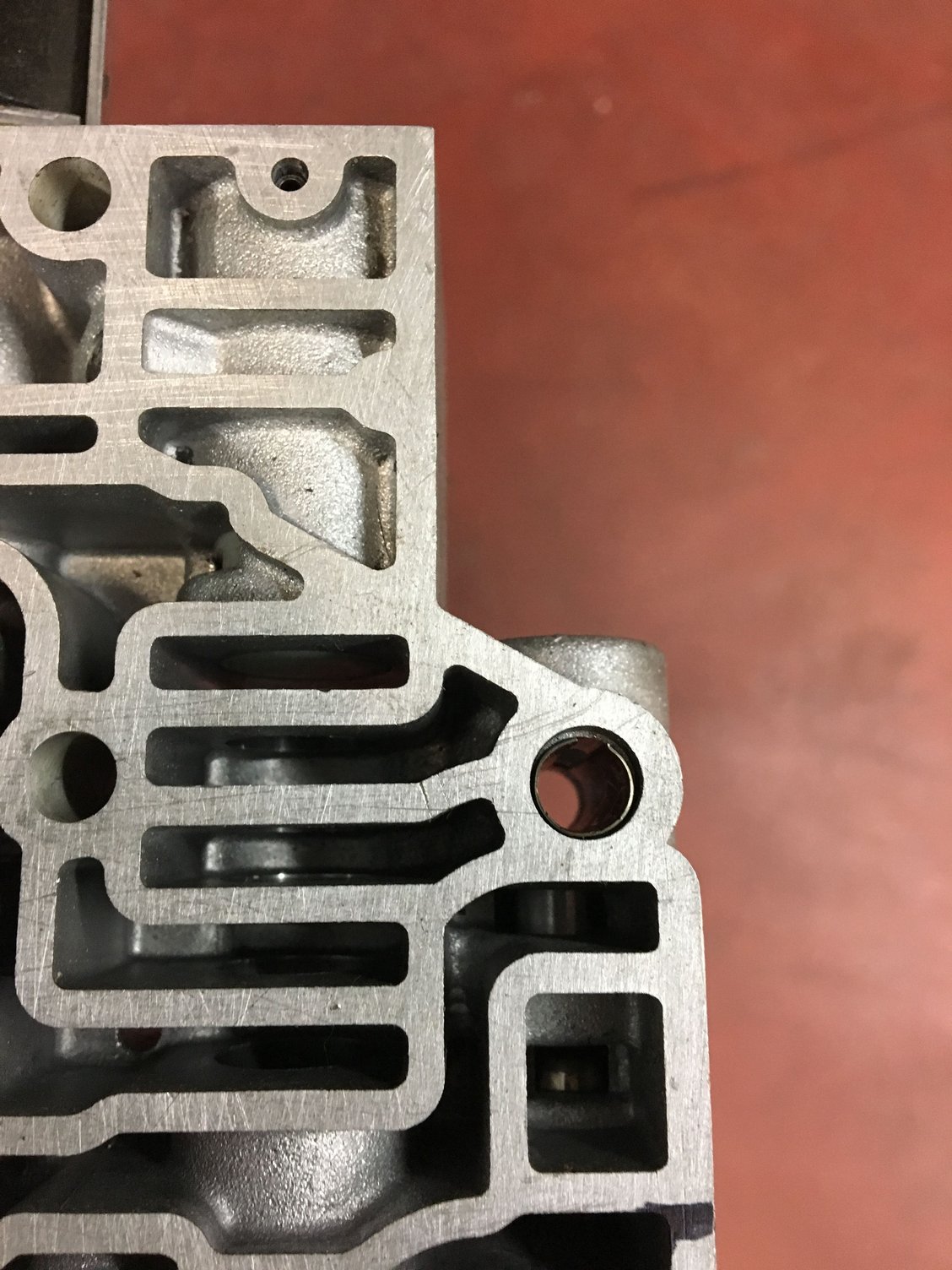

I was in the middle of installing a TransGo HD2 into my 4L80E when I took off the accumulator housing and a large spring/roll pin appeared. I am unsure where it was, if it was in the housing, if it's from the valve body, or if it was already loose. Here's a picture of it - does anyone recognize it? It's about 3/8" diameter and a little over 1" long. I couldn't find a suitable cavity for it but I'll look again tonight.

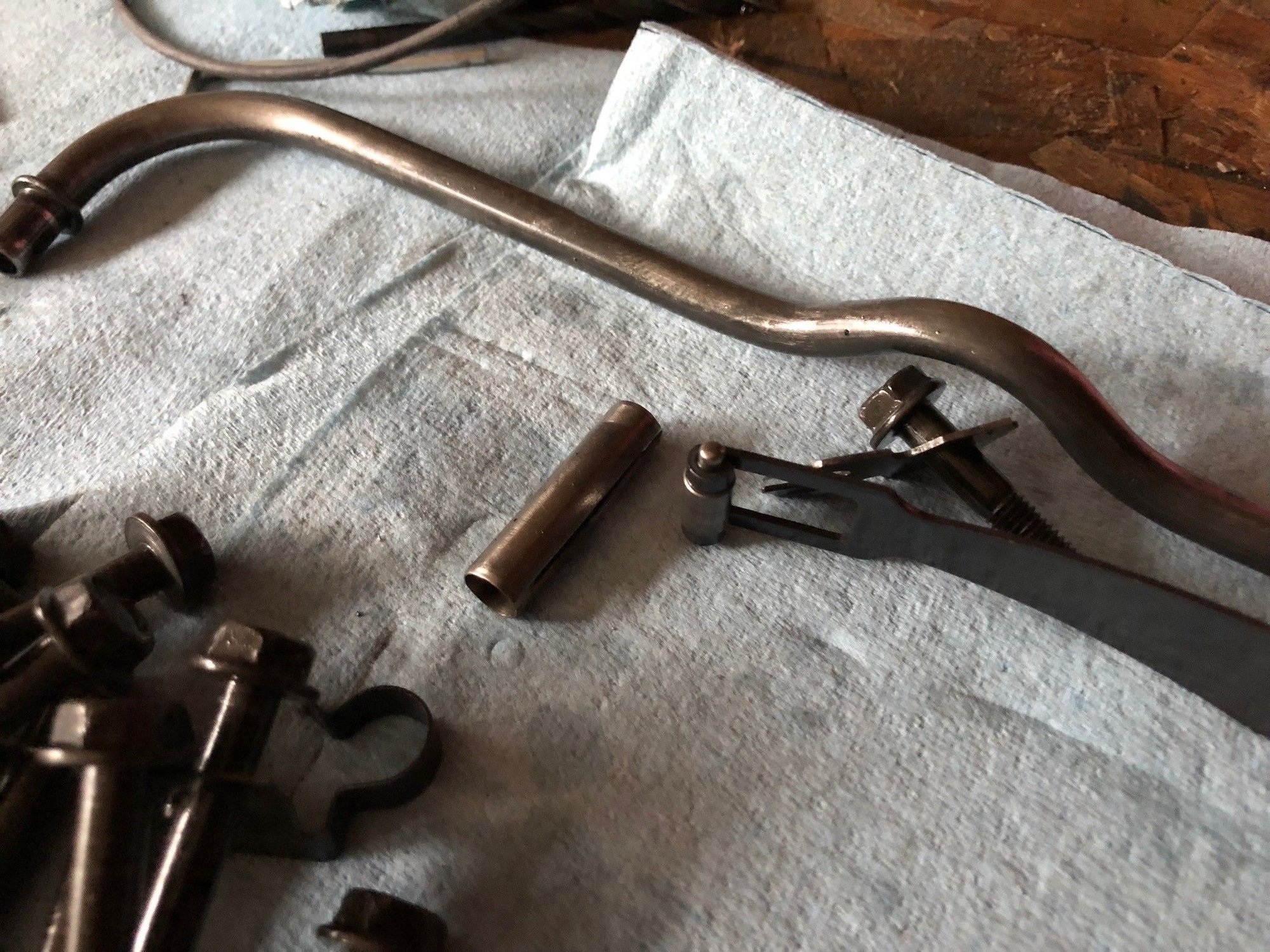

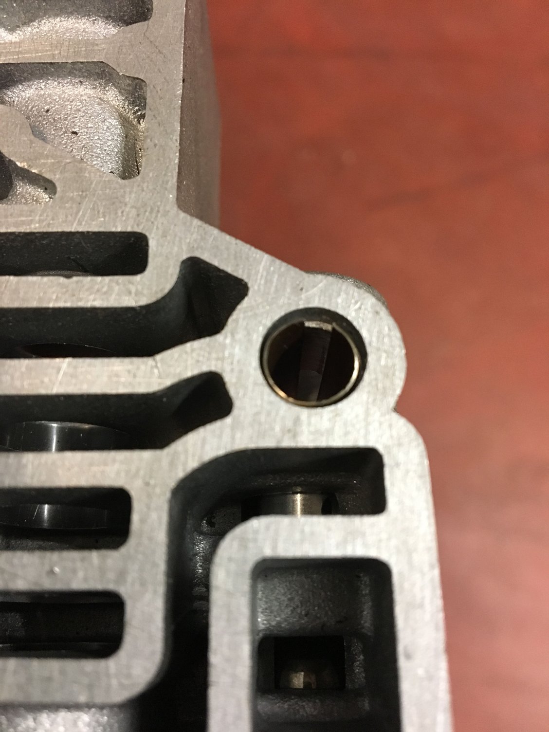

It goes in the valve body. It's the bolt sleeve at the end of the manual valve.
