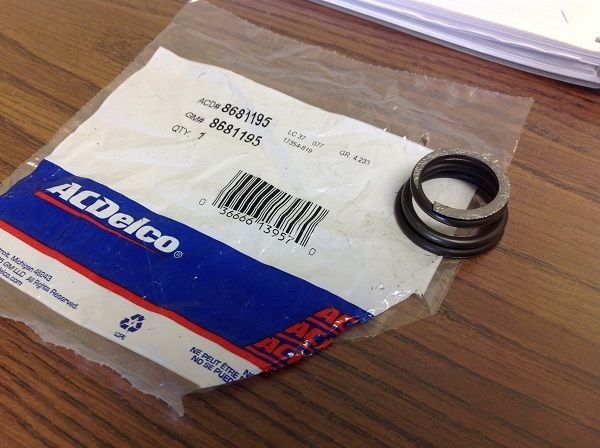

Hey all...about to install the Sonnax 4th Gear super hold dual servo...their instructions say to install the GM Spring (PN 8681195) in order to cushion the 1-2 shift and reduce the 3-2 downshift clunk. I have the spring (see pic), but where to I put the spring?
It's probably obvious....just not to this amatuer. A diagram would help. Thanks for any direction. Jake

it is inside the 2nd servo.....under the cover
my bird already had that spring in it

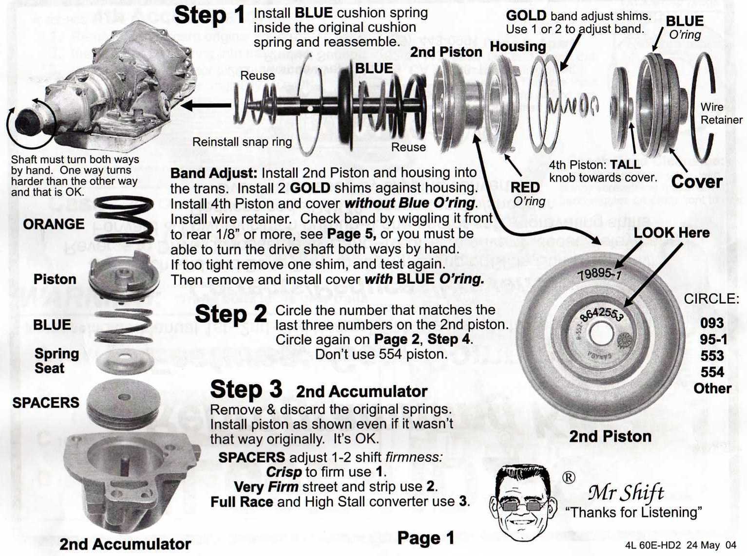

the 2nd servo cover is to the left of the "blue" spring in this TG diagram ( servo ...not accumulator in the bottom left hand side )....that spring you have goes under that cover with the other spring that is in there
