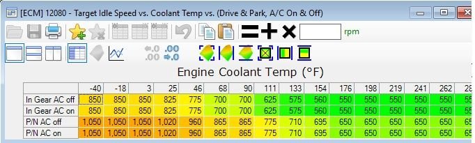

Does it idle higher than 550 rpm?
It used to be common for the pcv hoses to rot way back behind the intake manifold where you can't see them or even access them without taking the manifold off.
A vacuum leak may cause weird problems, if it's small enough the idle air control will make up for it but cause weird transitions when returning to idle.
After warm up: While in gear not moving, gauge says VERY close to 800. A hair width below. While in park it sits a hair width above 900.
Digged into stock idle rpms. Sounds like every 98 auto is 150 off on the gauge. Which then makes it 650 in gear and 750 in park. I obviously should hook a scan tool up for real world numbers.
Should be 550 at operating temp, in gear.
