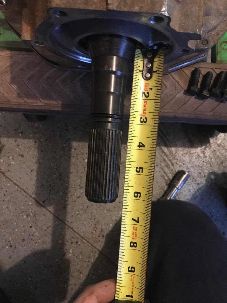

i did search, but id rather be safe and just ask. this is the last piece before i can put it in. putting an 80e in my 99 z28 so i need a yoke going to 1330 i believe. but i dont know which yoke i need other than that and where to buy it from. all around $140?

You need a yoke with a counterbore.
Something like Neapco N3R-3-9131X will work.
There's a BUNCH of those type out on the market

i like the price on that better. why does it not mention what size ujoint? that model only works with the 1330 so they just dont list?

What model?
you can get 1330/1350 conversion unit

I would give Denny's Driveshafts a call. They were very helpful
