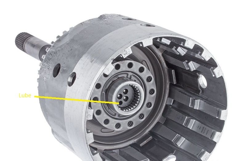

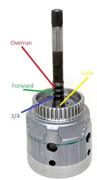

There are 4 sealing rings and 4 holes.
I've marked each in the picture below.
The one without the steel ball closing it off is lube.
Vortec is right on point, these are just some different pics for the learners that like a picture better than a drawing.
