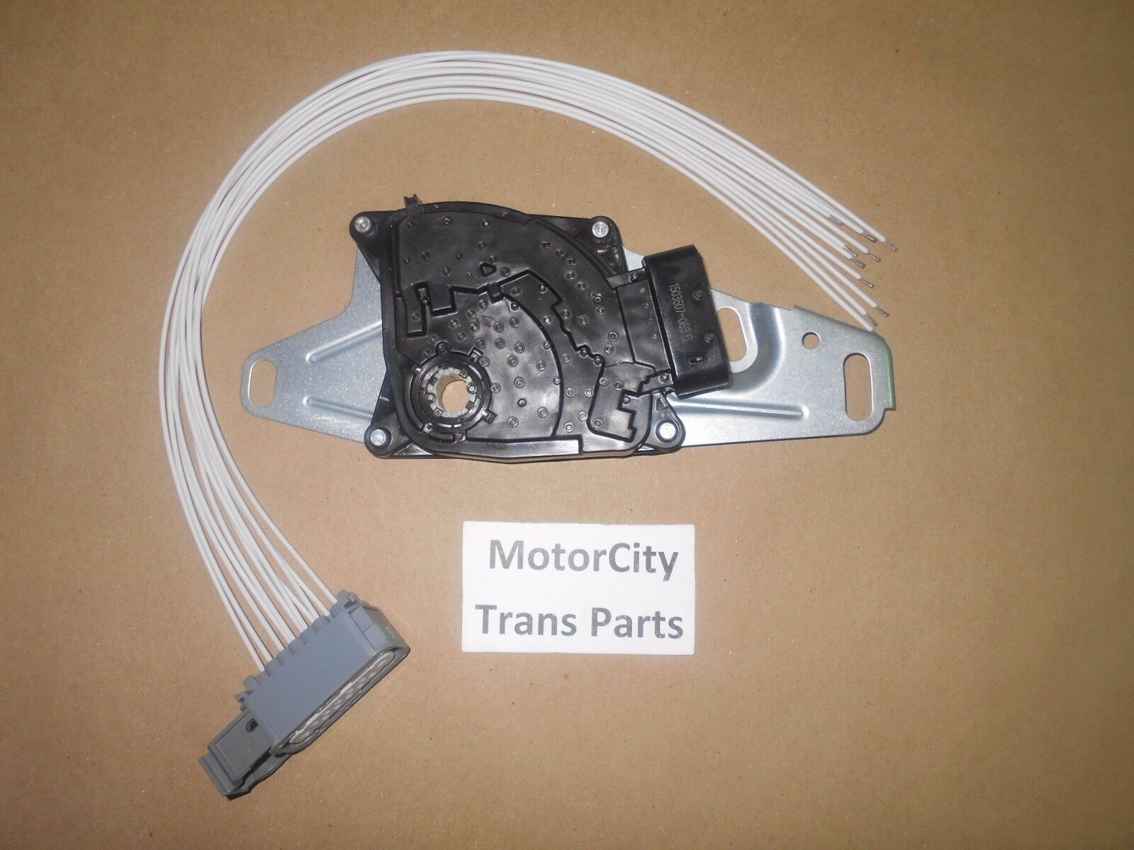

Just to make sure...
Your Switch and electrical connector looks like these photos?

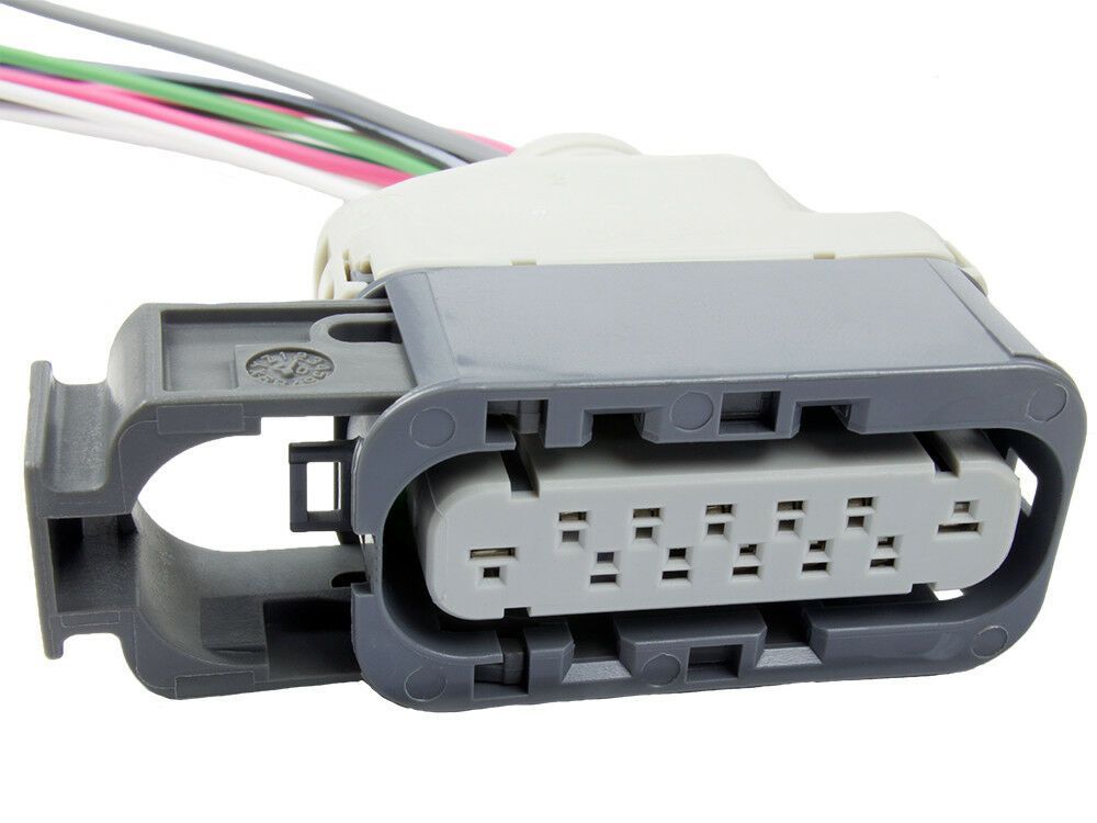

This type of electrical should have 2 locking mechanisms.
There should be one colored plastic lock (that is often missing) similar to the one in this photo:
The second lock is shown in the second photo; on the left side of the connector...
And it pulls out (like shown in the photo) after the colored lock is removed.
Yes. Ok awesome thanks so much. Ya the blue thing is pulled out. Ill pull on the grey u shaped thing next time i get under there. I had a feeling that's what it was but first time messing w this connector and really dont wanna fix anything that 'aint broken.
