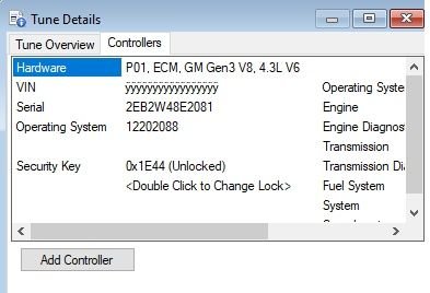

Your tune file or PCM is corrupt.
Every time I've come across a corrupt file it has a y in the calibration details, somewhere. Like your VIN here.
First, WELCOME to the forum.
Next, thank you for your immediate contributions. Impressive catch to notice the corrupted VIN and knowing this indicates a corrupt file.
Not sure if the Trans Revolution/Mile matters because it was reporting a reasonable SAE Speed. However none of us knows exactly what values the PCM uses for various calculations; always best to keep all of them correct.
