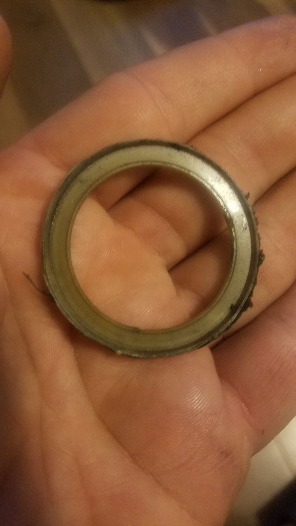

Trying to figure out where this washer goes. I know it's toast.
It feels plastic with some metal on it? I'm in the process of rebuilding. But it was stuck to one of the pieces that came out, and i just wanna figure out where it was to make sure all the replacement thrust washers and everything is correct. Thanks

It's one of the forward clutch hub washers.

Goes between fwd hub and the direct drum.
