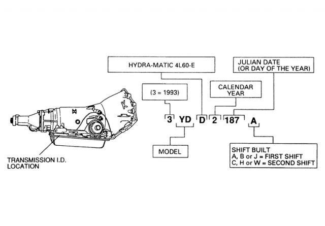

I will need to know the "ID" information that is stamped into the case of your transmission to know how the trans was originally built.
When these vehicles get to be this old... the transmissions usually have been rebuilt by now...
Who knows if someone updated the transmission or not during a rebuild.

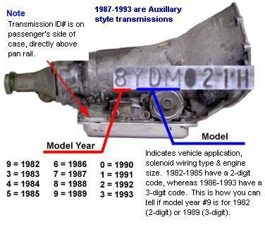

The "ID" information should be stamped into the case near where the tail-housing bolts on.
Just as in the image above... you should be able to view this from under the vehicle.
The transmission cross-member/ mount may make the "ID" difficult to see.
There is also a slim chance that your transmission case has the "ID" stamped on the passenger side of the case instead.
The "ID" would be just above the oil pan, on the passenger side, and towards the rear of the oil pan.
Look at the two images below.
Let me know the "ID" and I will look up the Julian-Date of the build...
We will see if the transmission ORIGINALLY used both solenoids or not.

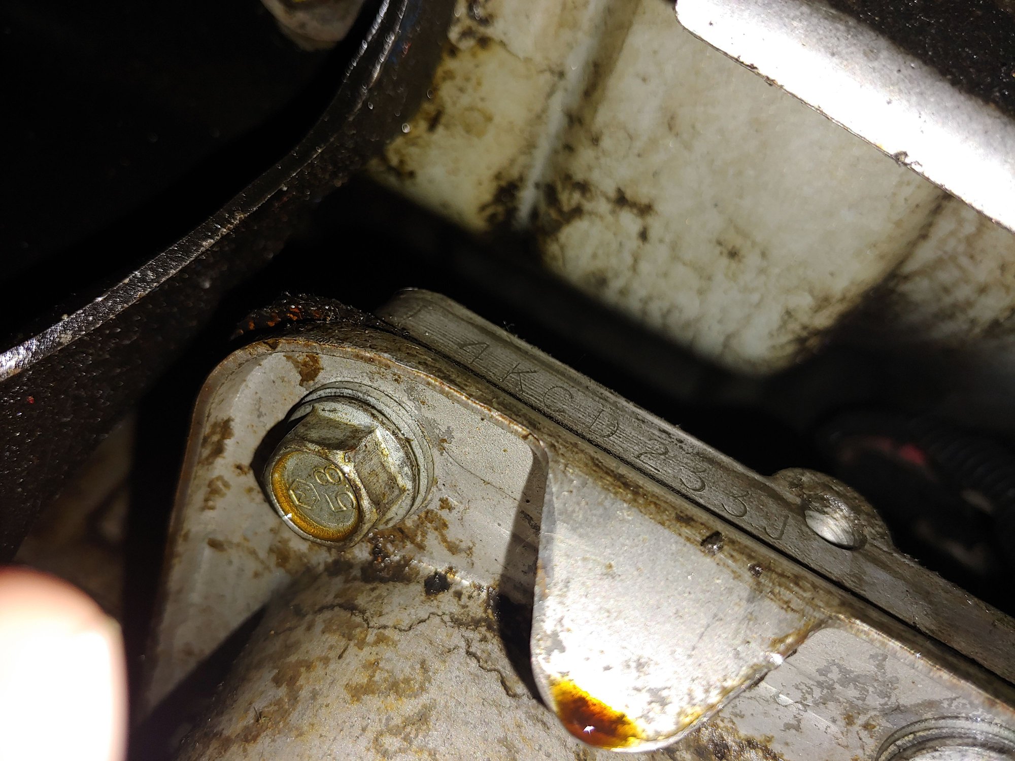

mine was on the passanger side above the oil pan I belive it says 4kcd233j.

Very interesting!
So... There are two things that I did not expect.
I expected that you would have a 1995 transmission that was rebuilt... WRONG LOL!
Okay, so the two things that the ID tells us is:
-It is not the original transmission for your vehicle.
-It is a 1994 unit.
So, originally that transmission would not have the PWM TCC solenoid.
However if the transmission was ever updated... it may have the PWM TCC solenoid.
The transmission should have a bad TCC apply solenoid/ wiring/ PCM.
You will have to troubleshoot/ diagnose this yourself... We will guide you.

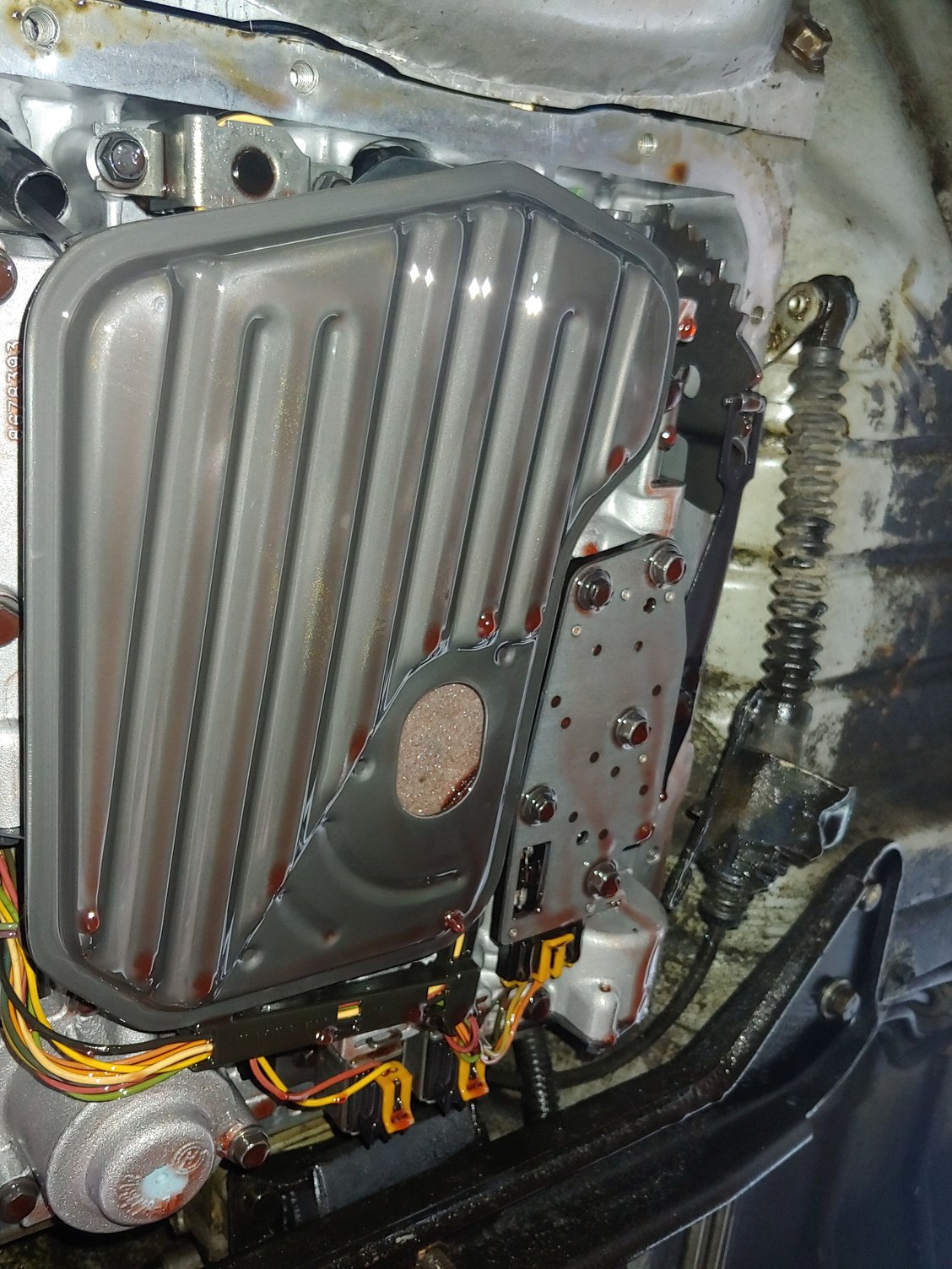

To start:
I would do this with the vehicle/ engine COLD.
If your transmission oil-pan has a drain plug... remove it and drain the oil.
Otherwise carefully remove the oil-pan, expecting to get splashed with ATF.

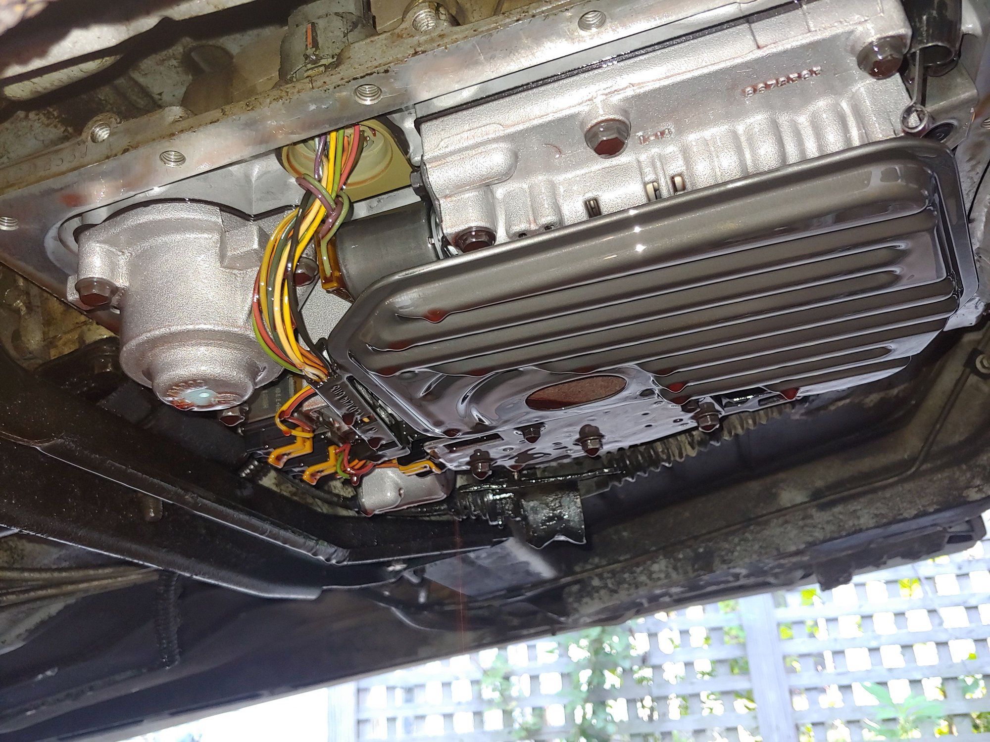

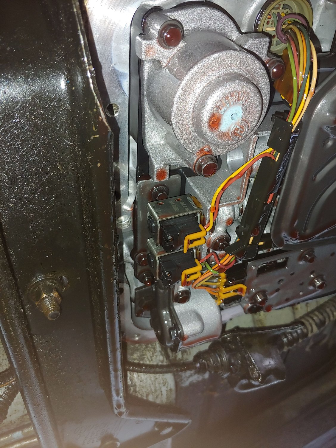

Take photos of the wiring-harness inside the transmission, and the solenoids that connect to the wiring.
Post them here, so we can see what is actually on the valve-body.
I expect to find only the TCC apply solenoid... but we will see if it was updated or not.
We will continue after I can look at the photos.

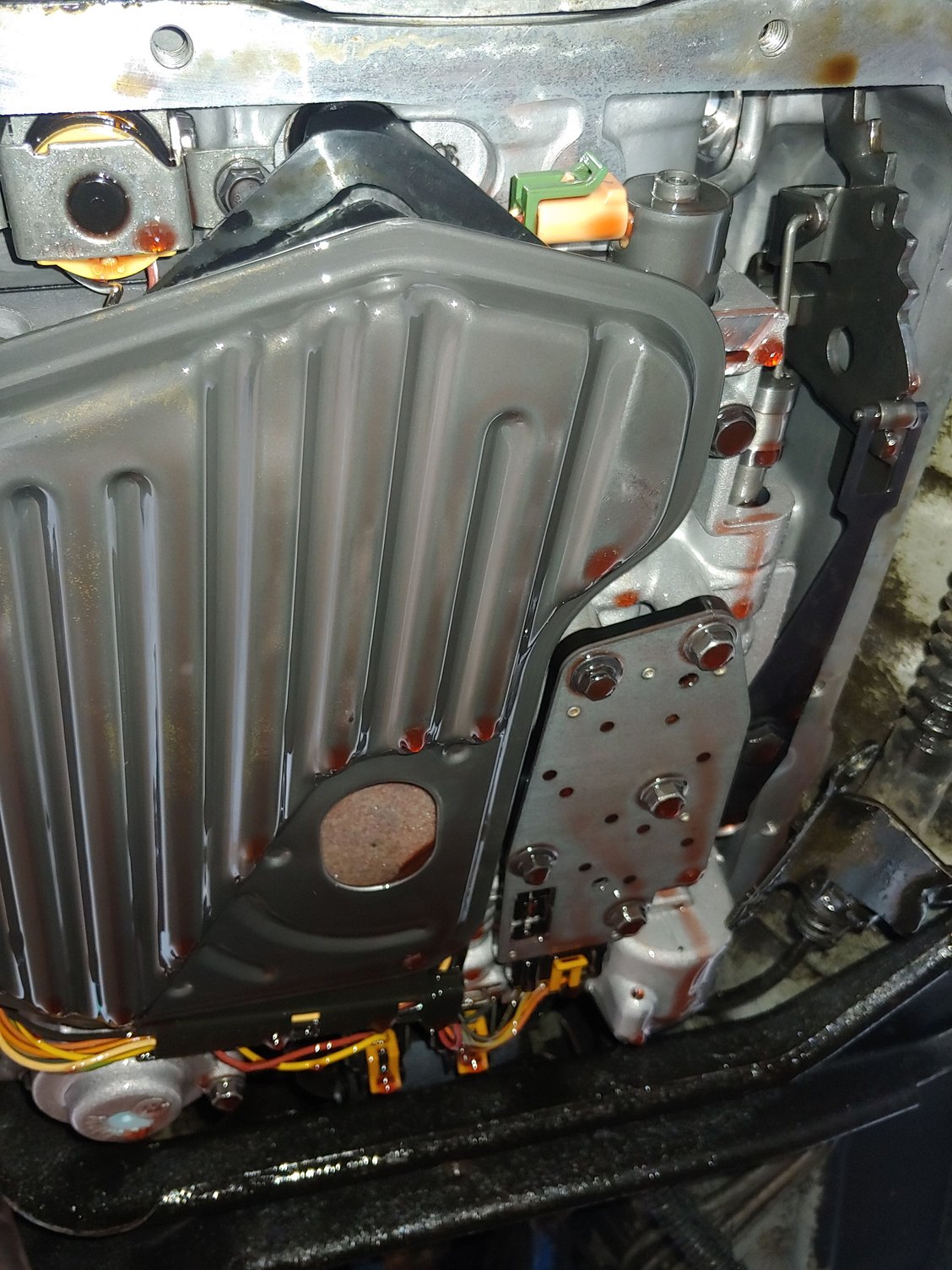

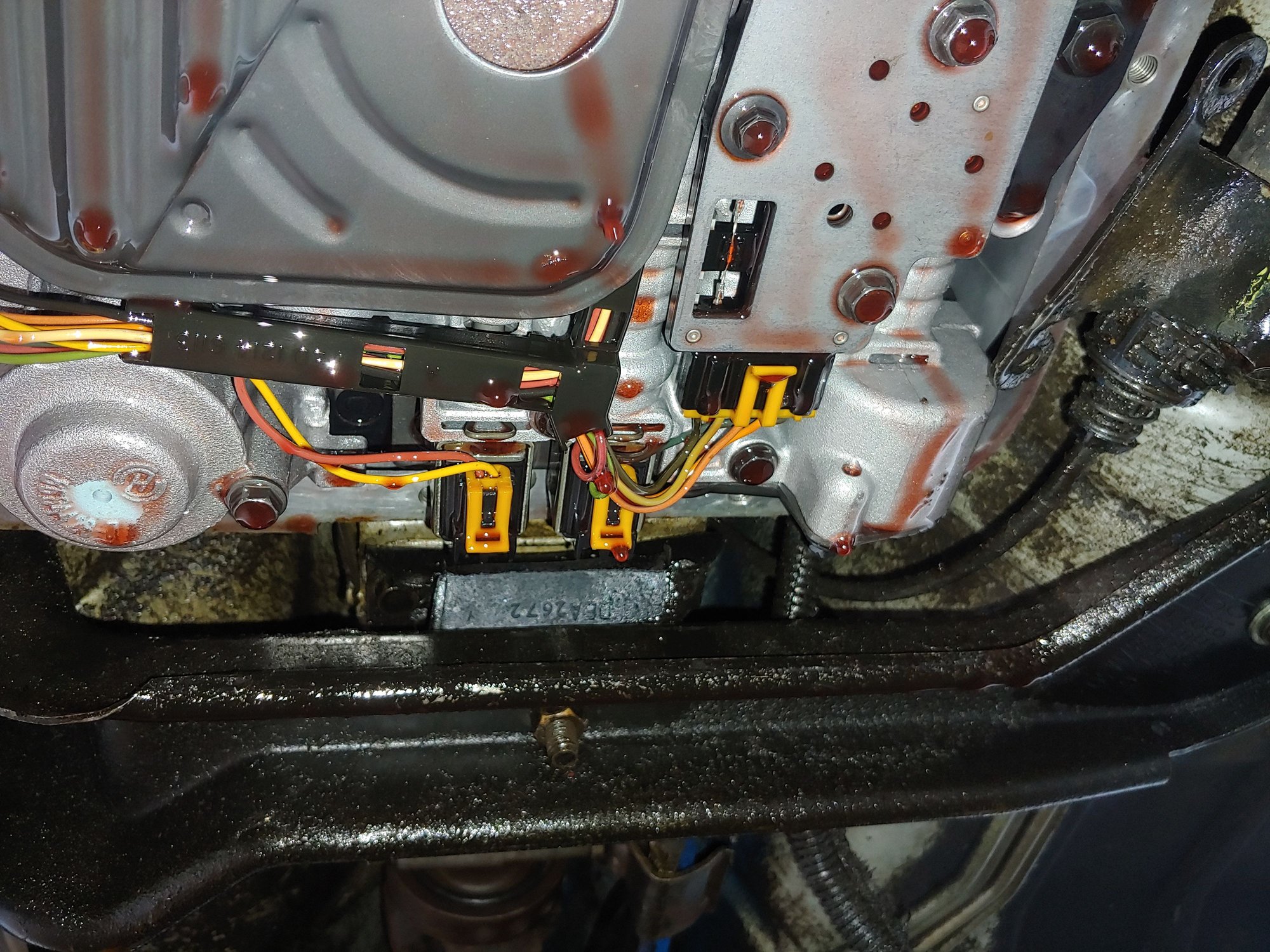

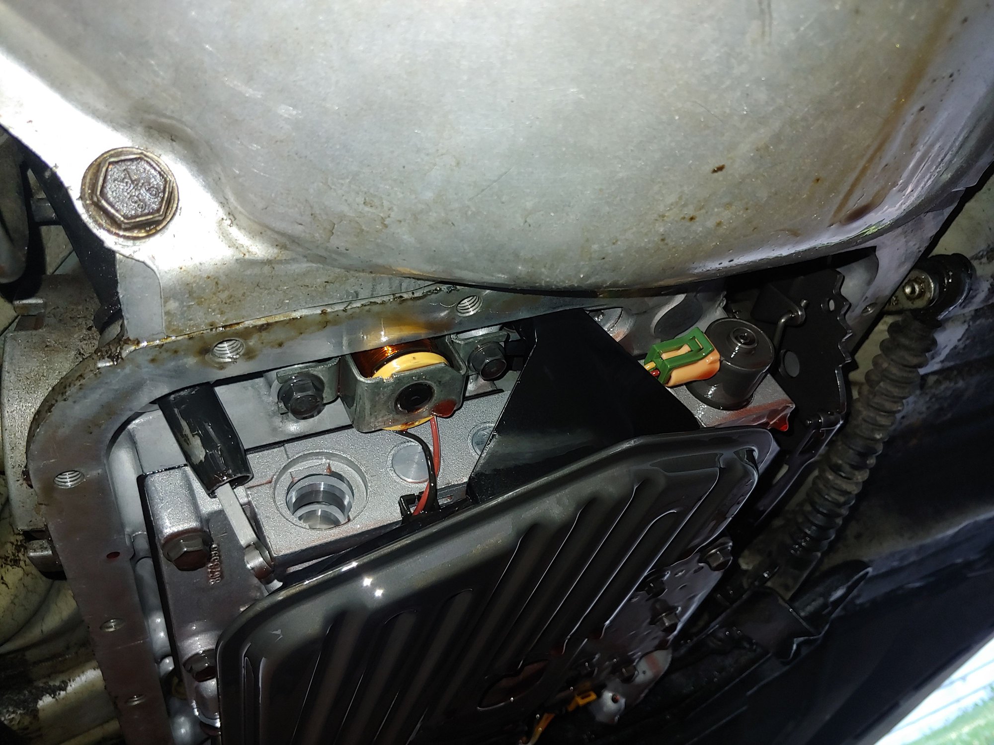

Here are the photos it looks to be fairly clean on the inside so thats a plus let me know if you need more photos or need to remove more stuff.
Old Jul 2, 2020 | 11:01 AM
vorteciroc's Avatar
Joined: Jun 2008
Posts: 3,203
Likes: 1,391
From: Nitro Alley
Okay, so the 1994 unit is still configured as originally.
That begs the question... was the PCM ever changed???
The 1995 PCM with a 1994 transmission is going to look for the PWM TCC solenoid and set a DTC when the solenoid is not found.
Your transmission only has the TCC apply solenoid... the one in the photo of my last post.

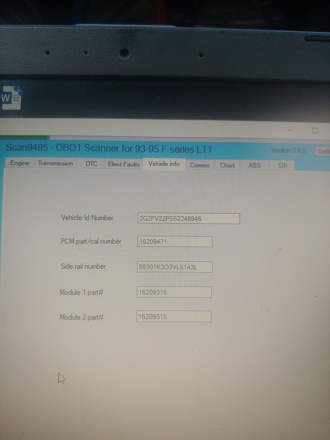

I use scan 94-95 to pull codes and it reads all kinds of other stuff to it tells you the vin and some other info about the pcm as well. I'll take a picture of my laptop screen of what it pulls up.

Here is all the info scan 94-95 provides me for the pcm.
Old Jul 4, 2020 | 07:02 PM
vorteciroc's Avatar
Joined: Jun 2008
Posts: 3,203
Likes: 1,391
From: Nitro Alley
Using the information that you just provided:
-We first look at the last 8 digits of the VIN (digits #10 through #17).
-The 10th digit is the model year identifier for the vehicle; and is the letter "S" (the letter "S" indicates the year 1995).
-The 11th digit is the manufacturing plant for the vehicle; and is the number "2" (plant digits are country specific... we will get back to this later)
-The 12th - 17th digits are the 6 digit long serial number for the vehicle.
-Next we look at the first 8 digits of the VIN.
-The 1st digit is for the country the vehicle was produced in (You have the number "2" which is for Canada. Back to the 11th digit for the plant, which is a "2" and for Saint Therese assembly plaint in Quebec Canada).
-The 2nd digit is for the manufacturing company (the letter "G" is for General Motors).
-The 3rd digit is for the brand of that manufacturing company (the number "2" is for Pontiac).
-The 4th digit is for the vehicle platform/ body line/ series (the letter "F" is for the F-Body car-line)
-The 5th digit is for the model and sub-model (the letter "V" is for a non-base model Fire-Bird; meaning a Formula or Trans-Am and may denote a convertible in some cases).
-The 6th digit is for the actual type of body/ body-style (the number "2" is for a 2 door/ coupe).
-The 7th digit is for seat-belt and air-bag configuration (the number "2" is for driver and front passenger air-bags).
-The 8th digit is for the engine type/ model (the letter "P" is for the LT-1 Gen-II SBC V8)
I am assuming that the VIN entered into the PCM matches your actual vehicle tags/ VIN.
Now the PCM calibration number/ software ID number that you have (16209471) is for a 1995 LT1 with a 1995 4L60E and 2.73:1 gears.
For this reason; I believe that the DTC you have is due to a PCM - Transmission mix-match (sadly on top of this the 1 TCC solenoid could have been damaged as well).
I am not an expert for what I am going to say next...
I believe that you can have your PCM software changed to that of a 1994 F-Body LT1, 4l60E, 2.73:1 gears.
The PCM software ID for this is #16210031.
I do not know if this will change anything with the engine control/ monitoring (we need advice from someone who does know).
So what I would recommend; is that you find a shop that can re-tune your PCM to change it to operate with a 1994 transmission and not change anything regarding the engine.
I personally have never done any custom tuning on these pre-OBD-2 vehicles (Just only OBD-2/ newer vehicles... sorry).
Again, hopefully someone more knowledgeable than me on this can chime in and help us.
