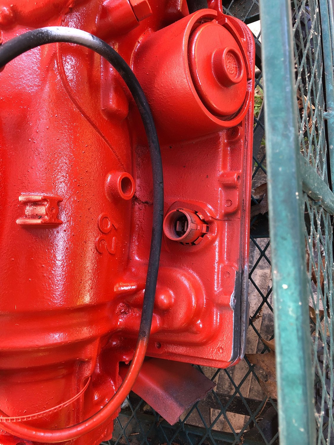

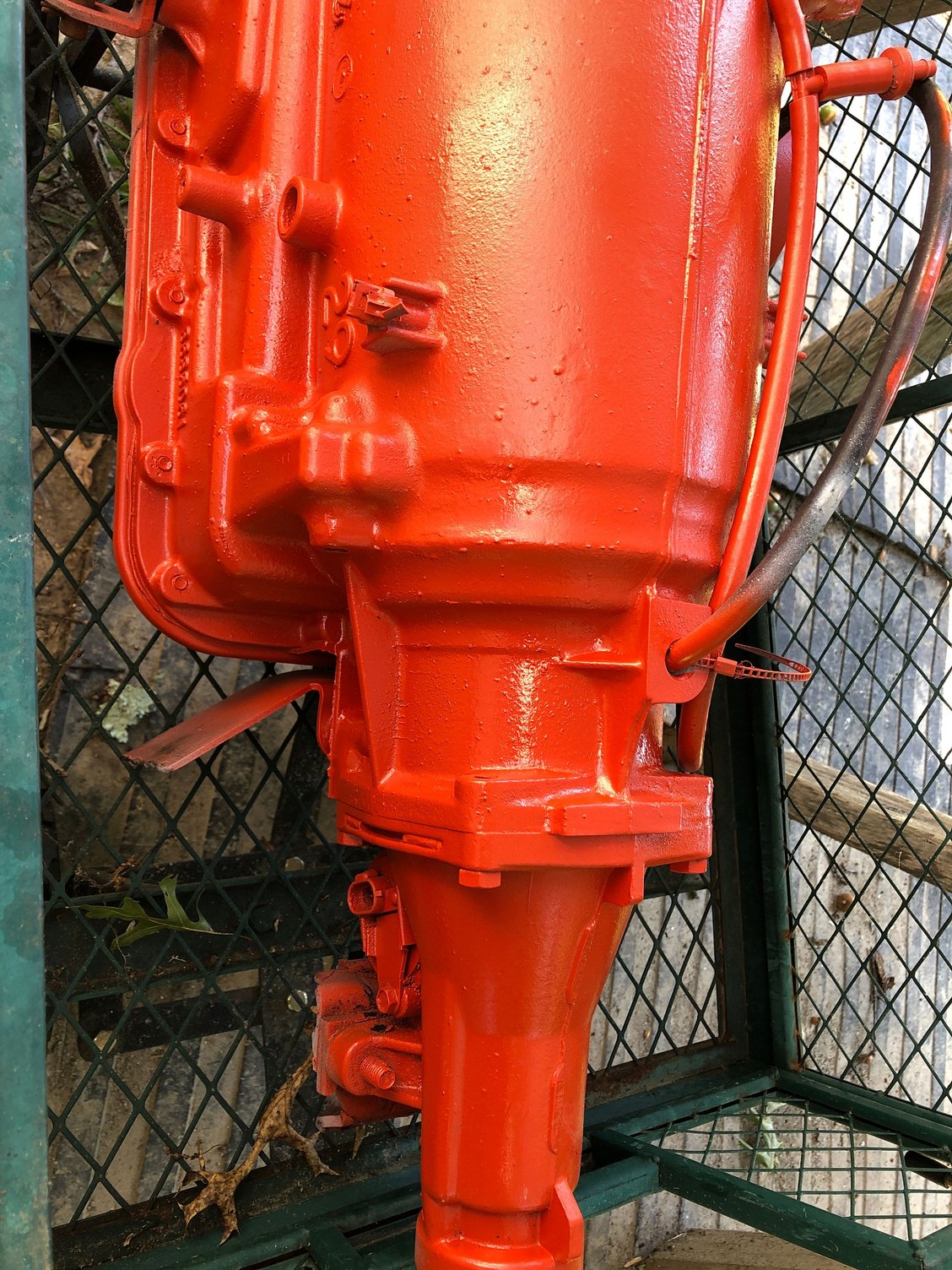

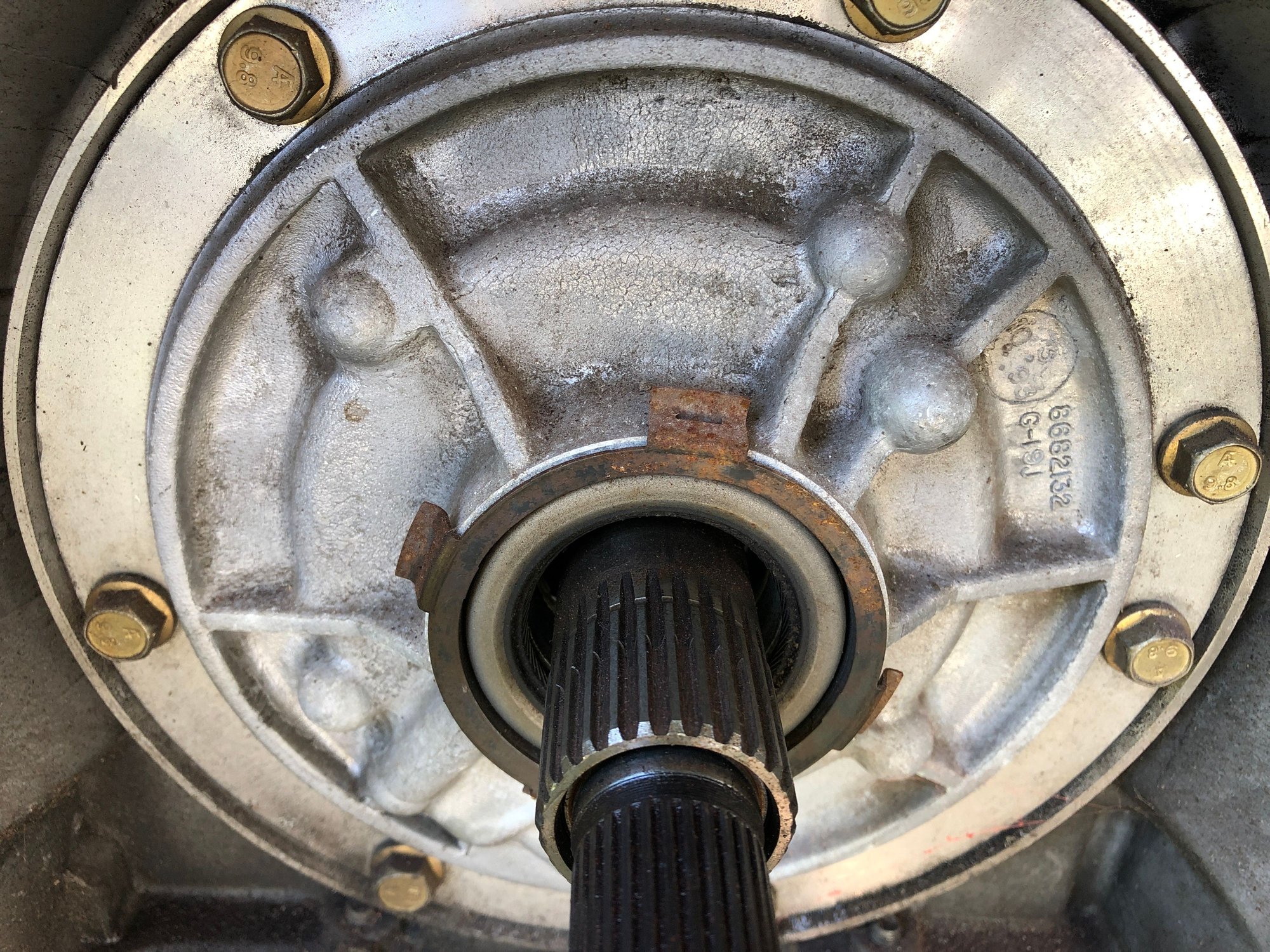

4l60e. Was told it was a rebuilt 96 Firebird, LT1 tranny, but, I’m skeptical. Case number on pan rail: 4BWD299J. VSS connector on drivers side, and no PWM cast on pump cover, however, it’s not the stock pump, it’s a global.
Any thoughts? Thanks

Trans is from a 1994 Caprice/ Impala/ Road Master/ Cutlass Supreme
Should be from a Gen II LT1 or a L99 4.3L V8 (mini-LT1)
