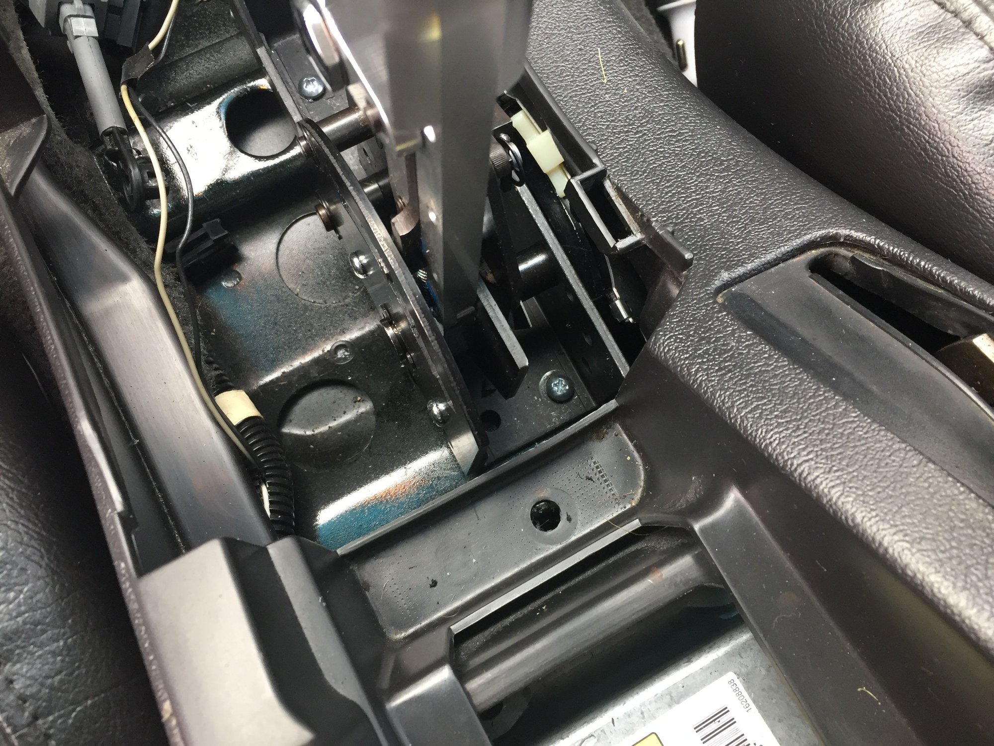

I still have more trimming to do but for now the console and shifter are functional
in my install in a stock auto car I removed everything except for the neutral safety switch off the side of the factory shifter and the one cable. I was able to utilize one of the stock auto shifter bolt and bolt holes which lined up my shifter pretty much perfectly for the other two holes and console top. this was the quick and easy way you could make or use spacers to place the shifter higher and not have to cut so much out of the upper console. for the shift cable hole you will have to move the wiring harness out of the way and use your step bits to make a reasonably sized hole for the cable to fit through (if you take one of the cable ends and remove the larger bolts you won't have to make that large of a hole, I also seem to be getting air through the new hole for some reason hence the recommendation for silicon)

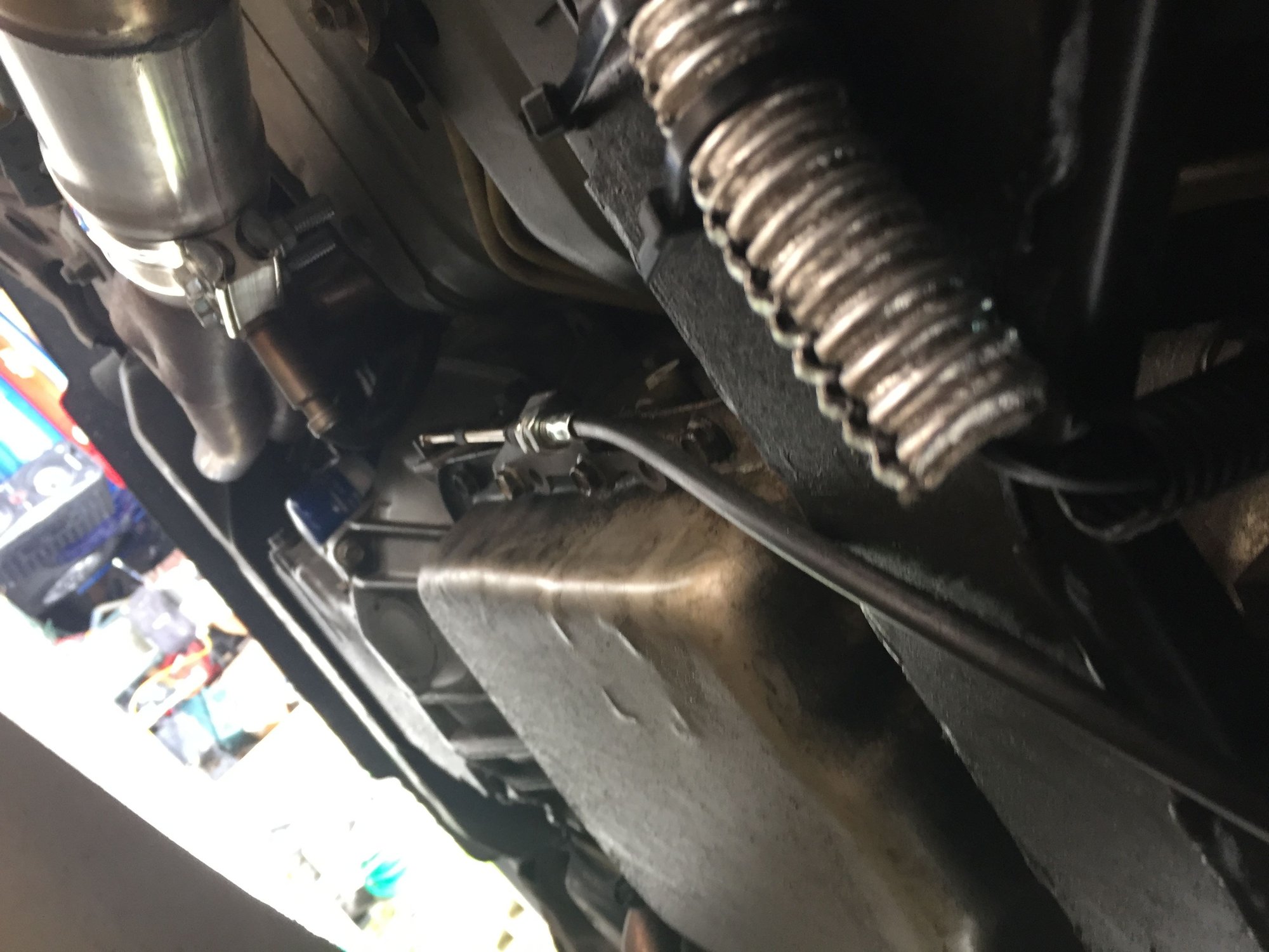

the shift cable comes down the passenger side of the trans and allow you to loop it around behind the trans crossmember. I suppose you could go over but I went under the crossmember and tied it up using a pair of zipties. my cable happened to come down perfectly down the passenger side just sticking it through from the top, your experience may vary and take some simple bending and rerouting.

a picture of the factory bracket bolt location that you WON'T be using
