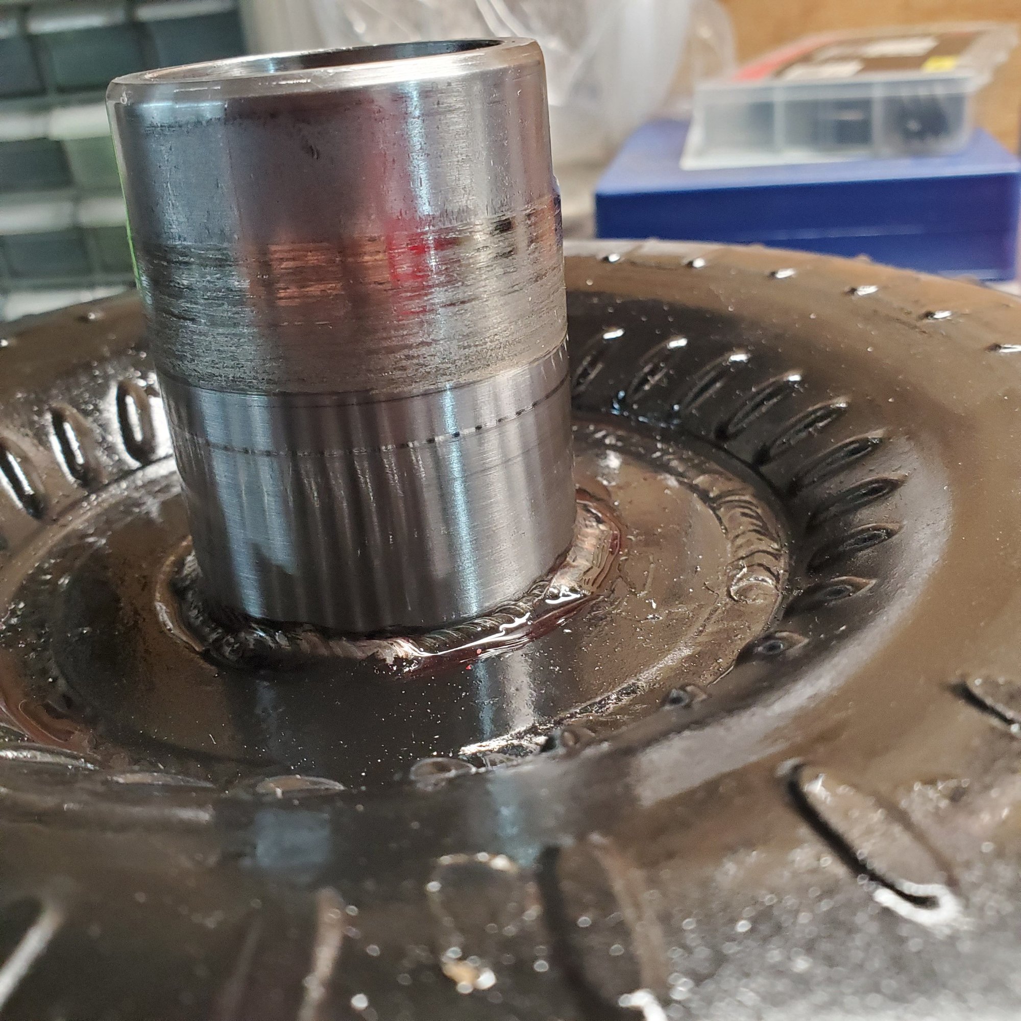

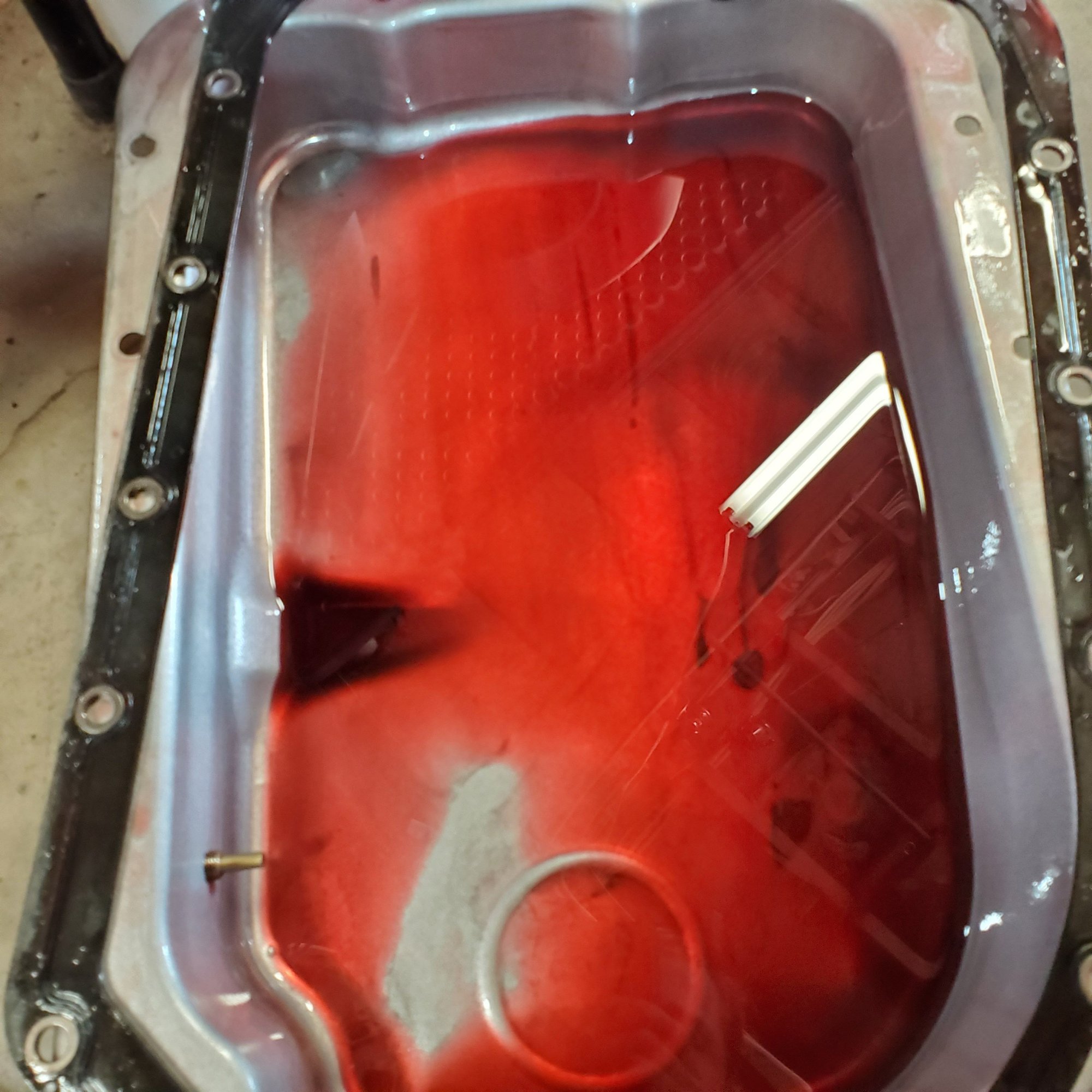

My 4l80e in my turbo car developed a pretty bad leak through the dust cover after using the trans brake. It looks like I need to swap the pump bushing and seal for sure. What's your opinion on the material in the pan?

If it's a fresh trans. That looks like some typical shedding...especially if they were the borg or raybestos graphitic clutches
When you install a new bushing, coat the outside of it in green loctite then consider maybe staking it. I generally don't like staking but if this bushing has walked out of the pump body...you may have to.
Also, drill back the return hole size to 1/4"

Trans has probably 8 or 9k on it. I was on the transbrake longer than I should have been

That hub on the converter will need to be replaced for sure.

Nah, I think he could just get a scotch brite and smooth it out.....
I kid, I kid.....lol

I'll send the converter to Fti for a restall and triple disc conversion. Weather is turning shitty here so I'll probably have the trans refreshed for piece of mind

Agree and if you have a tranny cooler toss it and replace with a new one. I wouldn't chance the cooler with a simple flush.

Don't throw away the cooler. Install a large filter on the return line of the transmission. This will catch anything that comes loose in the cooler or torque converter. If there is a bypass on the oil filter housing that you use here, block it off.
