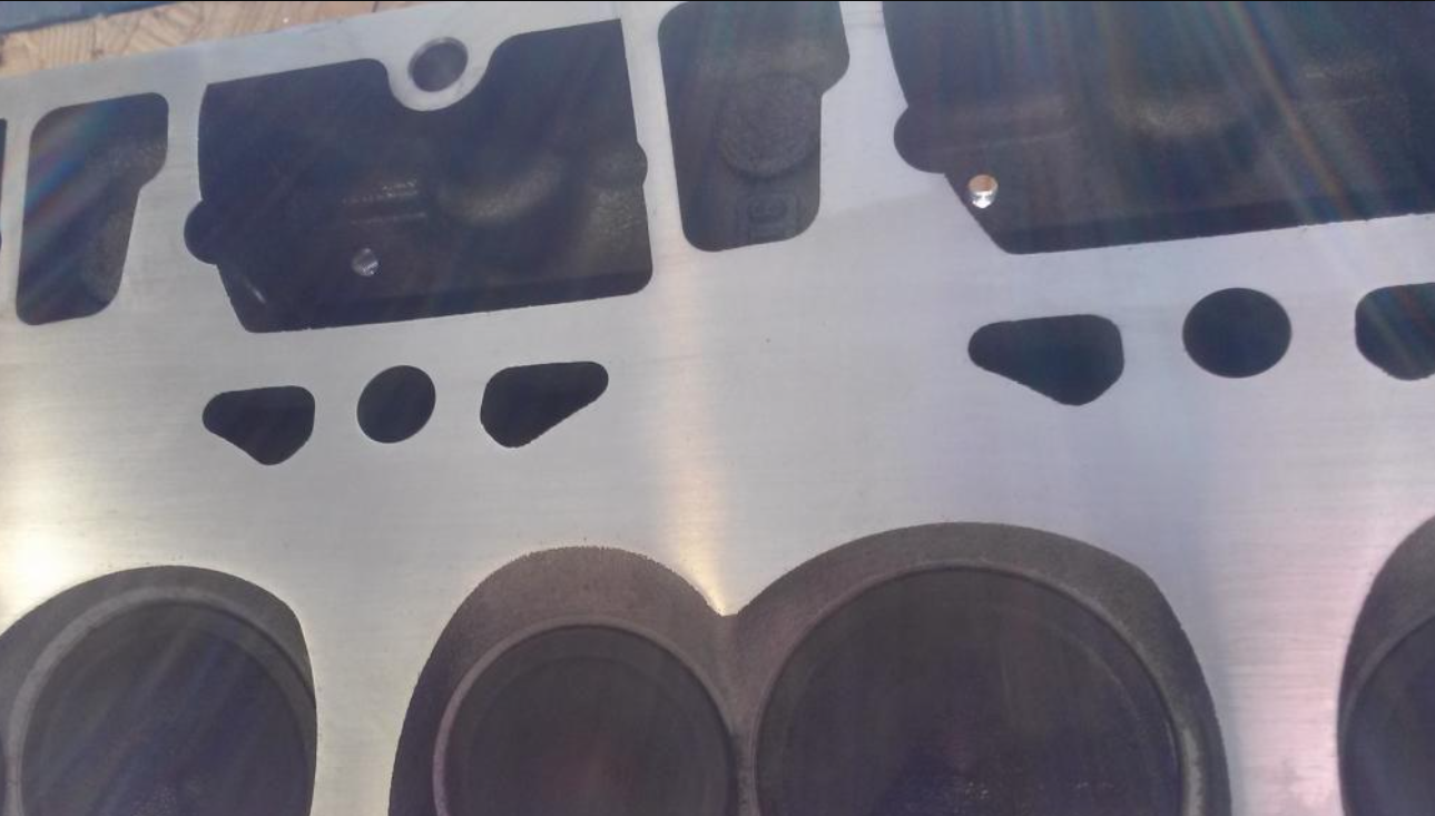

Composite gaskets would seal worse. Get the typical 7 layer MLS BTR sells for the small bore Install dry, no silly copper coat gimmicks, thats nonsense... and prevents proper heat transfer from head to block. Also prevents movement. The HG is upposed to move! Thats one of the main reasons they went to a MLS gasket. Coatings prevent this.
When the heads off do a DIY surface on it or even better take them into be surfaced.
You can DIY block sand the deck too. I use a machinests block and 400 grit. Brush on some Dykem Steel Blue and sand it. Any low spots are very easy to see. Doesn't need to be perfect.
Old thread I did. This surface held 25+ with no issues.
https://ls1tech.com/forums/generatio...k-surface.html

I woudlnt sweat it. Its not difficult just ensure the sanding block is the width of the head/deck. Wet sand with wetsand paper. 400-600g. Use the Blue dykum dye you can see the material being removed easily. If you have a nasty low spot you may need to hit it with 300g or so. Looks amost like a mirror w 600g. WHich is better than the factory finish.
what about the block side?
Old Apr 21, 2026 | 10:13 AM
Forcefed86's Avatar
Joined: May 2011
Posts: 8,478
Likes: 1,022
From: Wichita, KS
Same treatment.

Nah, just the width of the head. Doesn’t need to be the length. You can get alum plate that’s larger if you want a more exact job on the head maybe but that’s overcomplicating it IMO. Doubt you’d have the clearance to do it in the engine bay. Just a simple sanding block, even pressure, and common sense.
