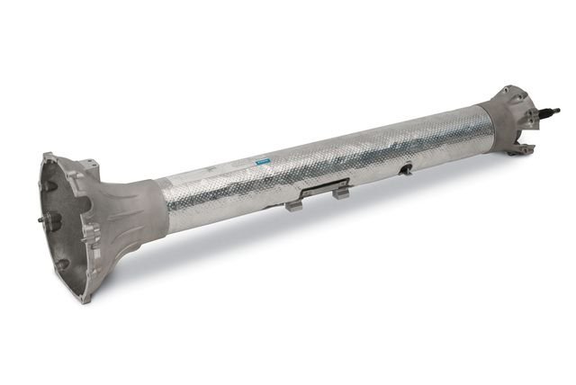

The Bell-Housing ONLY fits a 6-Foot long "Torque-Tube", which the other end of attaches to the rear of the engine (there are no Drive-Shafts used).
Torque-Tube:
The Output-Shaft ONLY fits into that Differential (making the assembly essentially a "Trans-Axle" instead of a Transmission with a separate Rear-Differential).
