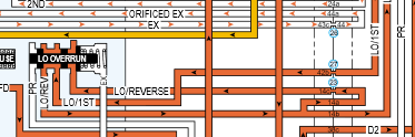

The Orifice hole furthest to the upper right corner (that says drill 0.0930") is for the Low-OverRun Circuit (42B/ #27 Orifice).
Fluid here will go to the Low-Reverse Piston for Manual-1st Gear.
