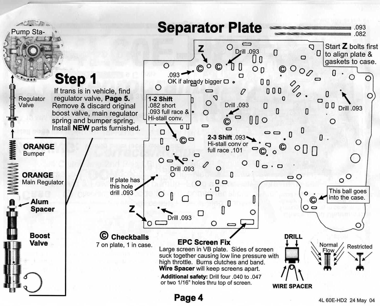

I noticed after installing my transgo hd2 shift kit the trans does what I can only describe as a double downshift, it seems to do a mild downshift before doing the main downshift. Is this normal? I actually like how it does it but not really sure if its meant to happen but it must be normal because I 100% did everything as perfectly and methodically as you could possibly do it.

Is this occurring from 3rd gear to 2nd gear?
Which Servo are you using for the band?
What is the Band clearance?
What is the 3-4 clutch clearance?
What is the 3rd Accumulator orifice size?
What is the 3rd Exhaust orifice size?
I'd say it happens from 3rd gear to 2nd gear yes.
Never touched the servo because I had no access to it so skipped that part. Servo is stock. And didn't touch the band clearance either.
Not sure what you mean by the 3rd accumulator orifice size are you talking about the separator plate hole sizes?
I just installed the kit exactly as the instructions said. Also installed the transgo hardened separator plate, all new solenoids (except epc), and a new pressure manifold switch (updated design with white plastic on one side)
Everything was installed very carefully and double checked, nothing was rushed or forced. The kit was installed with transmission still in vehicle.

I've got another question that i'd appreciate if someone could answer for me, when I was drilling separator plate holes my instructions didn't say to drill this hole in the top right corner but everyone elses instructions shows to drill it. I assumed transgo has modified their kit or maybe i got dud instructions? can post picture of my instructions it has no mention or arrow pointing to that hole
