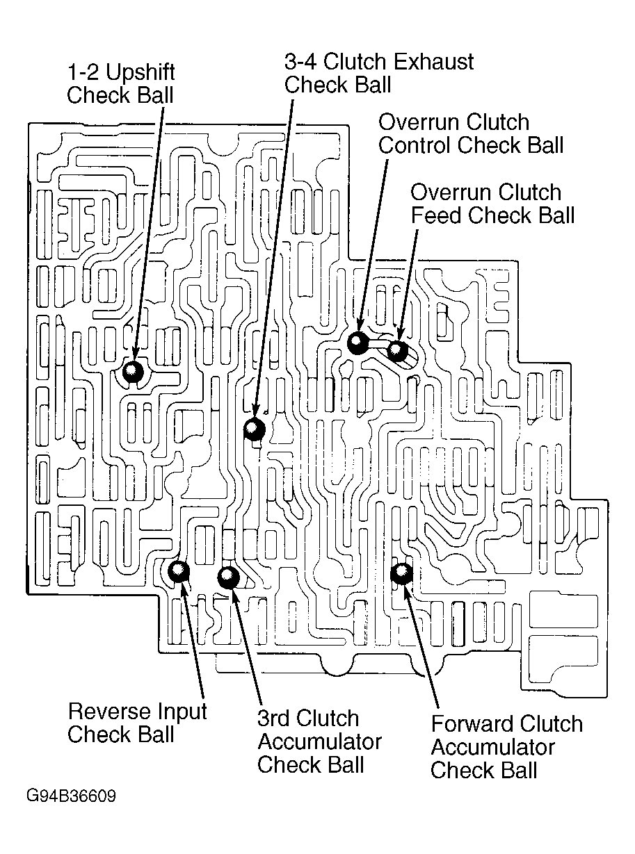

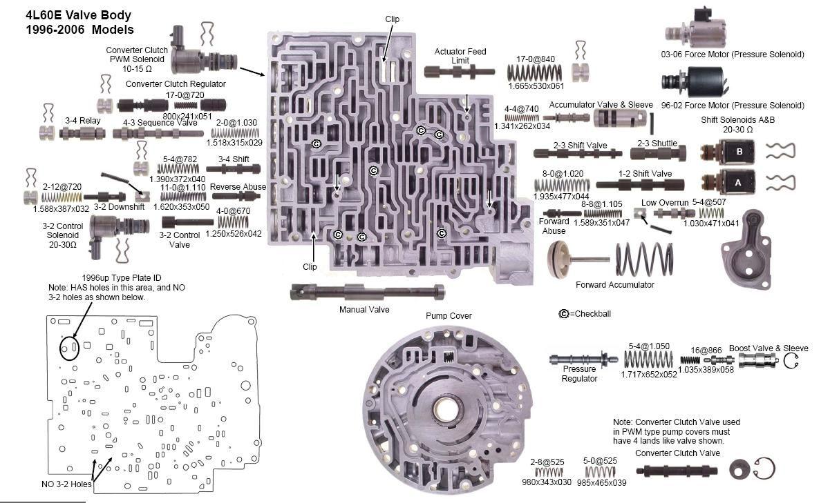

First off, I have decided to get a plate…
Does anyone have an ACCURATE diagram of the checkballs for the separator plate and their functions?
The only one I found seems to be inaccurate and the others I have found only give numbers without descriptions or only point one to two *****.
Is that number 8?
https://www.sonnax.com/tech_resource...i-check-valves
What about using the Transgo plate that is supposedly a made from a stronger steel instead of a Torlon/ Imidized Check-Ball?

Thanks, I had found the first diagram u posted before and had thought it was incorrect mostly because I was misunderstanding some other documentation.
Again regarding the 1-2 upshift check ball, looking at the circuit and the description and what I have been told this ball can be eliminated.
I am fairly confident in stating the having this ball stuck or busted through will cause significantly more damage than no ball.
I am missing something?
Anyone ever had a build without this ball? If so, was there simply some sluggish shifting?
Anyways, like I said, I am just going to replace the plate. I don't like the looks of it and not crazy about the condition of the gaskets

So I am just going to say:
Pretty much every question that you can think of, someone else had already thought of, and tried.
People were trying to do away with that Check-Ball in 1982 with the THM700-R4...
With everything configured for a Performance Auto. Trans...
You will rip the Anchor right off of the Stock 2-4 Band ( as well as other damage) after enough shifts (especially with no Accumulation, and without a very high-stall speed Torque-Converter).
I like to try and be helpful when I feel it is warranted...

Ok installed the transgo replacement plate (which didn't come with gaskets so I reused the old/like new ones).
I now have 2th and 4th!
The vehicle runs excellent except for one concern:
If accelerating moderately to excessively, it slips from 2nd to 3rd for less than a second. And by slips, I mean the engine revs up about 500-1k RPM then settles into 3rd.
On slow acceleration, it shifts flawlessly.
