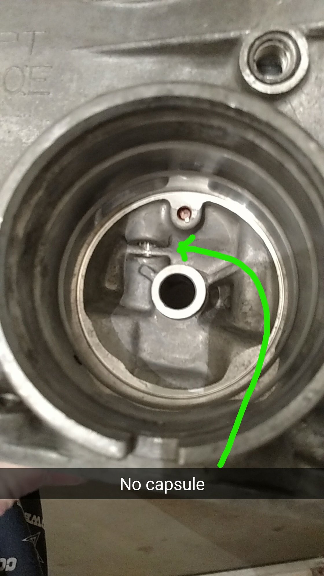

Before I started doing my own transmission I had my 4l60e done at a shop do this. I undid it and the shift timing is much better. The timing and band clearance was so out of wack from the shop compared to were I am now.
They also had the Sonnax servo release check valve and that went bye bye too.

No Third Accumulator Capsule... just a hole...
and then the Sonnax Check-Valve?
Wow! Great 4L60E work done at that Shop.
