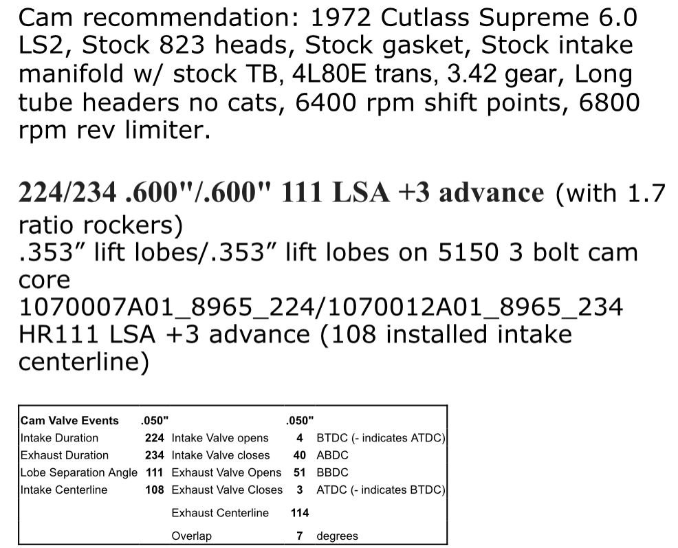

what size stall would you recommend for my LS2 engine? Build specs in the photo…

What is the weight of the car?
tire size?
estimated HP?
any power adders?
Transbrake?
How are you driving it?(daily, race only, street/strip)
