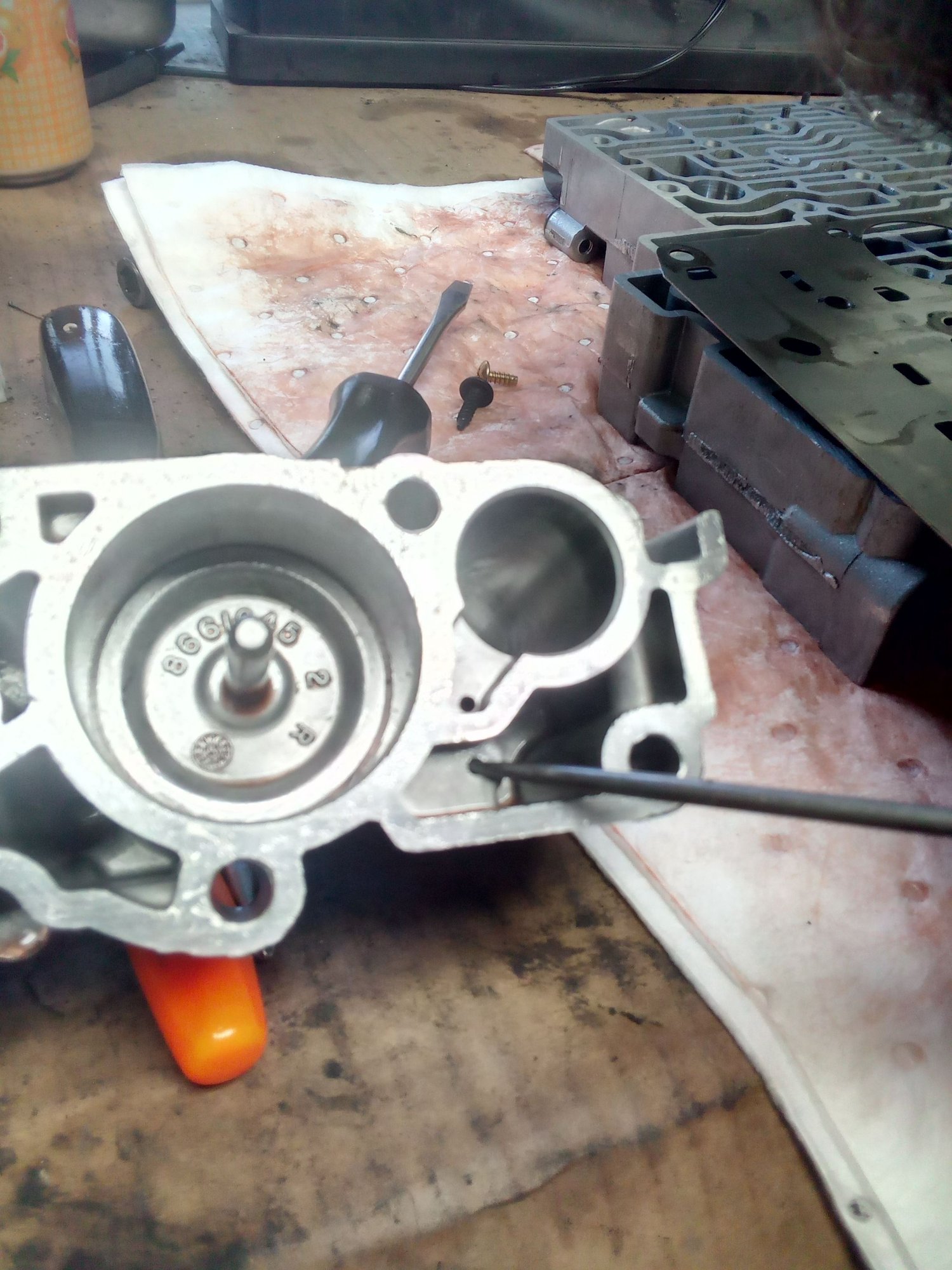

Removed valve body tonight. Very little debris in pan was pleased. Has had a Transgo SK-4L80E installed. Has the pressure relief valve, which I will get rid of. Stock separator plate is beatup, will be getting new 94+ separator plate and torlon check *****.
Few questions:
-Transgo has you change the accumulator valve springs. I have a stock one from a '07 express, should I swap it or keep the transgo?
- With the Sonnax LB1 boost valve, I read to use stock springs as the extra pressure isn't needed until high HP. again, I have stock springs from a Express
- Being a '92, this has the PCS valve in accumulator housing. I will be using a '94+ separator plate, can i leave this valve&spring out of the housing. should I just source the newer style housing and be done with it? EDIT: the PCS has been updated to the newer style.
- blocking 4th accumulator, is this something that should be done on ALL builds? As mentioned HD work truck with towing in the future. I assume if blocked i should go conservative on shift hole size?
Do not use the TransGo Pressure-Relief Valve.
When installing a new Valve-Body Separator-Plate with new Torlon Check-*****...
You must make a new Seat in the Separator-Plate with an old Steel Check-Ball for every Check-Ball location.
Otherwise the new Torlon Check-***** will not seal well.
Yes, use the Stock Pressure-Regulator Valve-Spring with the Sonnax Boost-Valve and Sleeve.
No additional Line-pressure is needed.
I am not very familiar with the TransGo SK-4L80E parts Set...
Unlike the 4L60E, the TransGo Sets are not commonly used by Transmission Builders that specialize in High-Performance Automatic Transmissions.
Obviously I know that you are looking to build a Higher-Performance Unit for a "Work-Van".
I believe that you are referring to "accumulator valve springs" as the two different Springs that TransGo provides for the Accumulator Valve-Train...
and NOT for the Accumulator Piston-Springs.
The Accumulator Valve-Train for the 4L80E is configured so that a firmer Spring makes the Shifts softer...
and a softer Spring (or NO Spring) makes the Shifts firmer.
I personally would use the Stock Accumulator Valve-Spring.
For a "Work-Van" or Truck that does towing...
I would keep the 4th-Accumulator active, unless you are going to have the Tune edited.
Without the 4th-Accumulator, using the Stock Tune...
A damagingly harsh Shift can occur from 3rd-Gear to 4th-Gear while the Torque-Converter is locked.
This can be prevented by editing the Tune; and then you can omit the 4th-Accumulator.

Doug, if you are leaving the accumulators do you use stock springs?I kept the original 3rd accumulator spring from the Express which appears to be the 24200436 judging from the remaining paint on it. The current 3rd accumulator has a long spring. Looks like Sonnax makes a more durable version of the most current GM spring 24200436. The 4th spring is blue, looks similar to the current Gm 8675634 spring.
​Also, do any of you use the Sonnax shift valve springs? Any benefit to them?
It looks like I can leave out the TS compensator spring and piston when going with a 94+ separator plate, but I will be retaining the early accumulator housing, I will have to check that no separator plate holes are feeding it before I do this.
EDIT: Looks like i have to block a passage in the accumulator housing if I use the early accumulator housing.

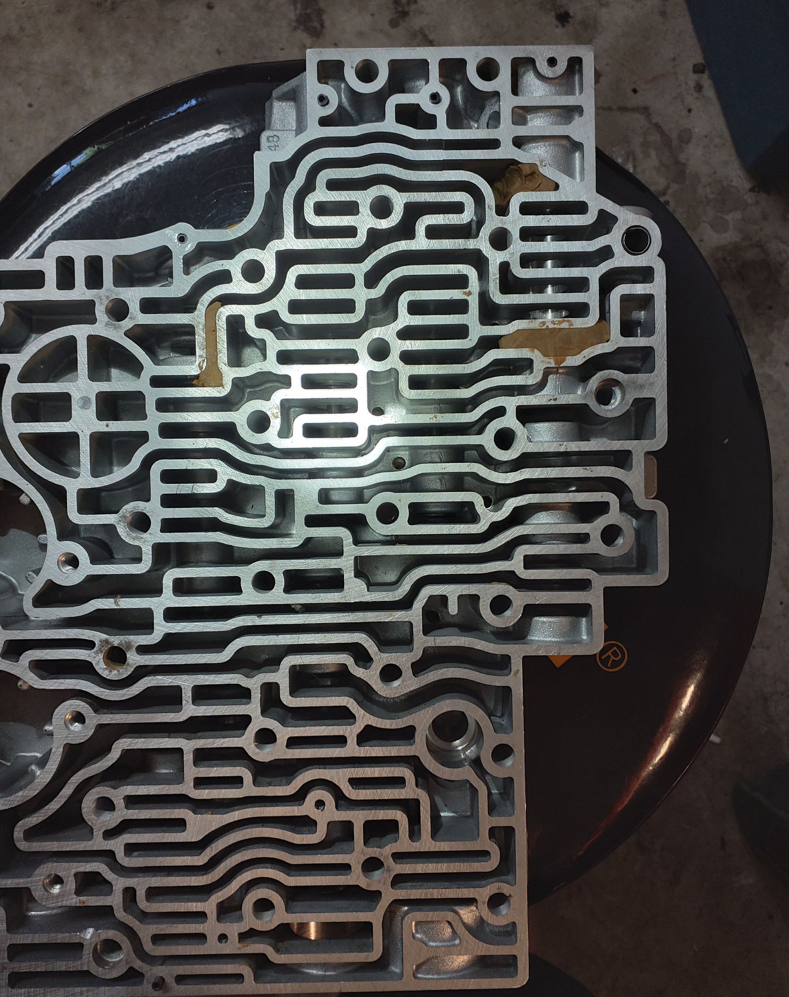

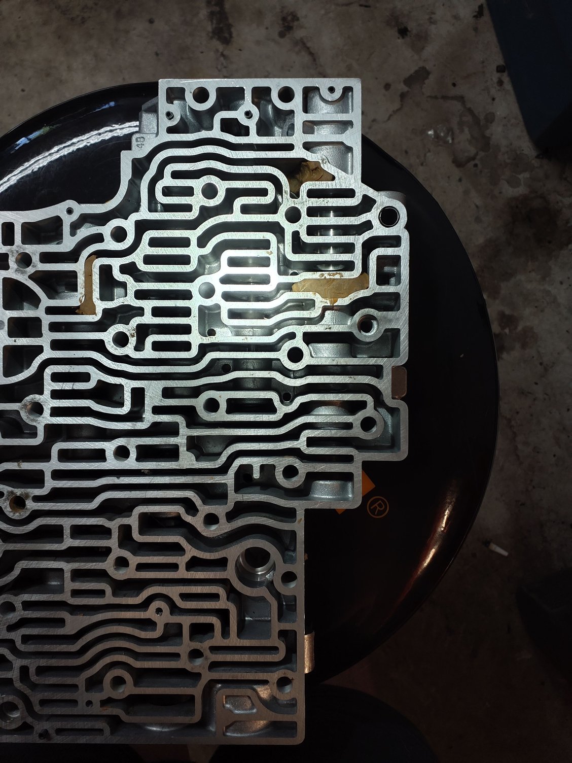

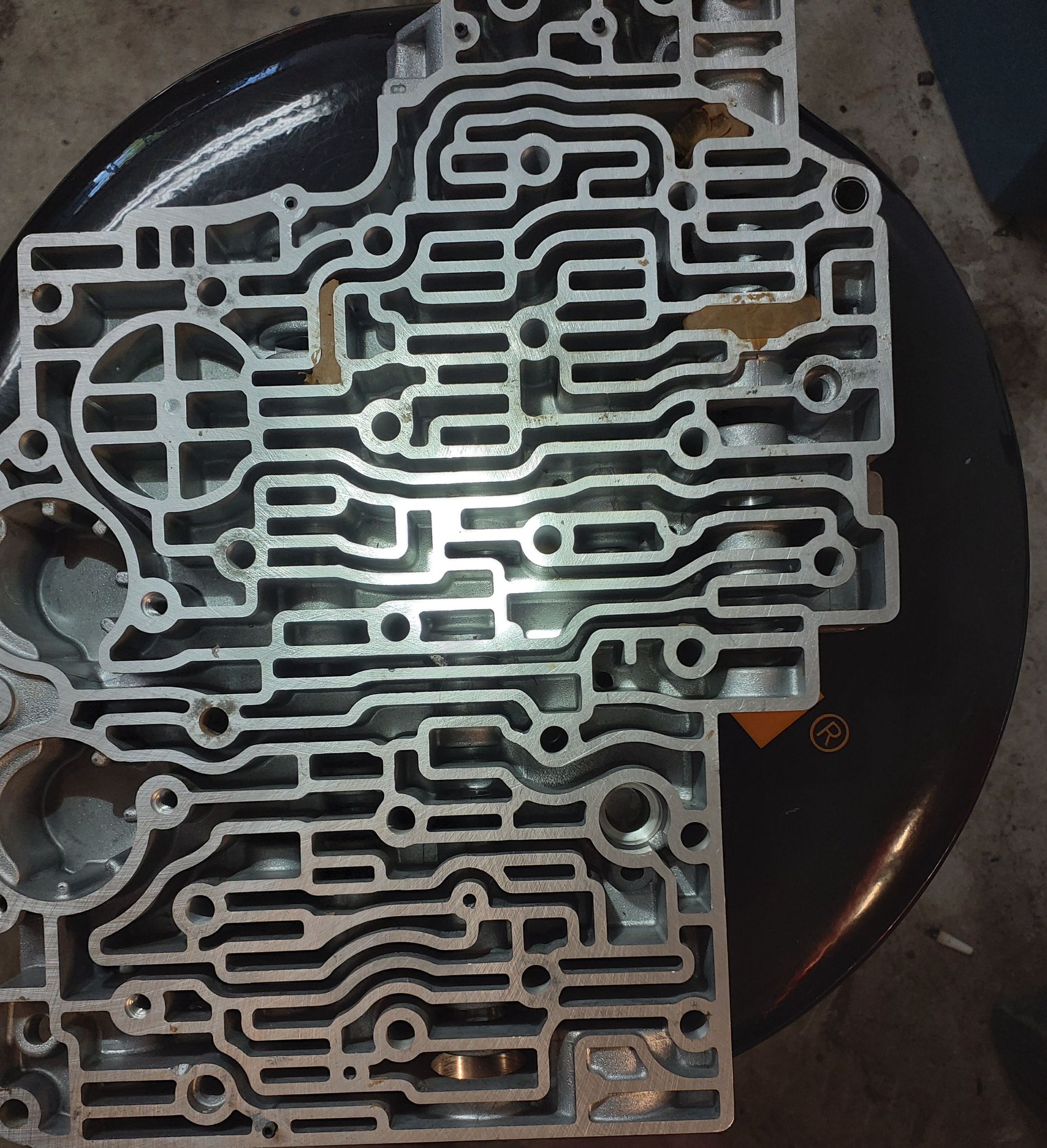

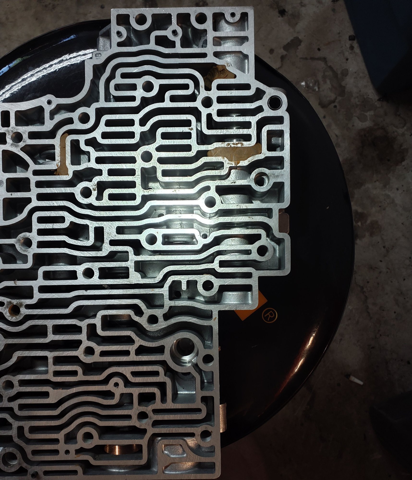

I got my DIY vac tester together this afternoon, once I figured out how to calibrate it I used the Sonnax guide.... https://www.sonnax.com/tech_resource...uum-test-guide
3rd/Reverse checkball sleeve
inboard: 25"
outboard: 22"
3-4 shift valve: 19
2-3 shift valve
inboard: 18.5
outboard: 12
AFL filter: 0
low/reverse checkball
inboard: 25
outboard: 9.5
1-2 shift valve
inboard: 18
outboard: 16
TCC regulator valve
inboard: 24
outboard: 21
AFL valve: 23.5
Accumulator Control Valveinboard: 12.5
outboard: 15
The AFL filter has been modded per transgo, where you remove the o-ring and install the tapered plug in the bore. Last builder really hacked up the filter so I will replace along with Sonnax kit. Every thing else is repairable but I am worried about the 2-3 shift valve and to some extent the 1-2 shift valve even though it passes (I think).
EDIT: for my vac tester only had a 0.034" drill bit for my calibration "plug" not sure if this is a big deal or not...

Regarding the 0.034" Air-Bleed for the Vacuum-Pump... what is the highest reading attainable?
Could you Post Images of how you are performing the Vacuum-test, for the locations that were only capable of pulling a low Vacuum-Reading?
Generally the AFL and TCC Valve-Train show the worst results...
However, the other Valves can show sealing issues as well (which may be the reason for the lower Vacuum-Reading that you found).

Regarding the 0.034" Air-Bleed for the Vacuum-Pump... what is the highest reading attainable? 25" to 25.5"
Could you Post Images of how you are performing the Vacuum-test, for the locations that were only capable of pulling a low Vacuum-Reading? Let me know if these files help. Valves were fully assembled and installed dry. Recalibrated vac tester this morning and got similar results.
Generally the AFL and TCC Valve-Train show the worst results... yes this is what i was expecting as well. FWIW, these 2 valves are originals. not "oversized" transgo or sonnax valves.
my answers in red
