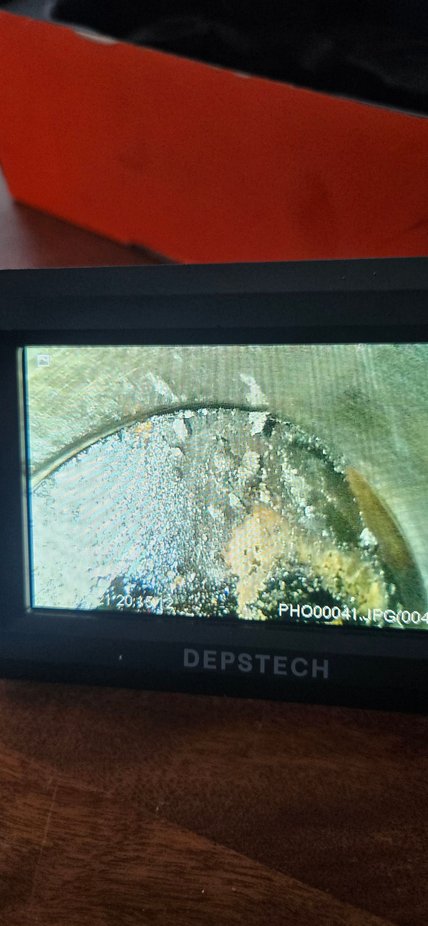

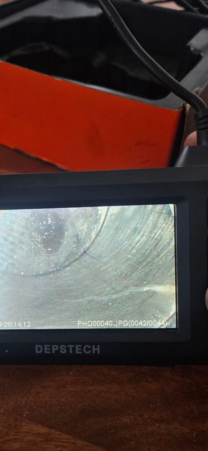

I dont have much for pictures right now since i bore scoped and only took a couple pictures of the damage in cylinder #7.
I agree that 10.3 was on the richer side but after I wrecked a piston the first time because of what I thought to be a lean condition I figured why not give it some more fuel.
I had checked the plugs after the tuning was complete but this is my daily so i dont pull them often, specially since its a real pain to get the back 2 passenger ones out. I do have some data logs on the laptop I can post when I get home from work.
cylinder #7 with hole in piston around 7 O'clock position.
cylinder #7, looks to be dried up coolant that had drained down the wall.
Cylinder #2 with flakey black residue, All of the passenger side cylinders has this.

Hard to say that's a hole from the pic. But if anything it looks cracked with a piece blown out. Doesn't look like ring butt, or torched. It looks like some of the cylinders were burning some oil maybe. I bent my first rod by lifting a head and getting water in the cylinder. Strange things happen some times. Get it ripped apart and let us know, but definitely flow the injectors, upgrade the alt and get a bigger pulley. Shitbox supply has them also

I am sure hoping I didn't bend any rods, It is hard to see what that dark spot is in those picture so I will get the engine apart and get a better look at the damage. Ill post pictures to keep this thread updated.

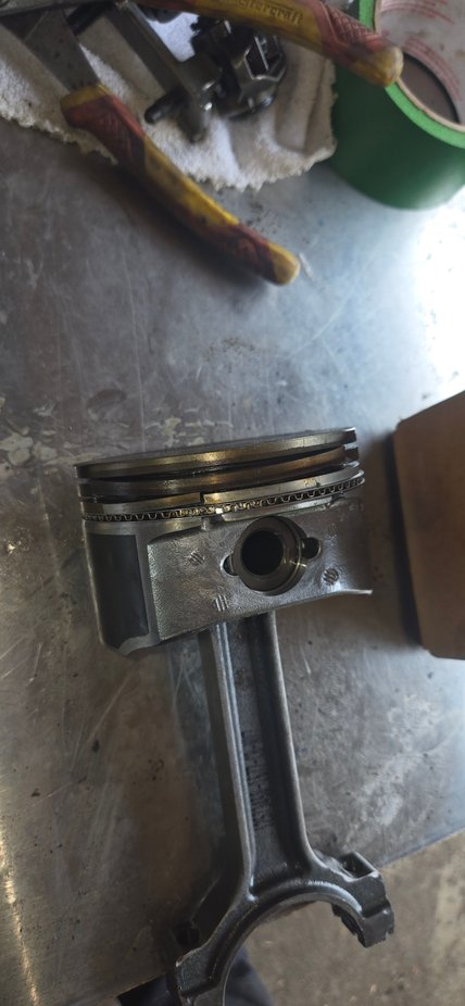

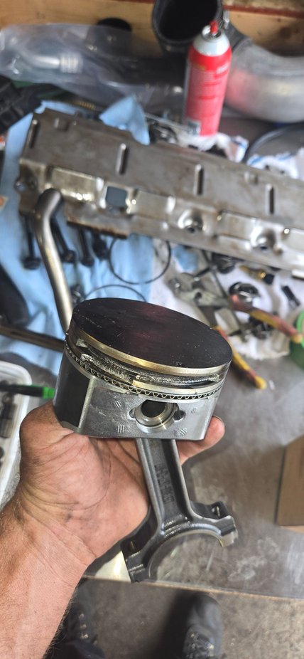

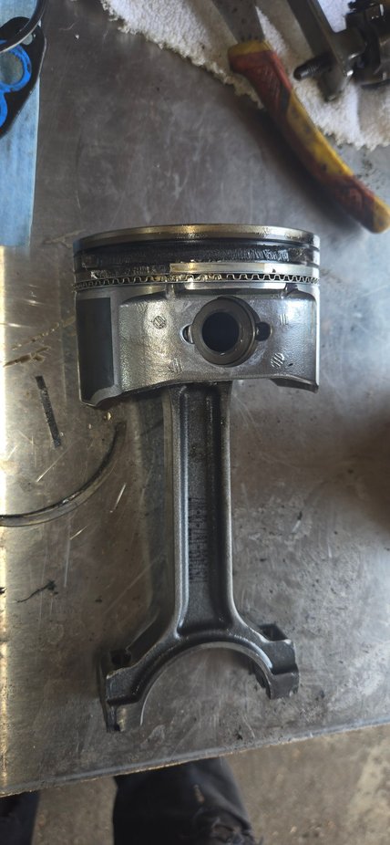

Once you have it apart it might be more clear if the piston cracked due to detonation, or is showing heat related damage.
You might have covered it already, what did the first #7 piston look like?

These are the pictures of the previous piston from cylinder #7
