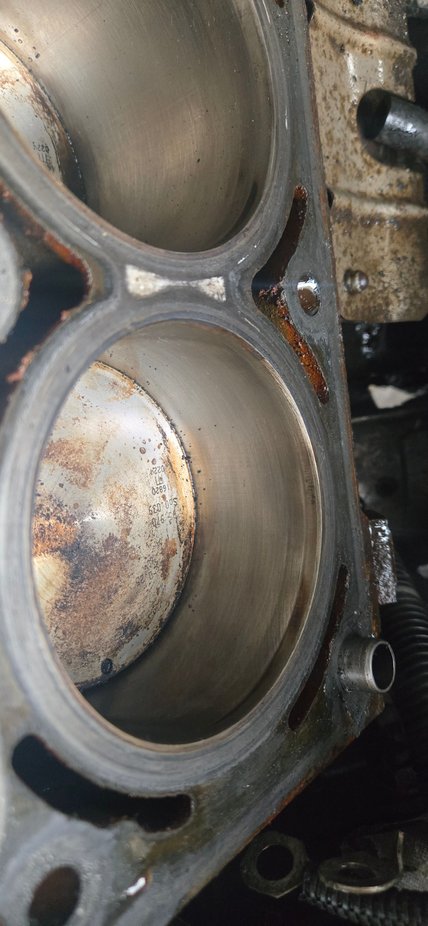

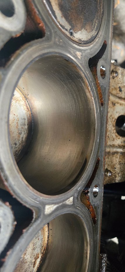

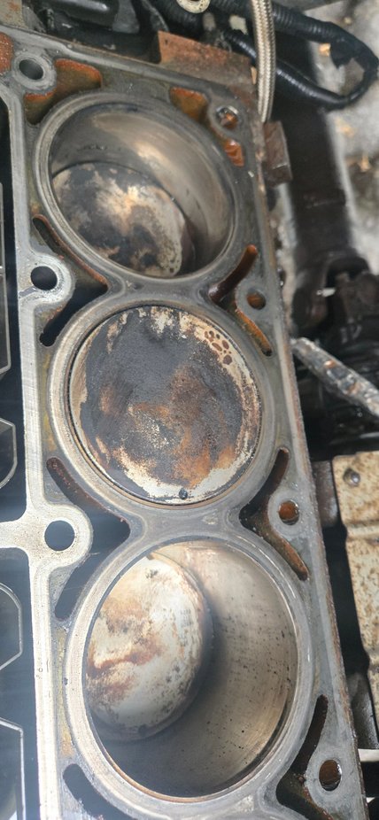

The weather got a little warmer so I finally pulled the intake and driver side cylinder head.
Found more oil than i expected around the intake gasket and to my surpise the pistons and cylinders cleaned up fairly good with quick brake kleen and rag. Im wondering if I blew the turbo seal and it was sending oil through. The catch can only had what looked like water with a tiny bit of oil on the top.
Valves look good at a quick glance but i will get them looked at.
There is no hole in my #7 piston like I thought with the crappy bore scope picture. The ls9 small bore headgasket was very wavey when I pulled it off.
It was getting a little chilly again so I gave up and will have to do some more investigating.

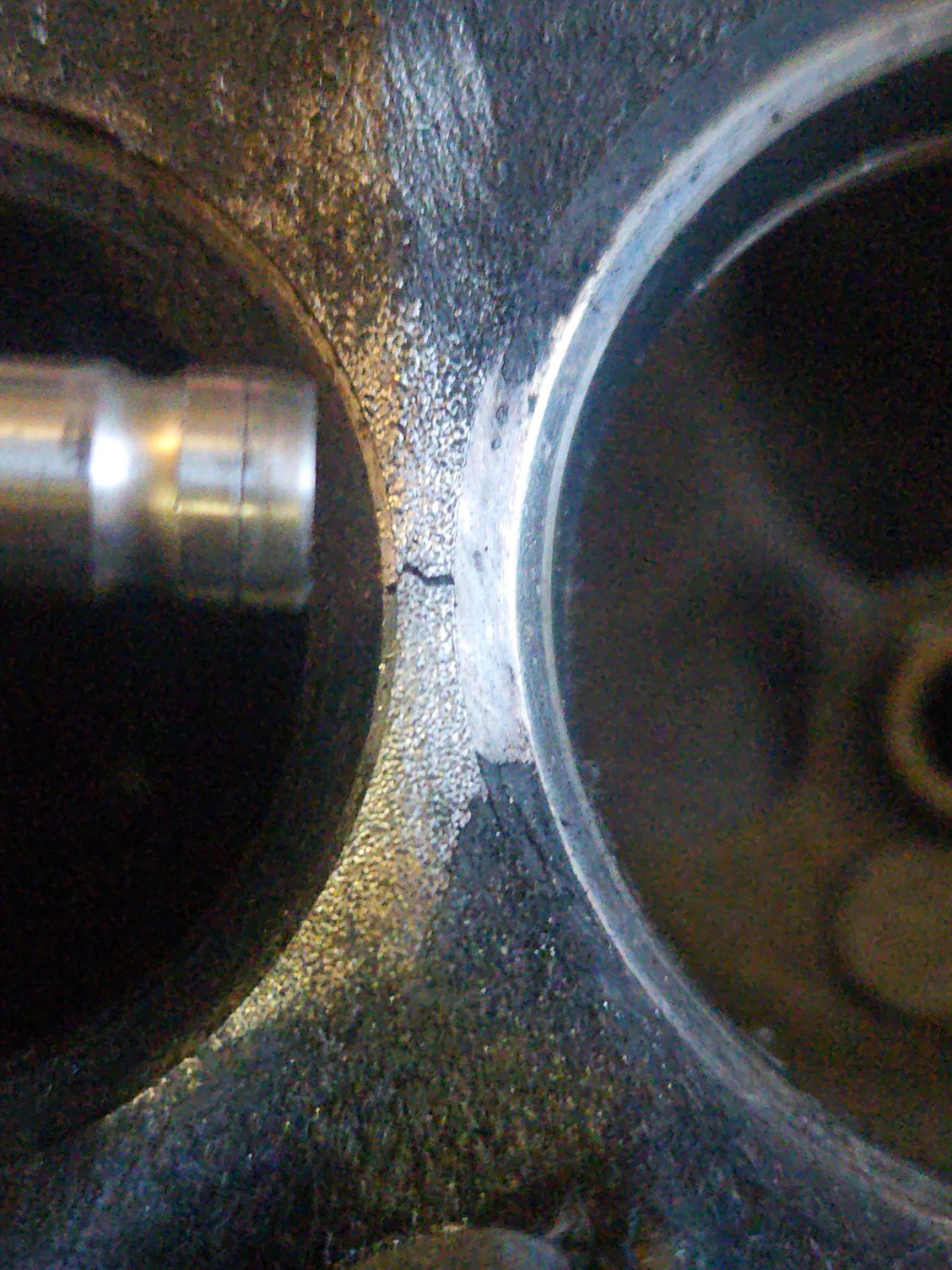

On another note, I started looking into my cylinder heads and all the exhaust valves were leaking, some worse than others. I started pulling the #7 cylinder valves out and upon doing so I found the valve seal was pushed up on the exhaust valve and was floating on the valve stem. Secondly I starting cleaning the surface to start lapping when I found a Crack between the exhaust and intake port.
Now ill be sending my spare set of cylinder heads out to be resurfaced and checked over.

Is that a crack in the top photo?
It sure is!

If that valve seal was off and that cylinder was sucking oil in past the valve, that could cause detonation.
