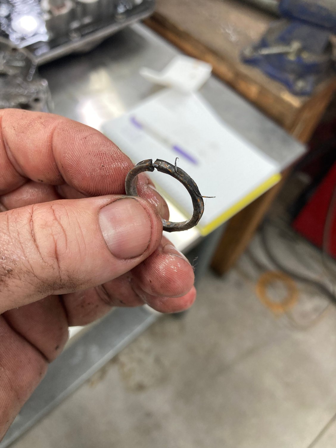

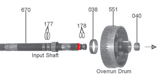

so i finally got the trans out and got it partway torn down and i think i found out why it ate the converter clutch.
one of the teflon sealing rings on the input shaft was folded over and probably leaked. its the red one in the picture.
Old Nov 3, 2021 | 03:37 PM
truckdoug's Avatar
Joined: Nov 2013
Posts: 6,389
Likes: 558
From: Portlandia
that'll do it
