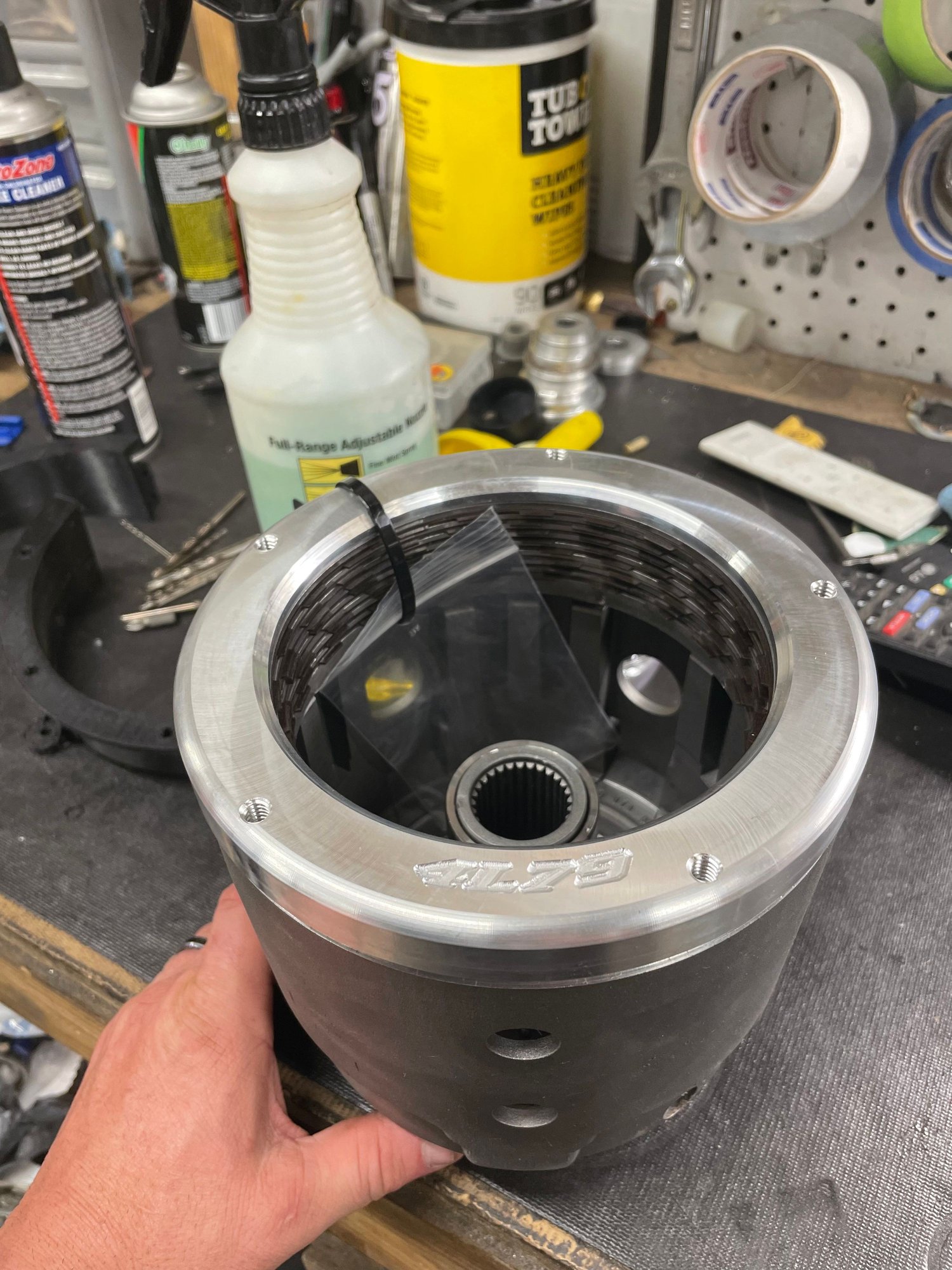

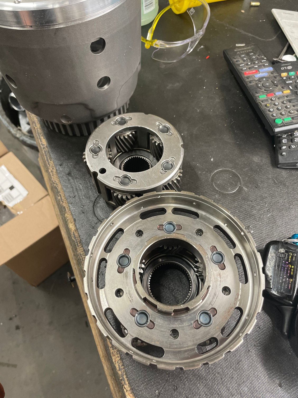

yes, billet input, output, reaction shaft, 4l79 drum.
truck is a full weight, 1500 extra cab. 3.42 gears with a sticky 33” tire on heavy stock 20” wheels. It dead hooks. He did the suspension, has a 12 bolt aftermarket rear end, e85 and a 78mm precision turbo. It went 11.70 @ 122 mph on its first outing, leaving very soft. 2.0 60ft iirc. He’s turned it up since, The truck is easily a 10 second full weight truck. I drove it, it’s making some steam.
You did the customer a disservice by selling him the wrong transmission for his application. 5 pinions isn't going to fix it.

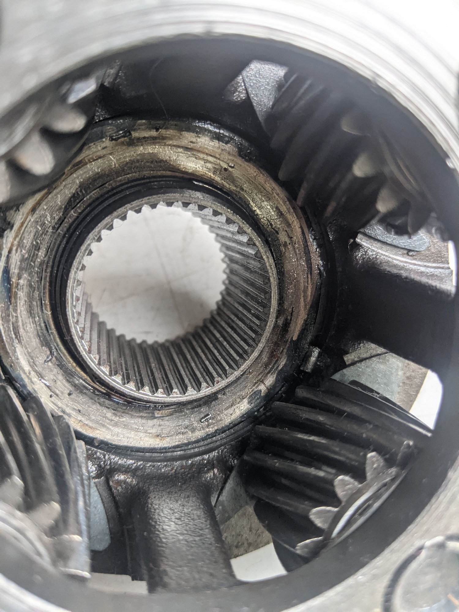

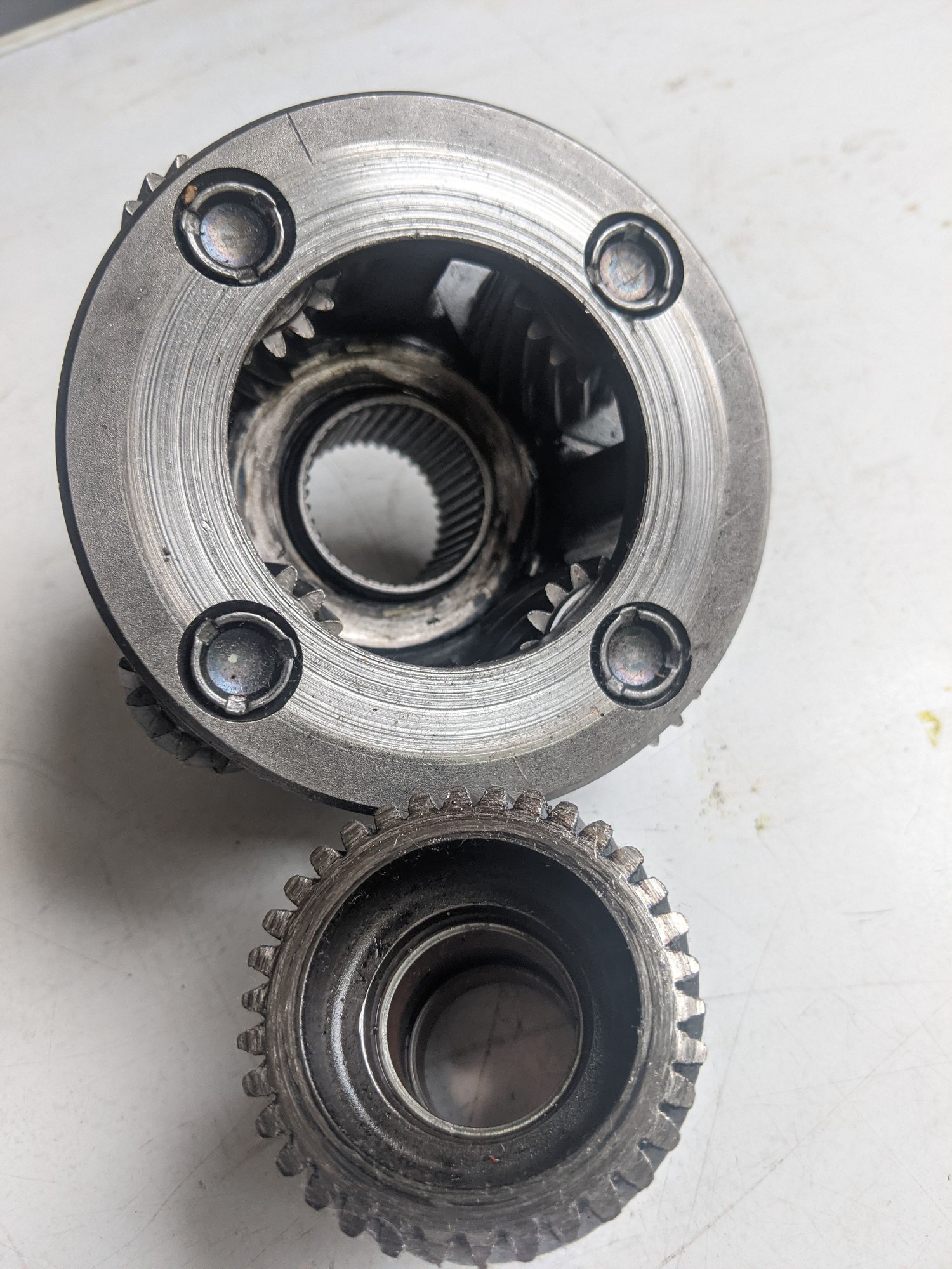

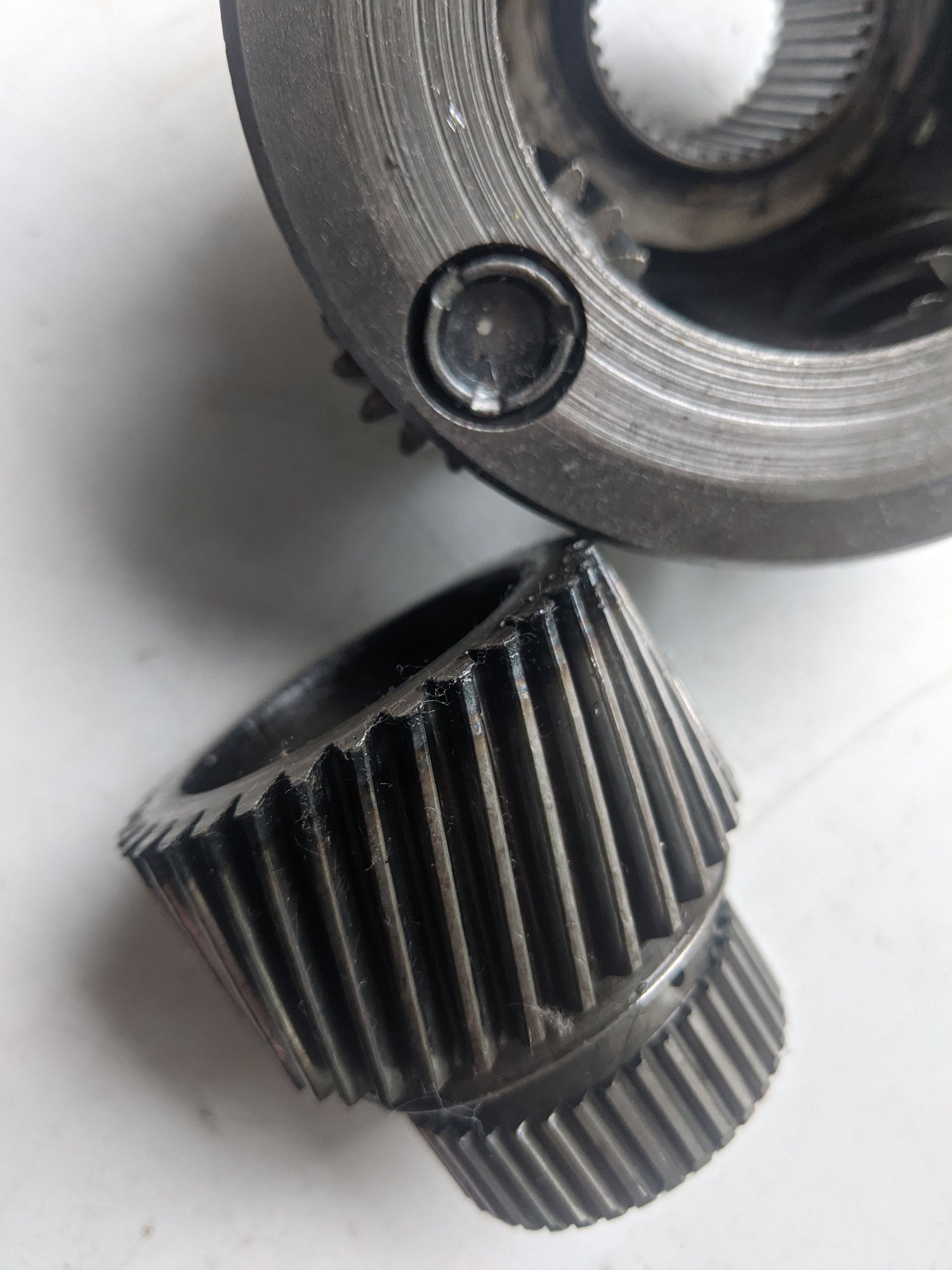

Check out this little guy
It was still driving around and shifting all right when the fluid was cold before we took it apart haha
This had to be chiseled apart when we tore it down however the only symptoms the trans exhibited before it was torn down was that it would slip in all ranges when it was hot I figured because the disintegrated bearing hurt the soft stuff
I've had my 4060E gone through several times and this most recent planetary lasted more than 7 years, some nights at the track getting hot lapped dozens of times though I feel like I was being somewhat mechanically sympathetic. I was certainly meaner to it on the street then the track probably. Needless to say the trans saw hundreds of second gear burnouts drawn far out of the water box after what seemed like hours in hopes of heating my nitto drag radials enough to hook my car.
I never noticed the planetary actually fail because it held together in my case, The transmission just began slipping when it was hot
I chose to keep a four pinion in my new 4L60e rebuild, basically all new setup front to rear but I'm certainly going to push its durability even further this time as I plan to shift it 7k to 7.5k and I also switched from nitto's 555's to Hoosier Dr2, and upgraded my rear gear from 3.73 to 4.10. I think the gratuitous burnouts required by the nittos to heat them is what did in my trans in over the years so while the 26" Hoosiers and 4.10 May sound crazy to you my reasoning is that I won't need to do nearly as awful of a burnout to get the Hoosiers where they need to be and so the whole thing should go quicker and be just as reliable and Did I mention I also replaced the 5.7 in front of the broke planetary with a 6.0 lol that poor little planetary it's amazing that they stay together at stock power levels let alone when us idiots are trying to get some performance out of them Good luck everybody.

The captured Torrinton-Bearings of the Planets are very often overlooked by DIY Builders...
and it is not like a DIY Builder can replace the bearing on their own.
It is common to see those Torrington-Bearings go...
especially now that they are getting quite old.
Always inspect those Bearings, as well as the Pinion-Gears for any rocking/ wobble...
and End-Play.
Many, many of those planets will now how quite a bit of Pinion-Gear End-Play (and can be reconditioned to go back into service).

factory has an oil squirter for the rear already. I've covered how to supply it with more lube oil via a simple accumulator mod.
I think @stockA4 has shown @Kfxguy exactly what I've been saying for a long time.
Lube, and the failure of the torrington bearings is the most common failure of a planet in the 4l60e. bar none.
2nd place is lack of lube that will end up wearing out the pinion gears.
this is simply not a failure point for anyone due to HP
-lube
-unnecessary shock induced by the builder or conditions outside of the trans (diff break, u join issue, bad wheel hop, etc)
if the 4 pinion lives...the 5 pinion will too...if the 5 pinion lives...the 4 pinion will too
