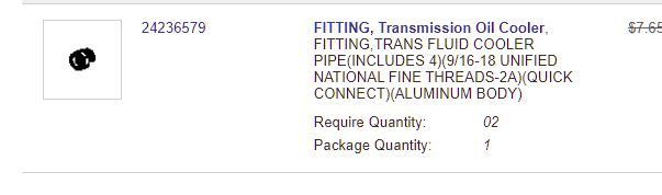

So I take that date to fall to be a 2008, so I searched using a 2008 Trailblazer SS AWD and it didn't show anything. Then I changed the vehicle to a Trailblazer 2WD and got this:
So whatever the 2008 Trailblazer 2WD except SS called it, (must be a M30/60E), it is different than the 2004 XUV aluminum 5.3L and the 2007 Silverado/Sierra 1500 Classic 5.3L (7KCD, my core)... 2008 says it's a 9/16-18 UNF! So it must be a wholesale 2008 year change, both 4l60e and 4l80e...

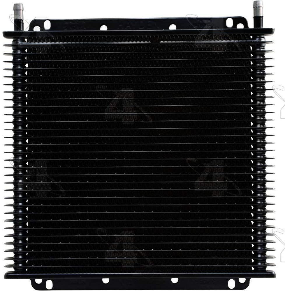

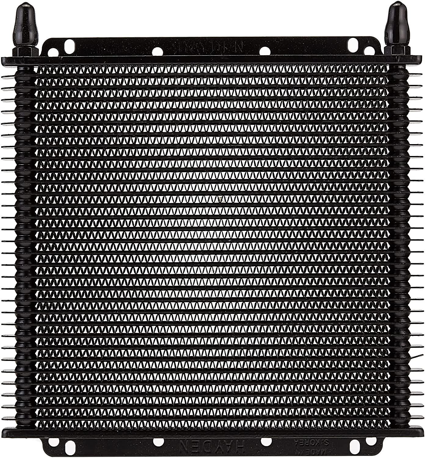

Thanks tayto, but I don't have $260-($280 w/tax) to spend on a cooler. My choices are the Hayden 699 w/built-in bypass thermostat for around $60, the Hayden 689 (no built-in thermostat but has 6AN male ports), or the Tru-Cool 40,000GVW LPD47391 oem for around $70.
Hayden 699:
Hayden 689:
LPD47391:
LPD47391 oem
I'd be happier if I could find a combination of all 3--
The built-in thermostat bypass of the 699, plus
threaded ports of the 689 (male 6AN), or
female threaded ports of the 47391.

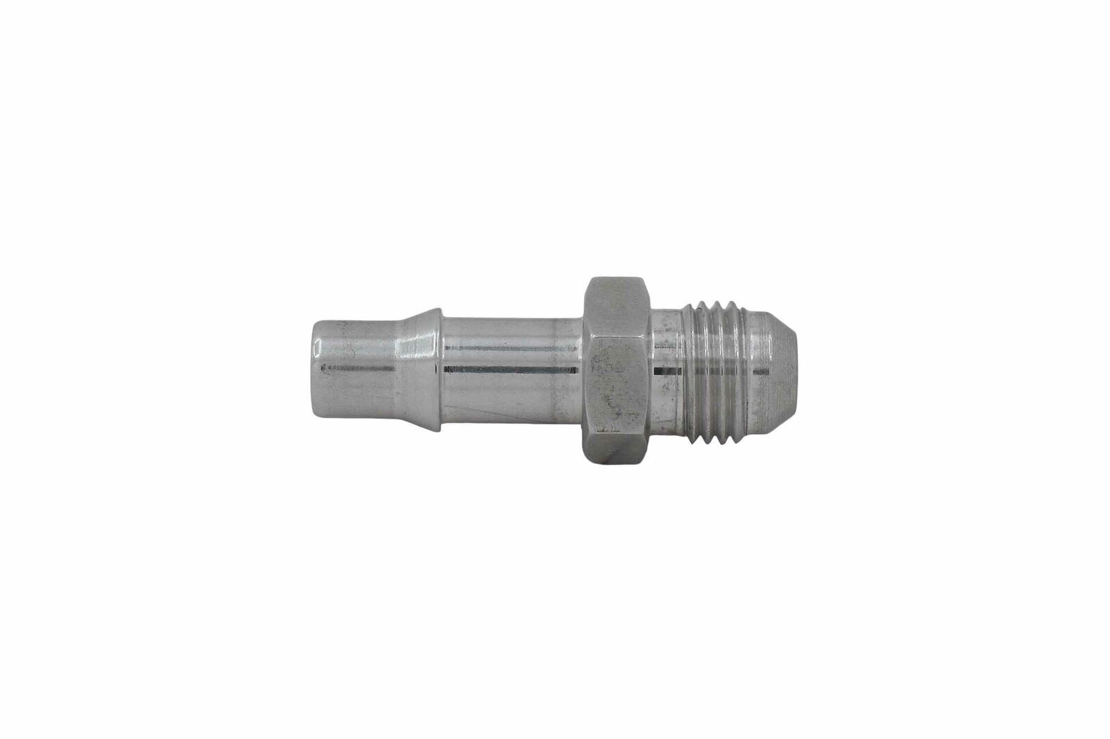

Also, I ordered the 6AN 1/4"-18 NPS fittings for $7pr.
I already bought new AC Delco steel lines last year, all 4. I think it'll be easier installing AN lines straight to a remote cooler unless I can get the steel lines in to stop the leak and blow out the radiator cooler. I don't know how much of the stock lines are salvageable to run a compression fitting and bypass the leaky section to get to run around in 2nd gear to pick up the converter and other parts to get a DMV inspection...
