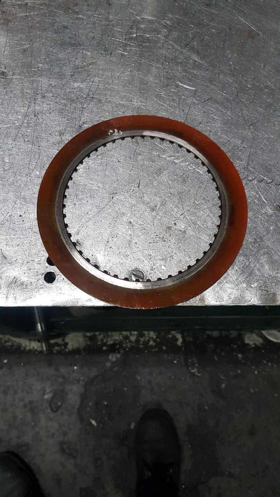

Hello!
I've known that 4L80e s are bulletproof, so that's why I'm asking, why it failed? Recommendations? What should I get?
How much I'd used it:
Just a couple of drag races and normal street use.
The failure:
The 16 element sprag is turning to all sides. Just 2 intermediate clutch packs are wiped out (not burned). Direct is a little bit blackened.
The combo:
Precision industries 3700rpm converter
Jakes D3 auto transbrake (launching at 3400 on the transbrake and 2 step just with 3 pounds of boost)
junkyard freshened 4L80e, that previously I had a transgo shift kit on it
Turbo junkyard sloppy 5.3 LS (75mm vs racing, just a baby summit cam 228ish and the normal supporting mods)
Stock 99 camaro ECU
the wiped out
the normal burned direct
Thanks!

Stock 4L80E Transmissions are not "Bullet-Proof" by a long shot!
Especially when using the Early Intermediate Sprag.
The Later 4L80E 34-Element Intermediate Sprag is a great upgrade!
Also, the 1-2 Shift should never be made overly harsh for this Transmission.
It will be hard on the Intermediate Sprag.
Higher Power Units should go to the 36-Element 4T80E Sprag (Direct Drum must be modified).
Good luck!
P.S. Throw out all the TransGo Junk for this Transmission ...you would have been much better off just using a Kit from Jake's.

By the way, how can you take care of the sprag while doing burnouts and 1-2 shifts?
Old Mar 13, 2022 | 02:42 PM
truckdoug's Avatar
Joined: Nov 2013
Posts: 6,389
Likes: 558
From: Portlandia
shift 1-2 in the water box and as you go into 3rd, roll out of water box
or if you are full manual just do a 2-3 burnout.
the 34 element sprag can go a long way if you keep the RPM in check
